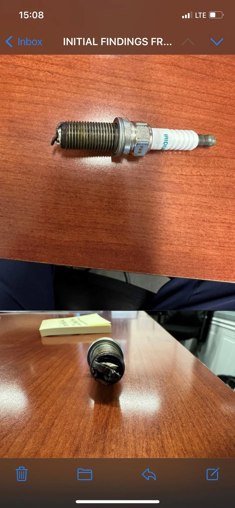

So...I was hoping this would be install a new battery and off I go. I just got a call from Teton Toyota. New battery installed. It starts...then sputters and dies. It will not run. A few attempts were made and it will not run. It just dies after a few seconds. They are concerned about the bottom end as the (master) tech said it was knocking. I've never had a knock...never. Nothing symptomatic of an issue with the bottom end. This is so weird. We're going to drain the oil and look for debris. If no debris, compression test. I'm a bit gutted right now. I'm hoping oil is clean and compression is fine (obviously). This just doesn't seem right. It has not thrown any codes since the initial P0335.
Damaged plug in Cylinder 7. Something came into contact with the plug/cylinder head. I’m trying to digest this and am at a loss right now.
