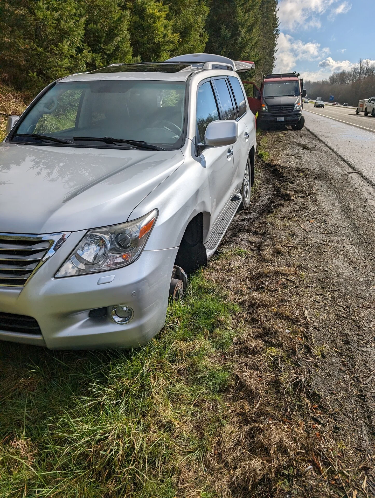

Different thread where a truck was totalled when a wheel came off. Truck went to auction but will probably net 25k+.
So yes I think you could get 15-20k with a blown motor if you ship it to car-part or whoever. @kcjaz might have some ideas for you there as he auctioned his wrecked rig (different thread) which had a good motor but not much else.
