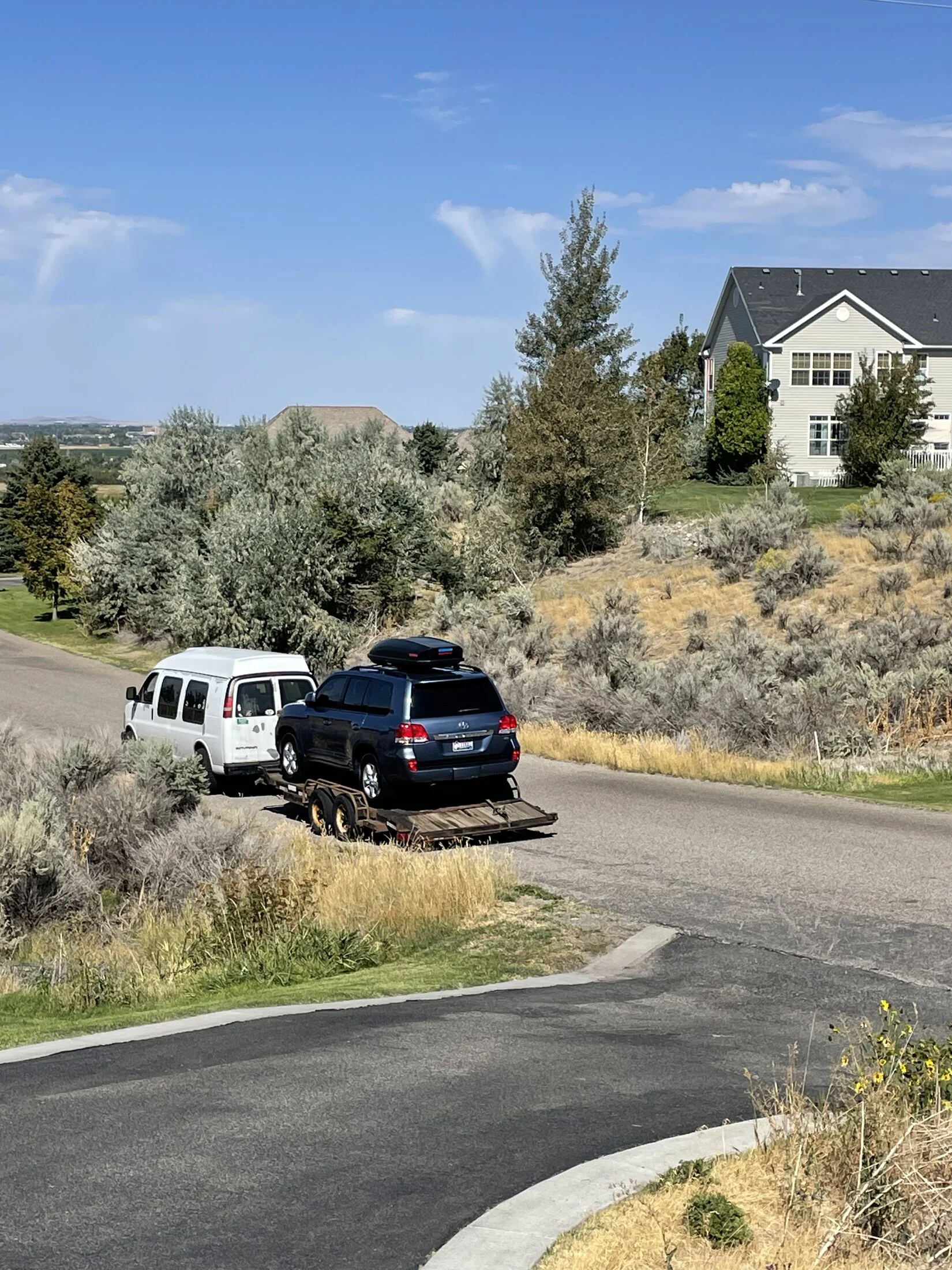

Jake (of ARDOffroad) came to the house today. Picked up the old girl. The donor engine should arrive at the shop tomorrow. Donor is out of an LX570 with 70k miles. They’ll do their due diligence and if the donor checks out, we’re hoping she’s back on the road in a few weeks. I can’t wait. I’ll keep this updated as things progress. Cheers.
