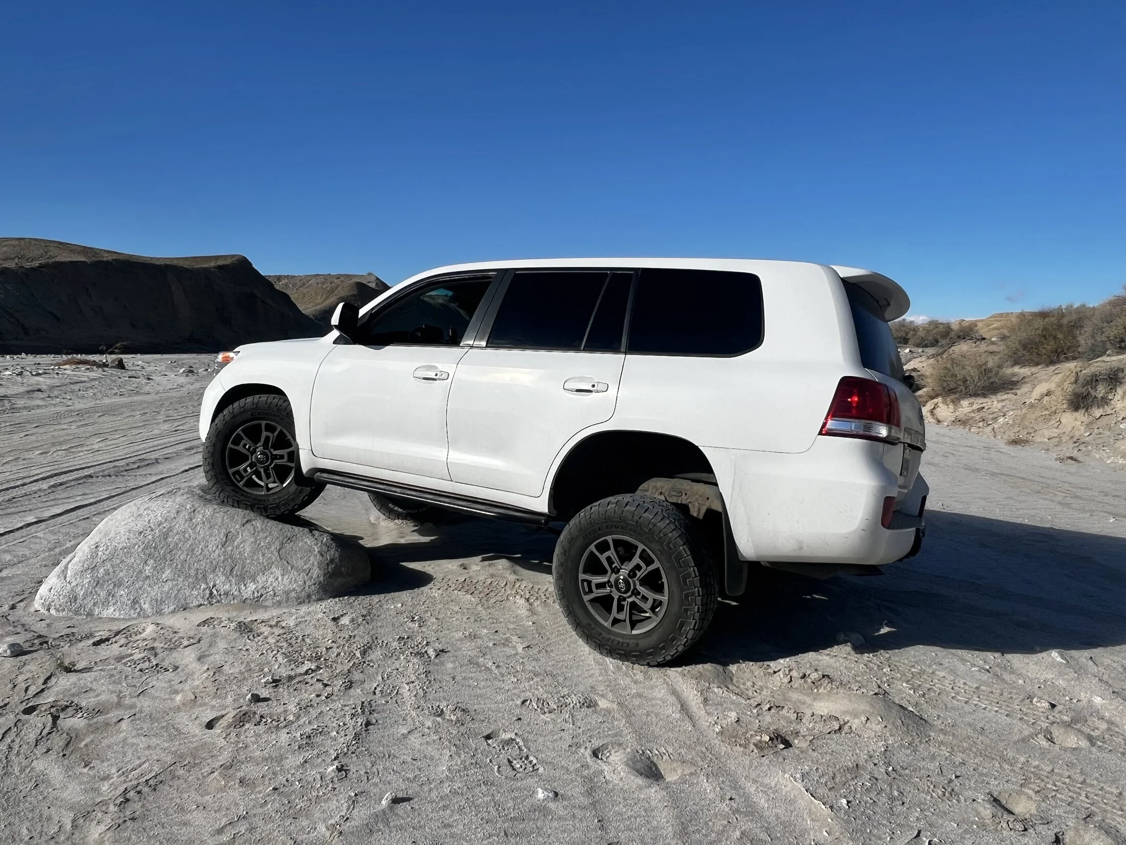

Climbed up with ease in 4H, no center diff lock. Tundra definitely needed 4wd and skinny pedal magic

Anyone that’s been to Ocotillo has played on the spiney medium pack rollers. This is where atrac impressed the hell out of me and the truck just goes, very little, if any slip, and articulates and conforms like a pretzel. Minimal effort was needed, and we had a blast doing this for a couple hours.
ARTICULATION:
Super happy and impressed, zero rub

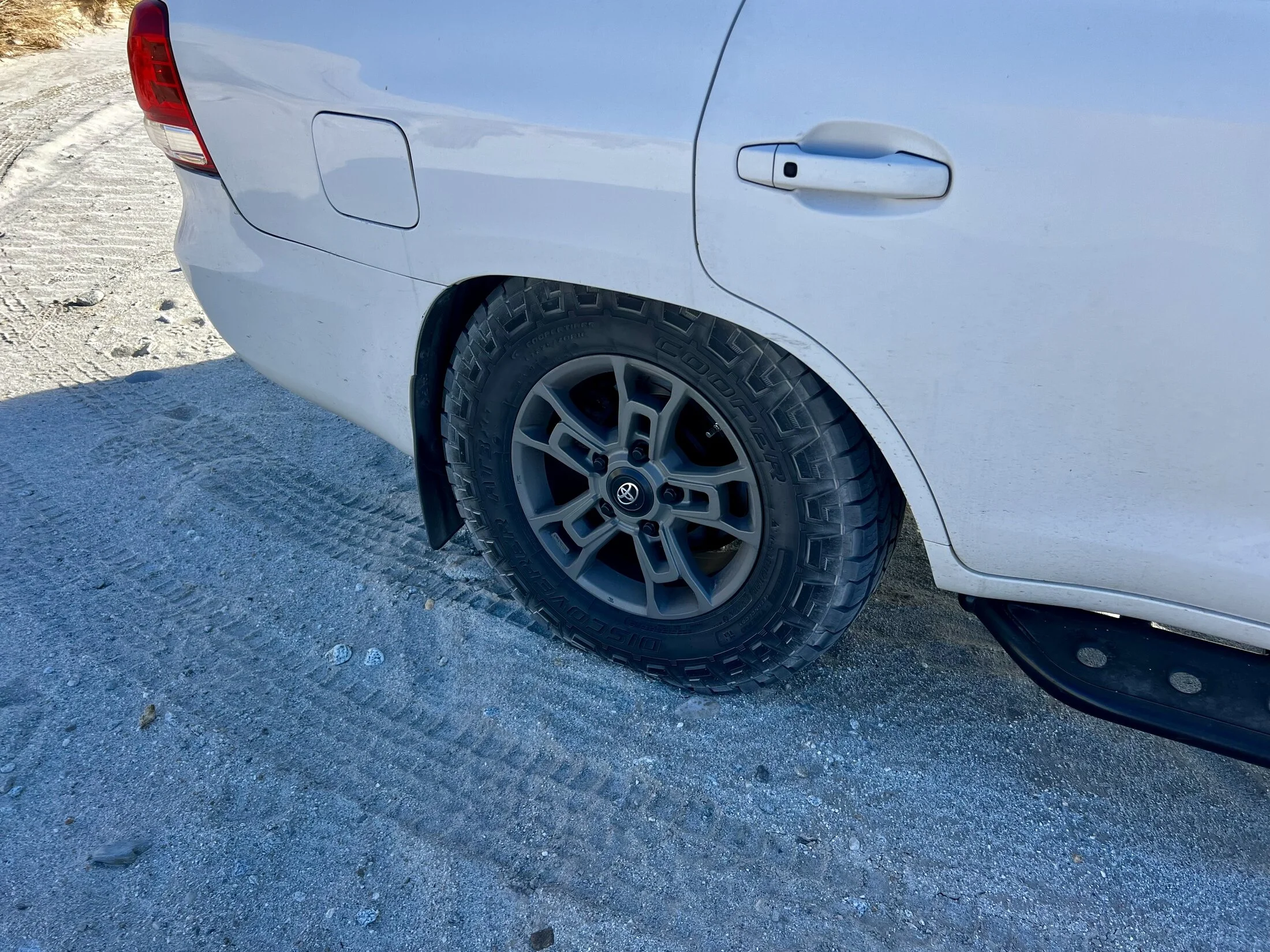

I did notice that at 25psi, the coopers still showed almost no sidewall flex
I can easily test this right down the road from me at the entrance to Marian Bear, (3/4 mile strip of "fish creek like washboard") and likely to run into @dudemancool1904 :)
If airing down the E rated Coopers down below 20 makes that much of a difference, i would likely swap them out to the C rated G3s and then go from there for the rest of the dialing it.
