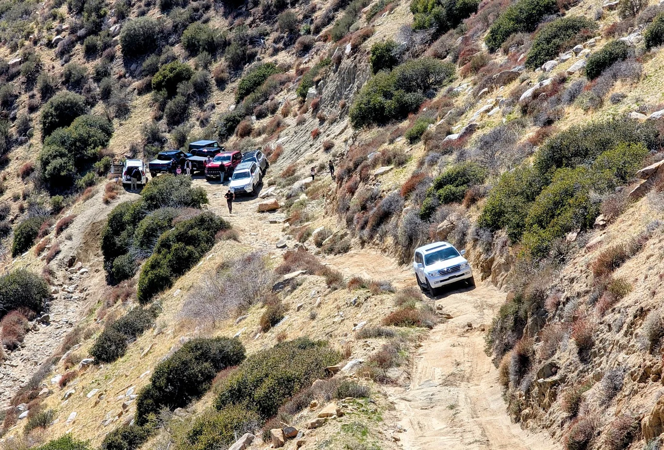

Don't want to incriminate anyone either so I'll anonymously post a picture. :)
