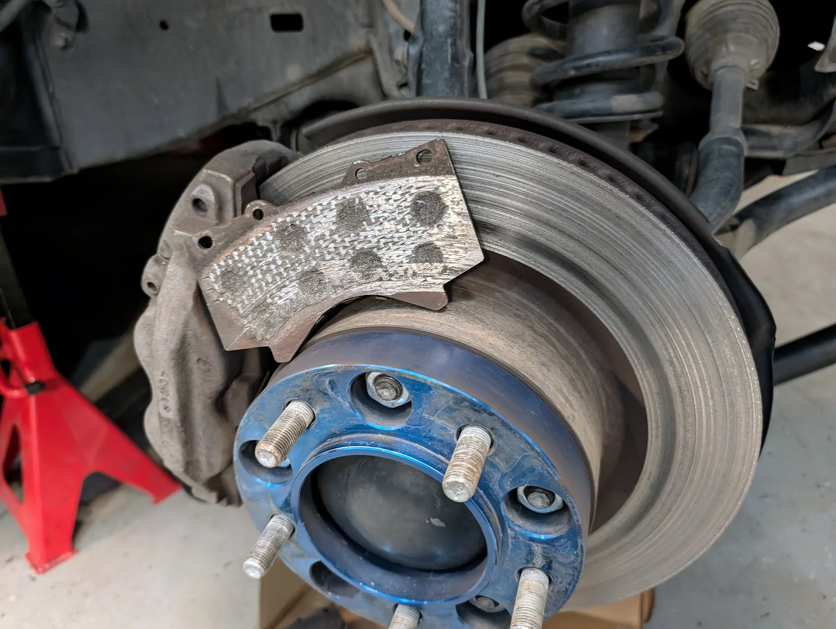

I'm going to chime in a bit on the need for upgraded brakes topic. I fully realize this is not apples to apples but I don't think it's even close to necessary. On the Canguro Racing 200 we run stock Toyota calipers because we run RW wheels so we can run the tire size we want from BFG that only come in 17s. It's a non-boosted setup with 2 separate circuits and a manual bias adjustment. So definitely different than a stock 200 BUT, the caliper clamping force has never been an issue in the 10 years we've been racing it. As a matter of fact we had a failure in the bias rod a few years ago and the stock calipers actually stopped us from moving, totally locked up and the calipers didn't suffer at all from the heat. Even after our mid-race repair meant we ran glowing hot dragging rear rotors for the last 200 miles of the race. Proper rotors and pads I do think are imperative but no need to jump to a BBK. We ran Hawk for a couple of seasons and the last few we've been using Remmen. Oddly in our class in desert racing we opt for brake pads that have the most bite when cold rather than needing to heat up. We spend so much time being unable to go fast the brakes don't get used as much as you would think. When we raced the LX600 with the team from Japan they came over with brakes that were the exact opposite. In my time behind the wheel I had to drag the brake every now and then to keep heat in them so I didn't get caught off guard going into a corner with cold brakes. They upgraded to cold bite pads for the following races.
This is going to be use case and driver dependent. I agree BBKs may not be necessary, but OEM pads should be switched as they have a pretty low temp threshold (~500°F). They'll also fade concernly as temp builds.
Off-road, there is not the same traction and bite to really heat up brakes. Versus something like mountain switchbacks on-road.
I find Hawk LTS to be a huge upgrade over stock pads with significantly more bite and friction (even cold). Great modulation. With solid temperature handling up to the a full (~700°F), with confidence inspiring and strong friction deep into those temps.
I'm on upsized Tundra rotors and calipers (equivalent to 2016+ sizing) on my 2009 LX570. On stock power, I can burn up a set of Hawk LTS brakes pads in the mountains. At high temps, the pad material can get compromised where it'll start to disintegrate but will perform down to the last bit of pad. Upsizing and BBKs is not so much about clamping force but the larger rotor helps to dampen peak temps to make braking performance sustainable and repeatable.

100% agreed pads and rotors need to be upgraded and I love Hawk products. I have Remmen on my 200 because of the partnership. I'm not saying a BBK isn't a good investment but I don't think it's necessary.
