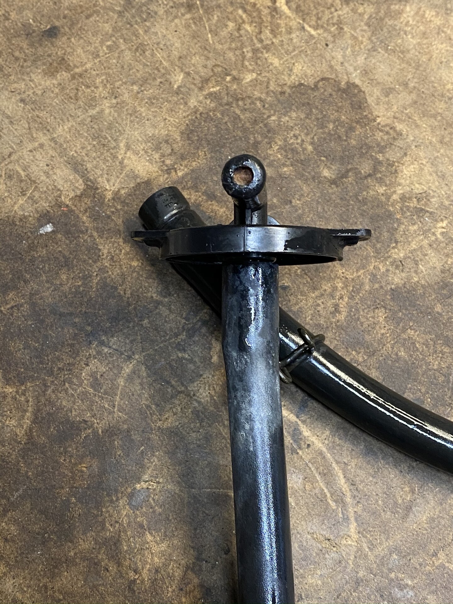

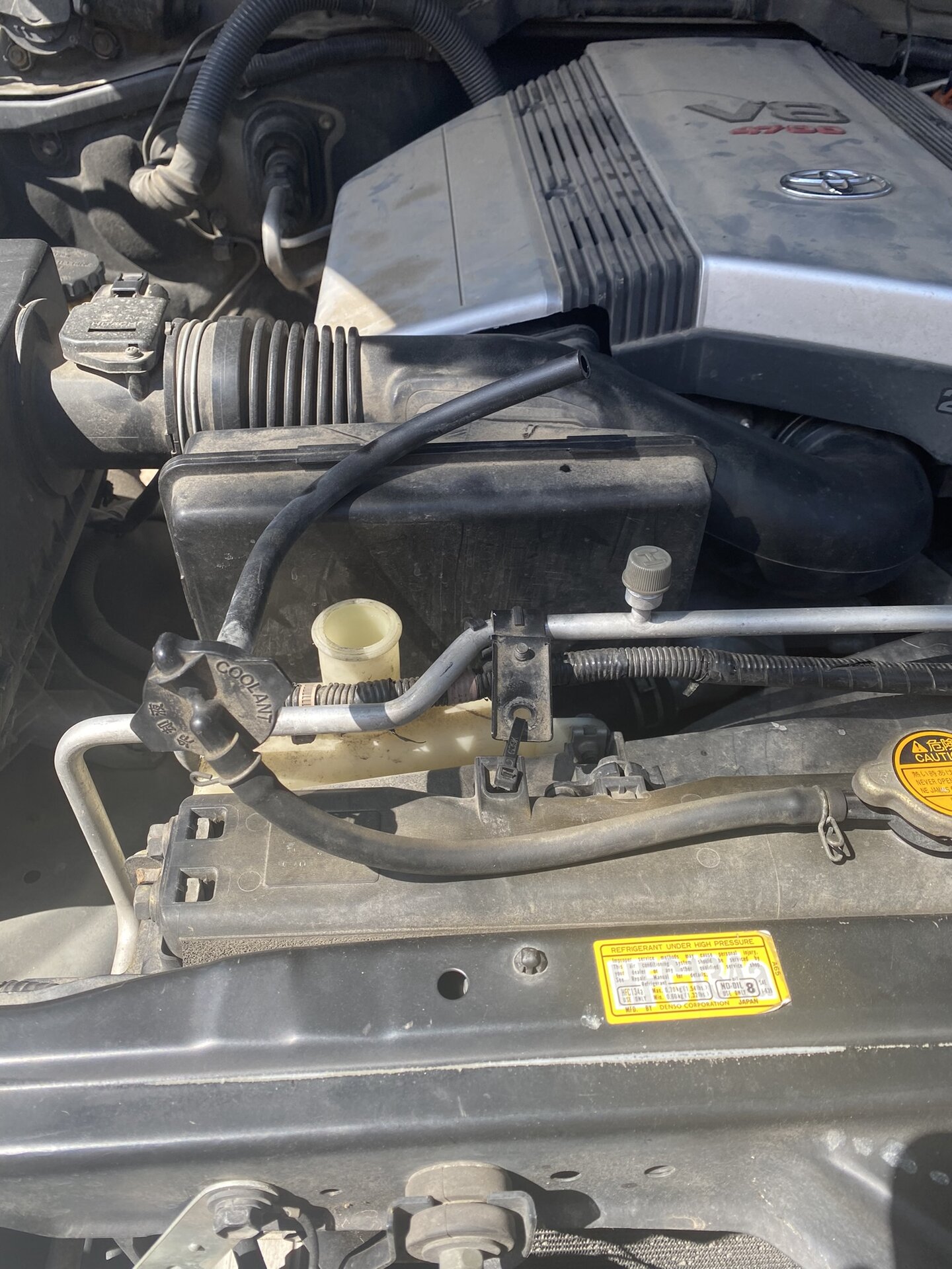

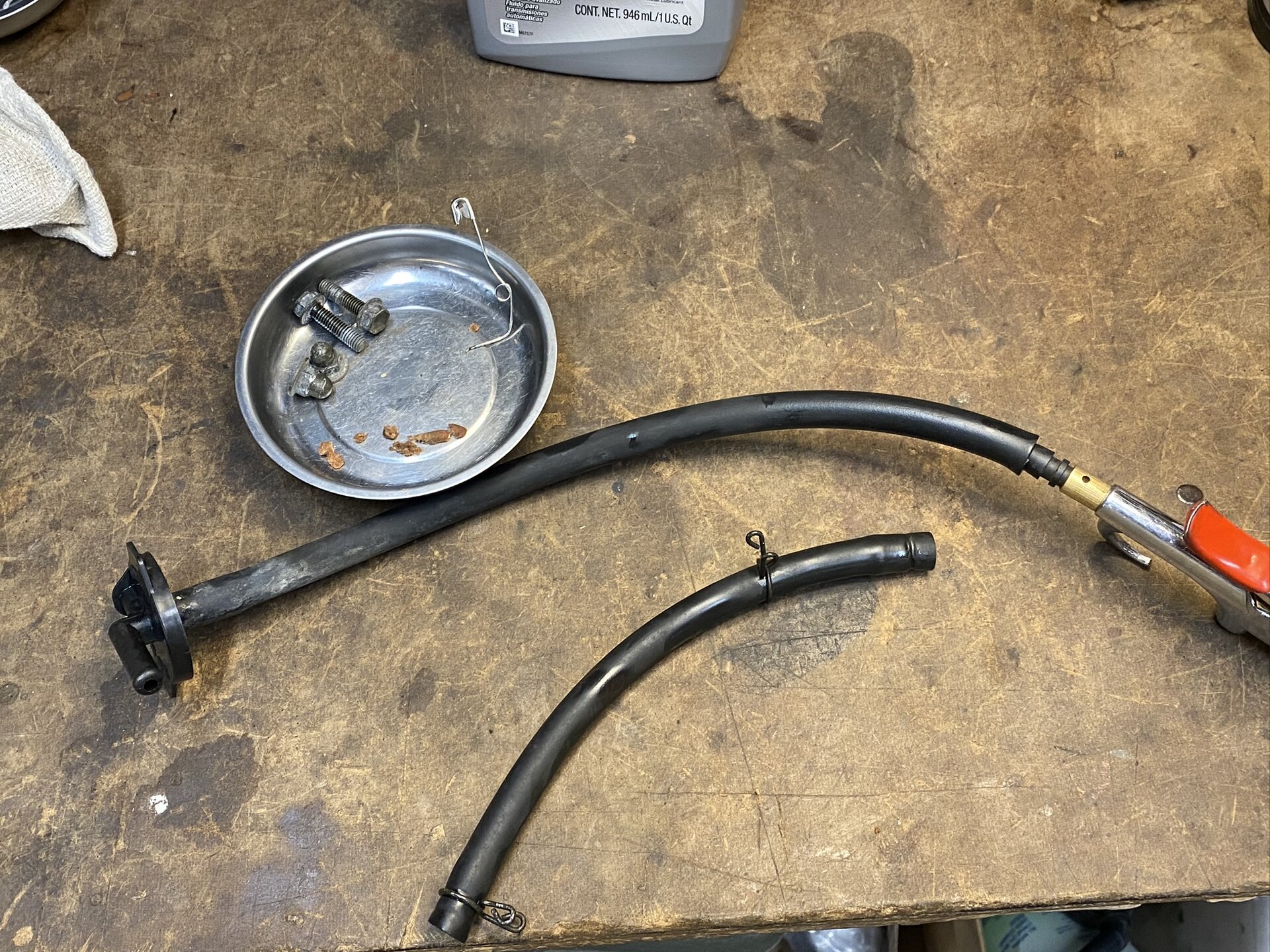

Just a few reservoir hose & cap pic. Not specific to OP issue.
Curled up res hose
Plugged res hose and cap.
Curled up res hose
