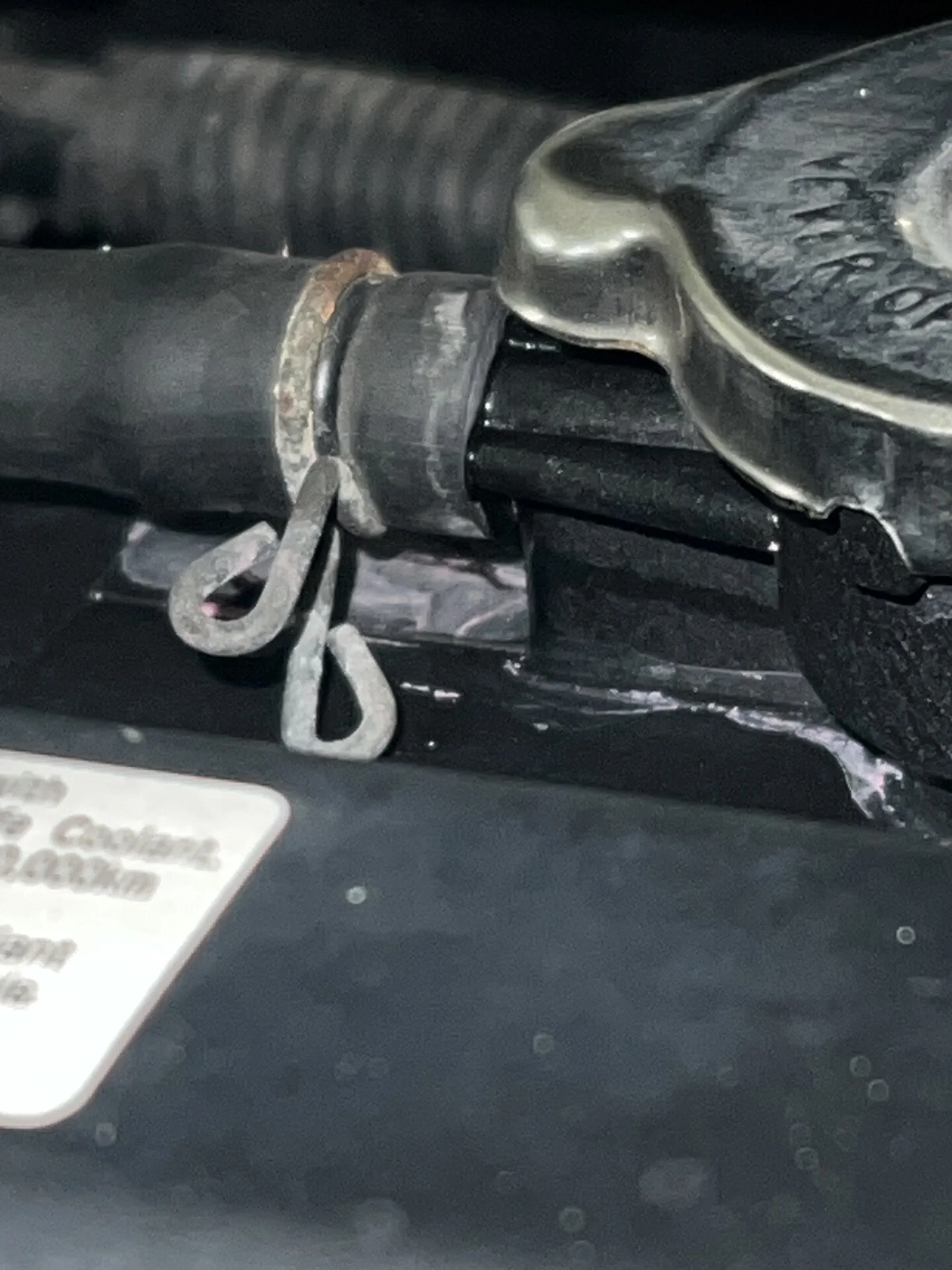

Hey guys, new owner of a 2007 LC here. I recently purchased this and have been going through and doing some maintenance.

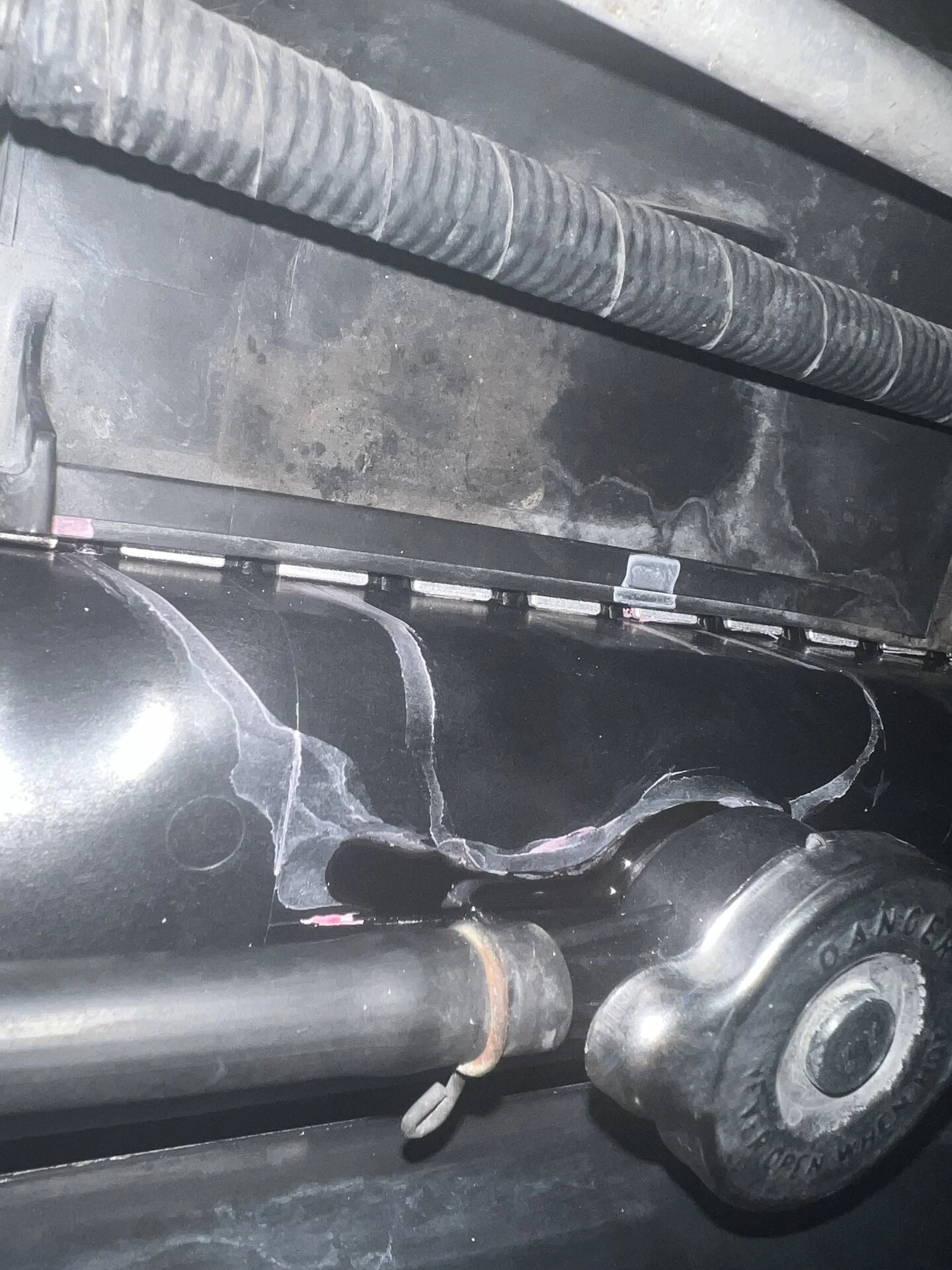

When I purchased it I noticed a coolant smeel inside the cabin, very faint and random but I took it to a shop they did a compression test and said the radiator needed to be replaced. That was done about 2 weeks ago. Recently I am getting the same coolant smell again. When I got home from a 30 minute store trip I took a look and could see coolant sitting on top of the radiator near the stem/cap. I then took it back to that same shop for them to take a look, they did another compression test and said all looked good and that the coolant resivour was possibly over-filled. Fine, I took it home and today during a short trip I smelled coolant again! I stop, open the hood and see coolant sitting in the place on top of the radiator (pictures attached). The PO had put an aftermarket radiator cap on while I dont think this is the issue since where the stem meets the cap looks dry I ordered a new OEM cap to just to test.
Looking a bit closer I can see some coolant coming out of where the hose connects to the radiator (third picture). Possibly the hose just isn't fully seated and is backing off?

After some more searching, it seems it could be coolant overfilled like the shop said. Although I find it a little strange it would just be purging now...

If that radiator is not a T.Rad from the dealer there is a good chance it failed. The cap looks aftermarket, too.

My 2006 did the same thing with both my original radiator and the new oem radiator. I too was concerned but I believe its a result of an old hose that isnt sealing perfectly where that little clamp is. Try a new hose and clamp if you can find a part number.
Yup I ordered a coolant reservoir tank cap/hose that comes next week. Will install it with the new radiator cap and hope these resolve it.
Pull off that hose at the radiator cap, cut 1/2” off of it, and put it back on.
When filling a new radiator, it often takes a few running cycles for all the air to settle out and for the overflow tank to normalize. Many times the overflow is filled up at a shop and this causes a bit of overflow. The purpose of that tank is so that when the engine cools and the fluid in the radiator shrinks, some fluid is sucked into the radiator from the tank. This looks like fluid going through the overflow hose that is not tight, as mentioned. Ive done two of these radiators and replaced others. It always takes a drive or two, even with proper burping on an uphill slope. Ive even had to do this after fancy vacuum bleeding on my German cars. keep cleaning the area and monitor. Its likely just the hose as mentioned.
Clean it up, top off fluid, and monitor it.
