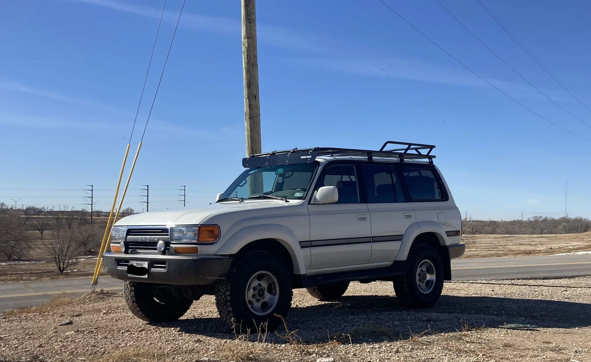

I am slowly putting a 4” Dobinson lift together (via Mud) in case I want to go taller but fully understand that it is a whole different ballgame as mentioned.
Here is how it sits:
^ same. I am happy with the 2” Ironman. I paid less than $900 shipped to my door. I wanted to fit larger tires. Good enough for my use. Cannot beat free shipping on top of 25% discount.
What size tires are those?
