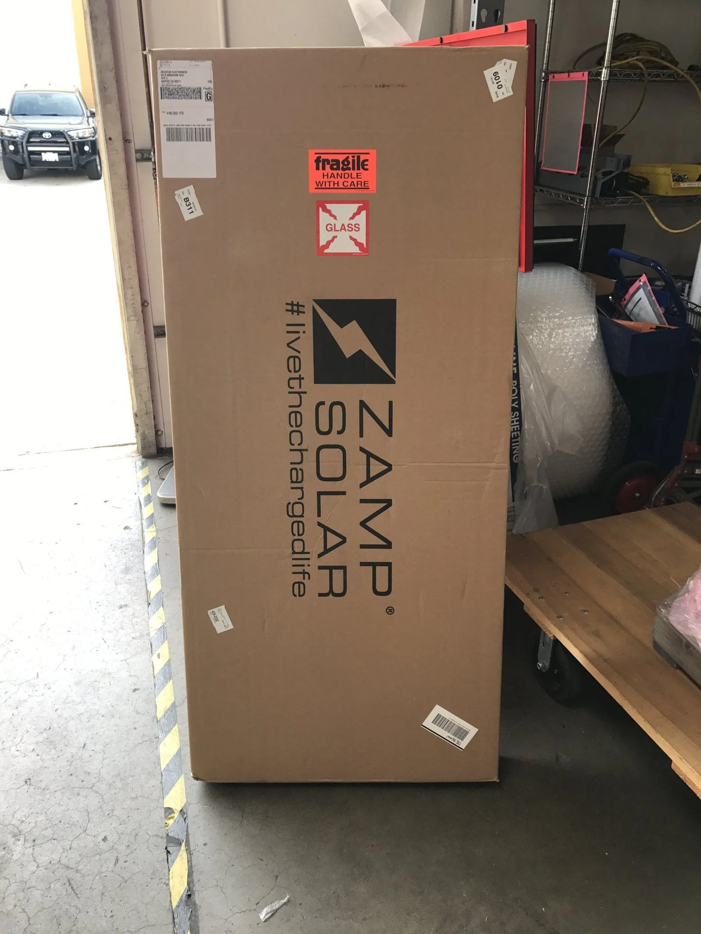

I've been toying with the idea of a DC-DC charger for a while too. Both the Redarc and CTEK have strengths and weaknesses but since I'm also planning on "permanently" mounting an 80 watt panel on the roof rack, the added feature of the DC-DC may not even have value to us. I'm really liking the idea of an MPPT controller with Bluetooth...
The D250S DUAL included with the 100A kit is an MPPT controller, but I'm still contemplating how much I need vs. how much I want...
Speaking of our 80watt panel, guess what showed up today :D
