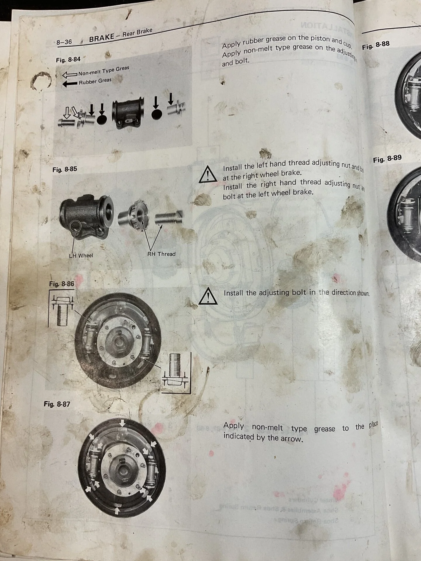

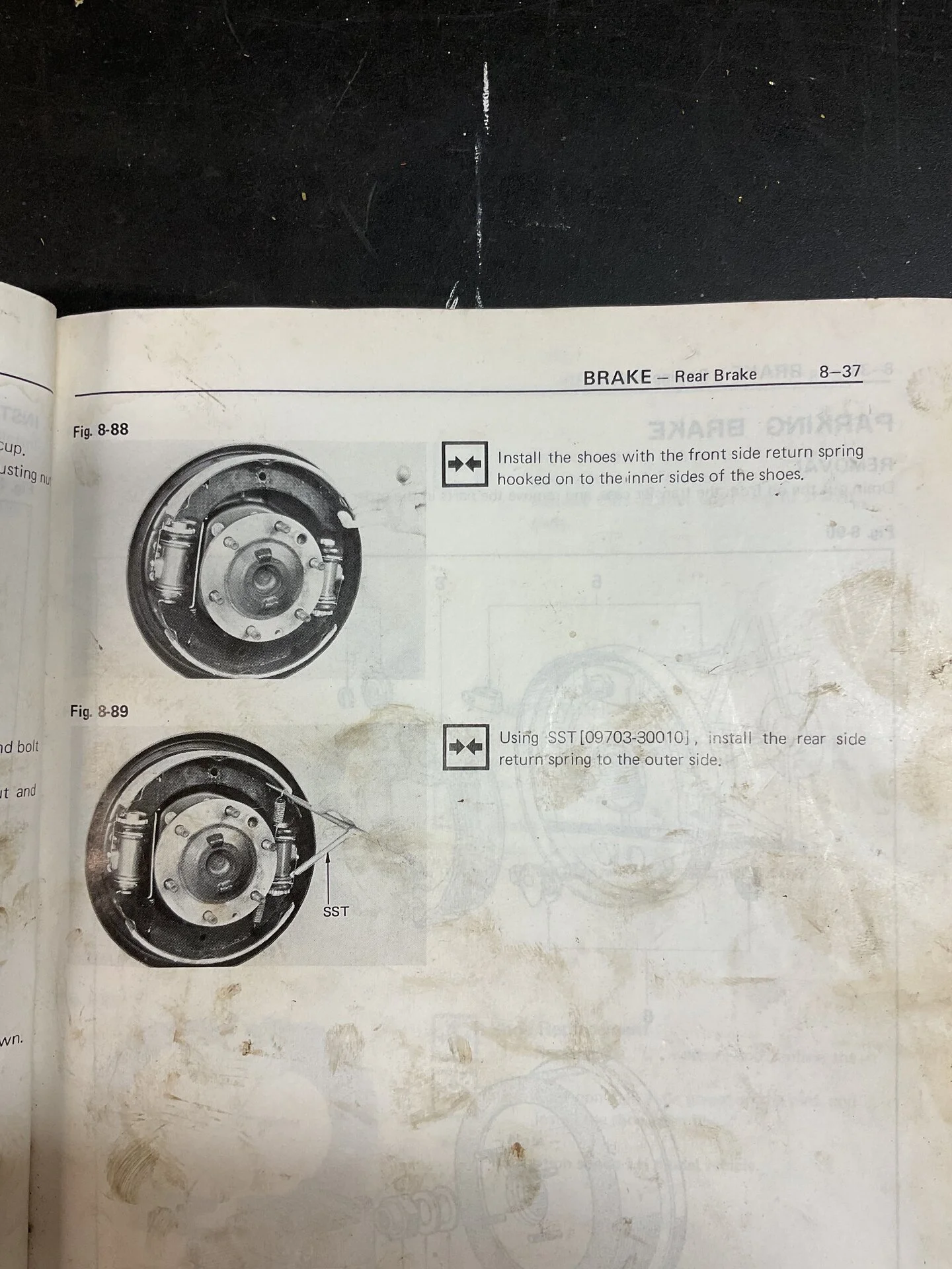

Do you still have the shoes you removed? See if the SOR set are wider. Another thought- use a Sharpie and ink the inside rim inner of the drums, test drive, see if and where the ink rubs off. Did you grease the backing plate where the shoes rub? Are the springs orientation correct? Rear springs to the outside.
i have the fsm as well.
i did not compare widths, but like i mentioned there is no funny wear happening out of place....still have the other shoes...it was a frozen cylinder adjuster driving the work and the shoes were a just because i was there thing.
