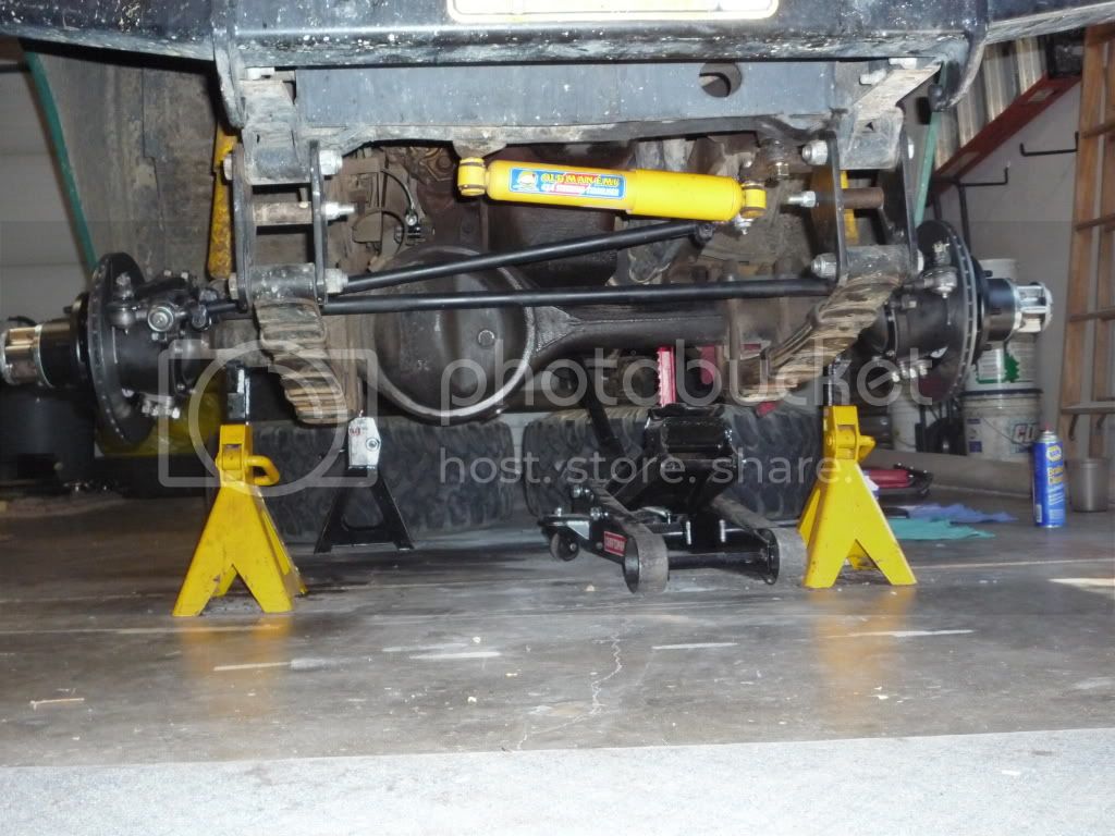

Mas pics...

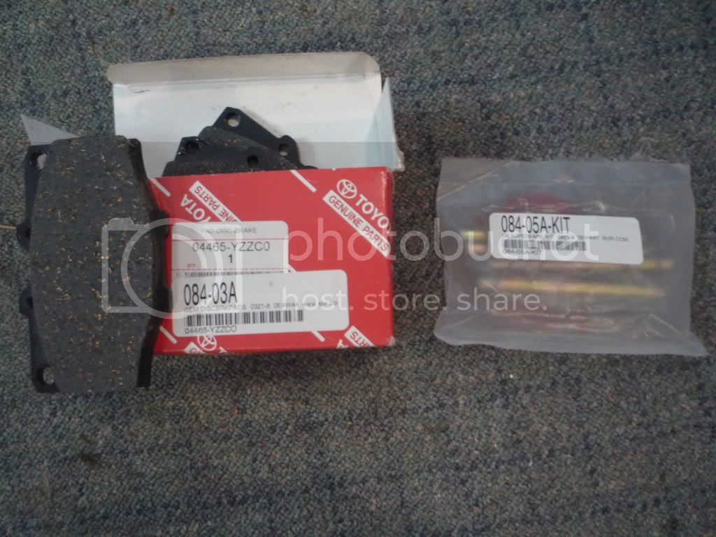

New brake pads and springs/pins

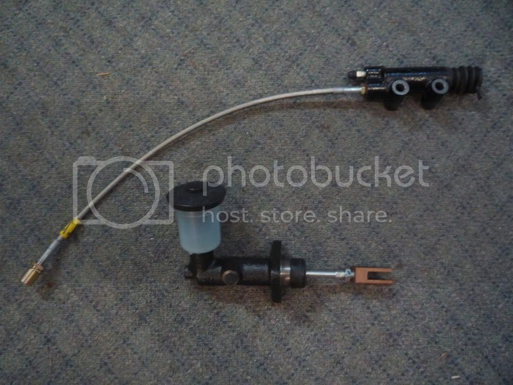

New clutch master/slave cylinders and SS braided line
Getting there. Need to bleed both brake and clutch systems. Waiting on new rotors.

Still had trouble getting the new pads into the old calipers. I was able to depress some of the pistons while the others were frozen. Time for new calipers.

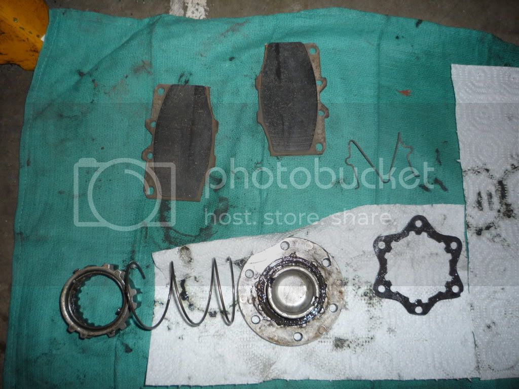

Installed the outer hub assembly on one of the axle sides. When I went to install the other, it fell apart in my hands. It was late, I was trying to finish up in time to make the Edison run and I spent the next few hours trying to figure out how to put the hub back together again.

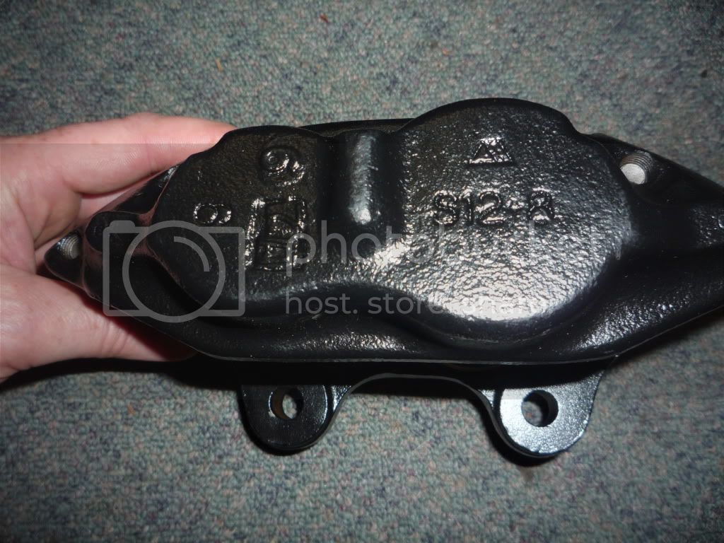

Decided to buy new calipers from NAPA to replace my old junk. Noticed I had uneven wear on the pads also. Figure probably due to one side of each caliper being stuck. Just a guess...
Finally loaded the new calipers with new pads, rods, and springs. Installed 'em. I have now rebuilt the entire front end; brakes, steering, axle, etc. Land Cruiser projects always seem to blossom this way...

Bleeding the brakes went well, but when I bled the clutch the clutch master went dry midway through bleeding. The pedal was loose, became tighter, and then went loose again. My understanding is this is no big deal. You just have to start over and re-bleed. However, the pedal is now loose and doesn't seem to get any tighter as you pump it. Did I screw something up, should I just keep pumping? What's going on?!
Agreed!
It always falls into the philosophy of "while I am in here, I may as well (fill in the blank)"
For bleeding the clutch master I think you can just crack open the bleeder on the slave and let the fluid gravity bleed.
Thanks PabloCruise! I did just that and gravity bled it. Works well now. Truck is back together and on the road. Steering is tighter. Brakes are decent, a little mushy maybe? Haven't been able to lock 'em up, but they stop the truck. :)
