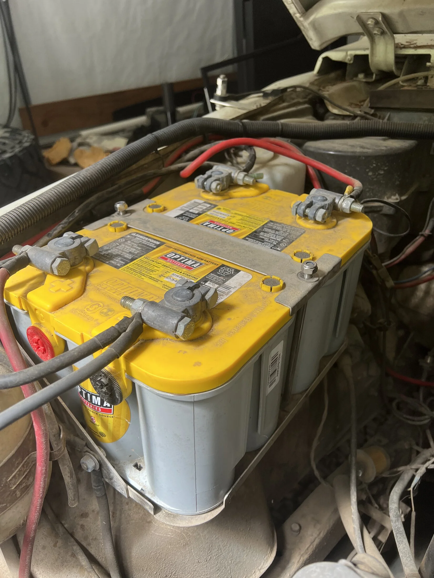

This past Father's Day I felt not-guilty enough about messing with my Cruiser. I knew my old batteries were shot, but I started there anyway. I confirmed both were dead, and figured I would need to purchase a pair of Optimas again- mainly because they fit my specific SS tray. I also tried to jump start the old pig with my Tacoma... and it sputtered to life momentarily. I had sprayed some engine start down the carb before trying to fire her up because I did not see any gas in the fuel filter or carb.
I had been nervous about the gas situation. This pig has been sitting for so long, and I have only driven it sporadically in years, that I couldn't remember if I had added fuel stabilizer more than once or twice or added more gas at some point, etc. I had tried starting it up a few times in the past, but it wouldn't always run for me. She was pissed at me and I don't blame her.
So, I figured I'd toss the Optimas at her first and start the healing process.

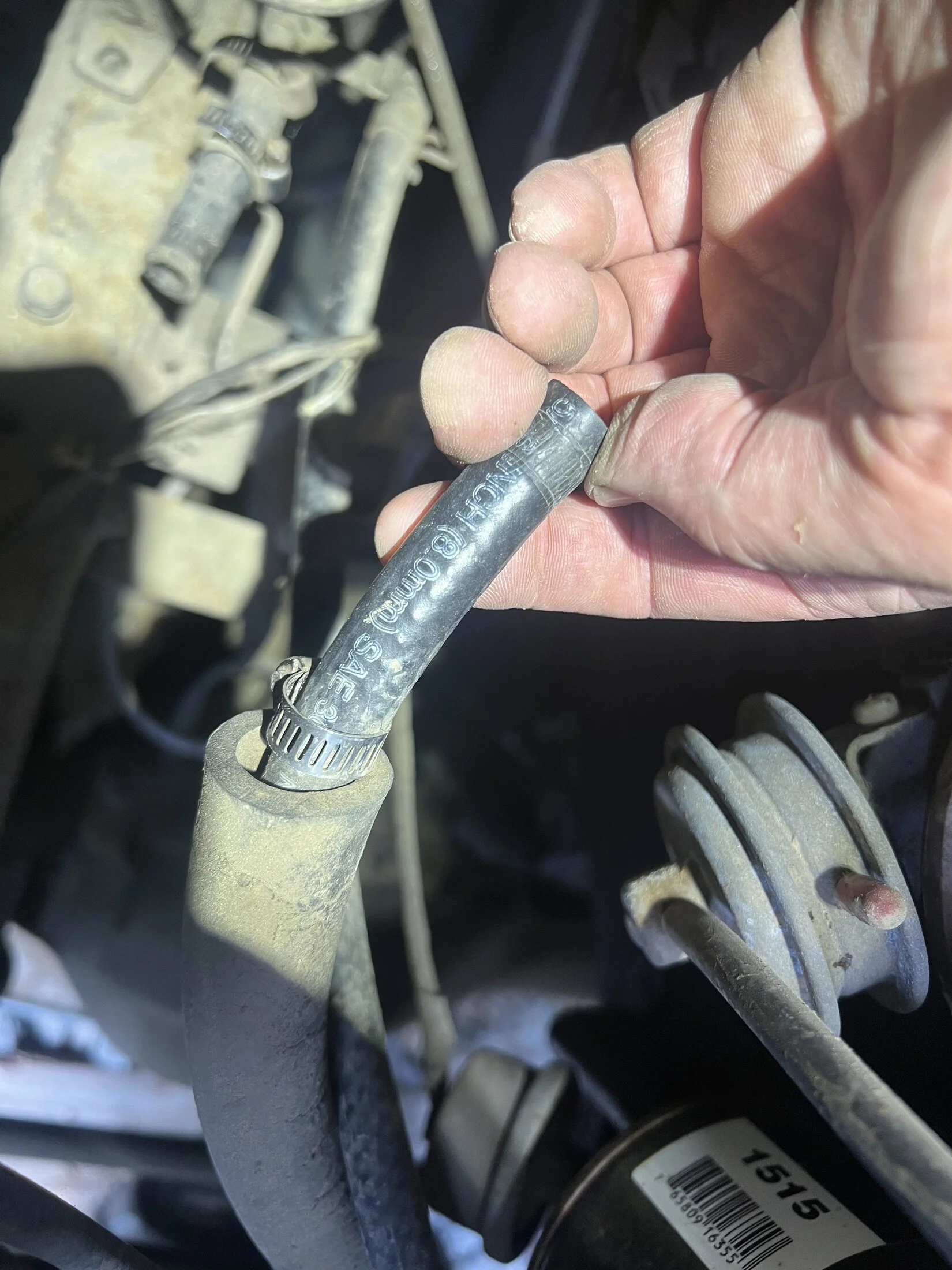

The new Optimas did what they're supposed to do, but I wasn't getting gas to the carb yet. I tried a few tricks to fix my fuel starvation issue. I replaced the fuel filter. I tried to start her numerous times using engine start, and eventually a little gas in the carb. She would stutter and run momentarily, and then die from lack of gas. I was confident she wanted to run, but just wasn't getting gas. I've had this same problem with pigs before. As everyone knows, it's a long way from the tank to the carb in a pig. I finally pulled the gas line off the carb and filled it with gas, and poured gas in the little venturis (?) in the carb and filled it to the sight dot. Turned the key and she fired up and ran well for a minute or two... until I found multiple gas line leaks and I shut her down.
So now that she's getting gas I know she runs well. I track down the gas line leaks and check my stash. I don't have what I need but a quick trip to town for gas line and I'm back in the game. I thought the gas leaks were from rodent chewing, but the gas lines I replaced were cracked and brittle. I replaced several lines...
