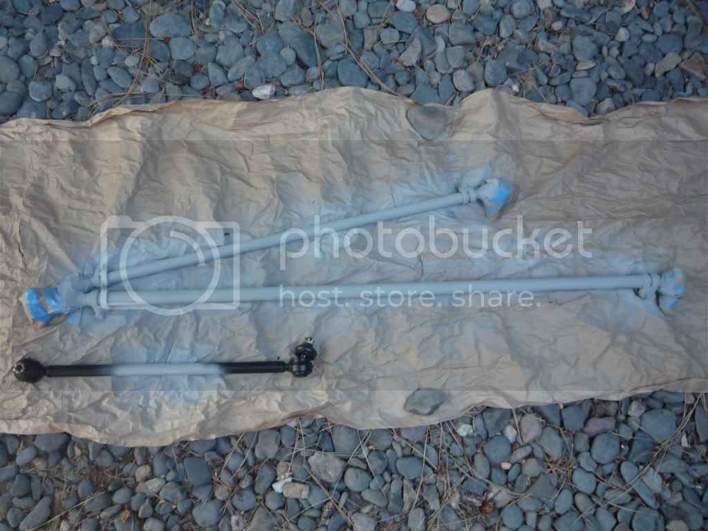

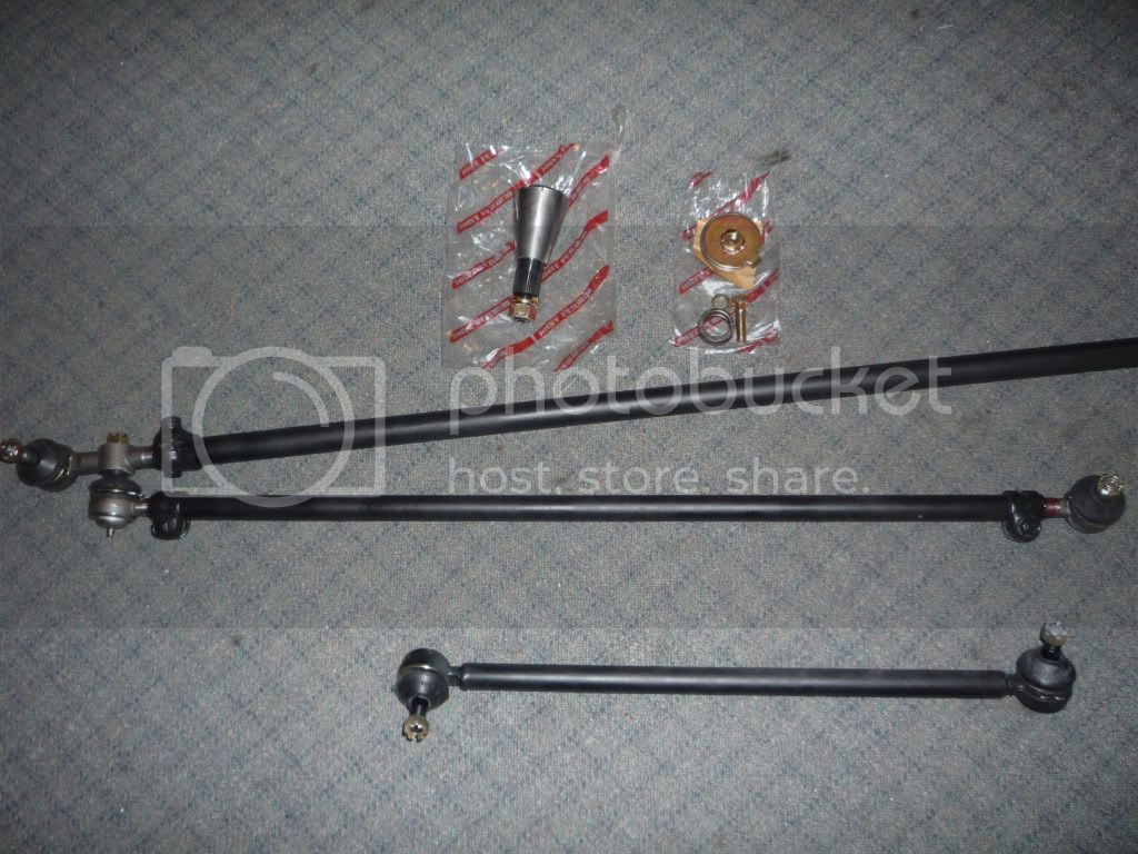

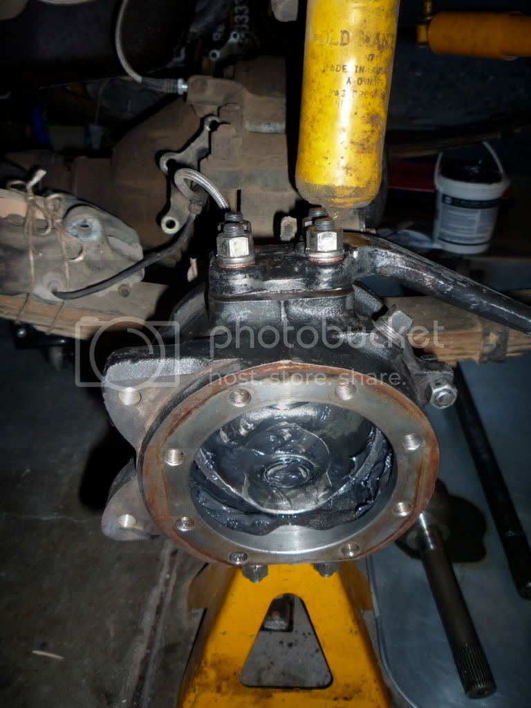

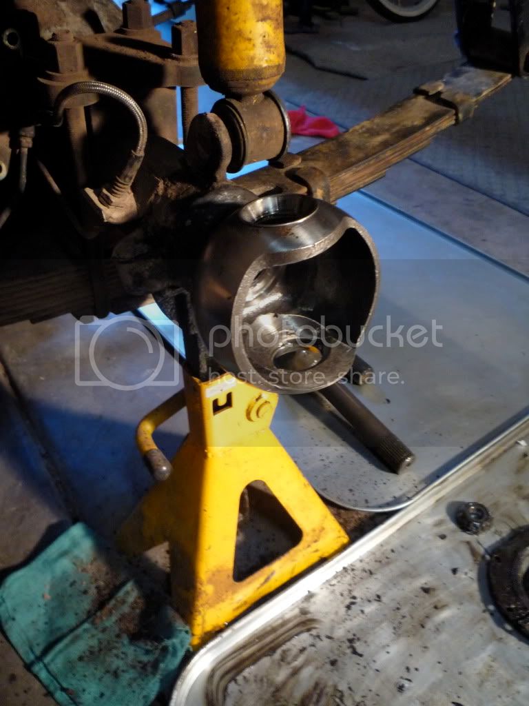

Front axle disassembled, all parts are clean and organized. Replacing all bearings/races, gaskets, seals, etc. Installed some of Marlin's HD inner axle seals and picked up a scale to test the knuckle pre-load, etc. Pre-load was good, I feel better. Rebuilt one knuckle so far. Had time to hit my relay/tie rods with some paint. Need to figure out the Brake Eliminator Kit too. Swapped the new drag link on and am working on rebuilding the center arm...
