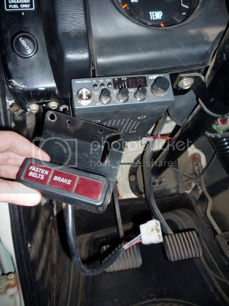

Here's a pic of the idiot light I replaced with the CB I picked up from a guy in my local TLCA chapter.

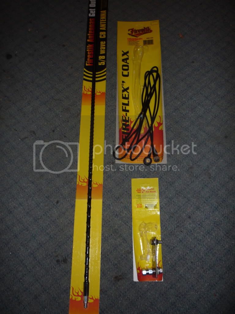

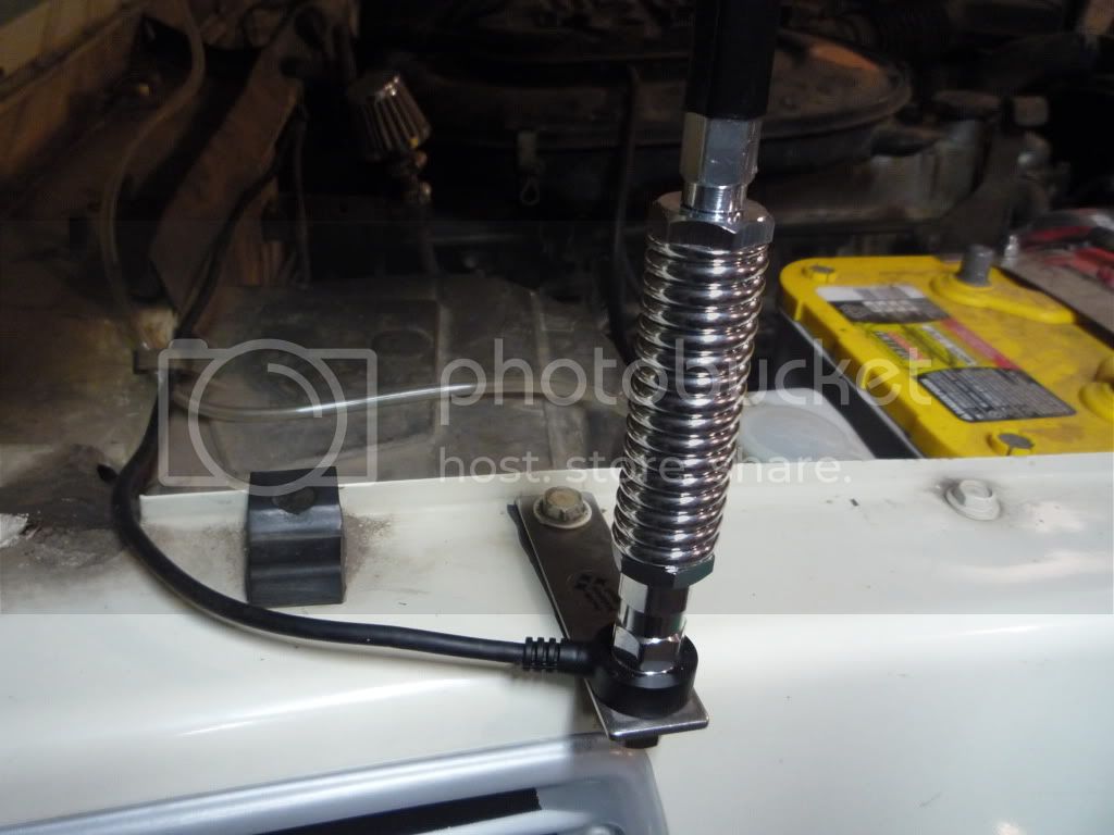

I read a bunch of junk about CB's and heard that the antennae is muy importante, blah, blah, blah. So, I went out and bought a new one for this application. Picked up a 4' Firestik, a new mount, and a new Fireflex cable.
Ended up mounting the antennae on the passenger side upper fender/hood area. Seems to work well there. I get great reception and I never even dialed it in. Actually used it for the first time at Cruisin' the Woods and finished the install in the lot just before the run started. I never get anything done until the last minute. :)

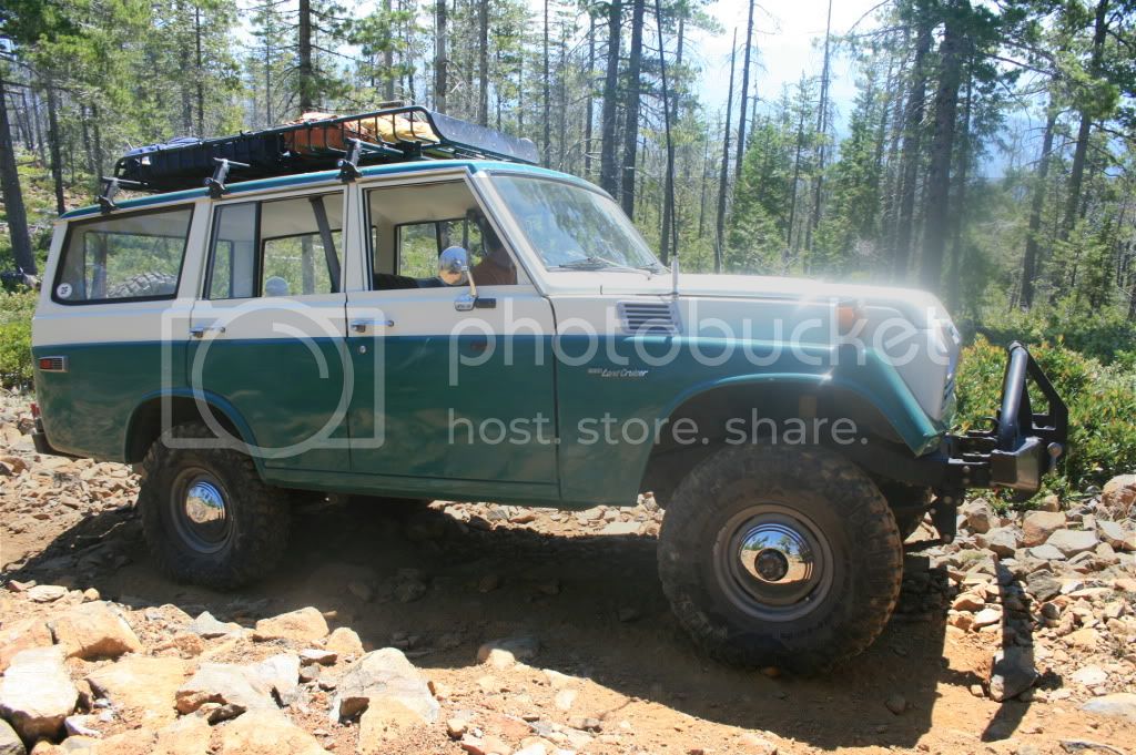

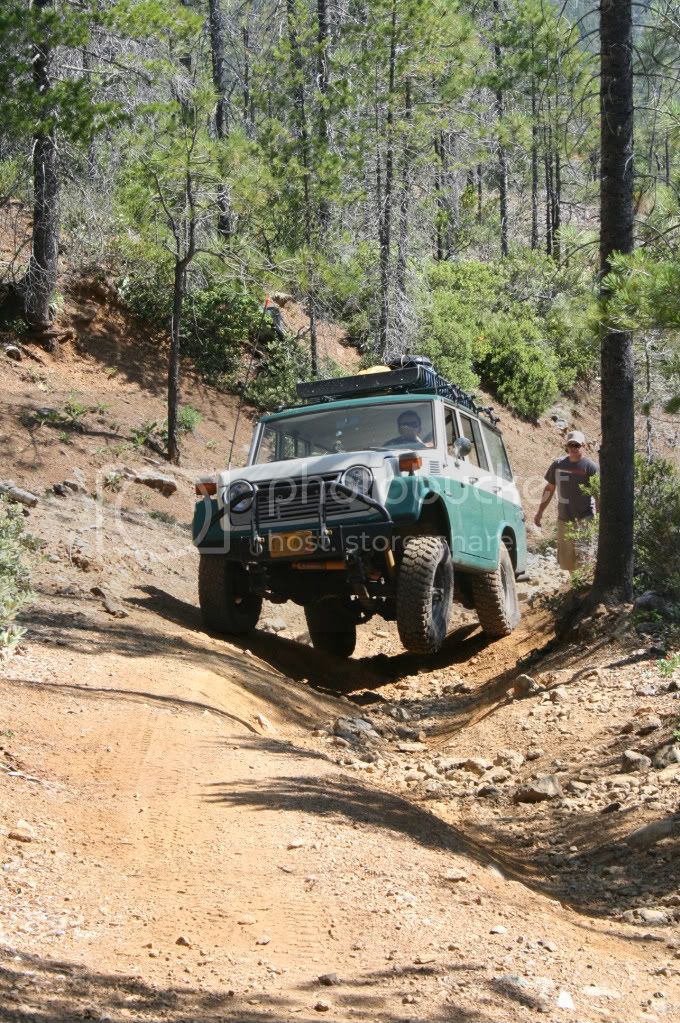

... and I drove the sh@t out of my rig at several events this Fall!
Drove to the coast
Then ran a bunch of trails up at Tillamook State Forest for the Cascade Cruisers Cruisin' The Woods event. This was a total blast and I attend to make it up there again.

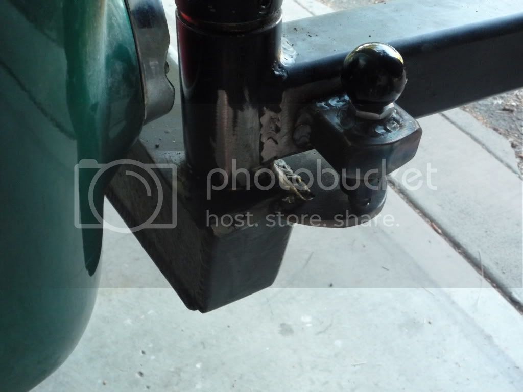

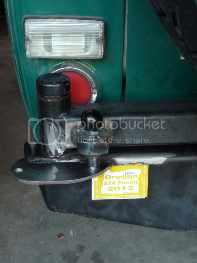

Also asked Graeme to build a bracket to mount the relocated license plate holder. It has a pull pin so its easily removable, , has a threaded stud to stop it from rattling, and has access for a lock to protect it and the spare. Still need to wire in the lights...
Rearend shot. :mrgreen:

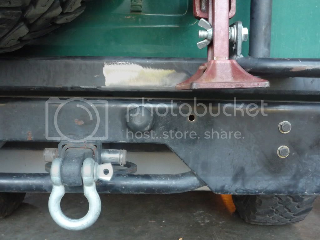

Oh yeah, and the ARB compressor bracket/inner fender mount. Need to install and wire it...
Graeme also tack welded spacers on the inside of my bumper to give me 3/8" more room to mount both of my lower reflectors. Finishes off the rear nicely. He also welded in the studs for my rear lower shock mounts. I relocated the rear shocks higher and out of harms way because they used to hang down below the axle. However, they were double-nutted on and came loose often. Ever since I installed the lift, I have been wanting to get this one. Nothing like McGrew to get me to finally get stuff done on the pig.

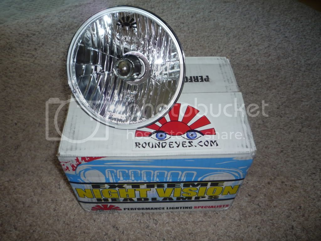

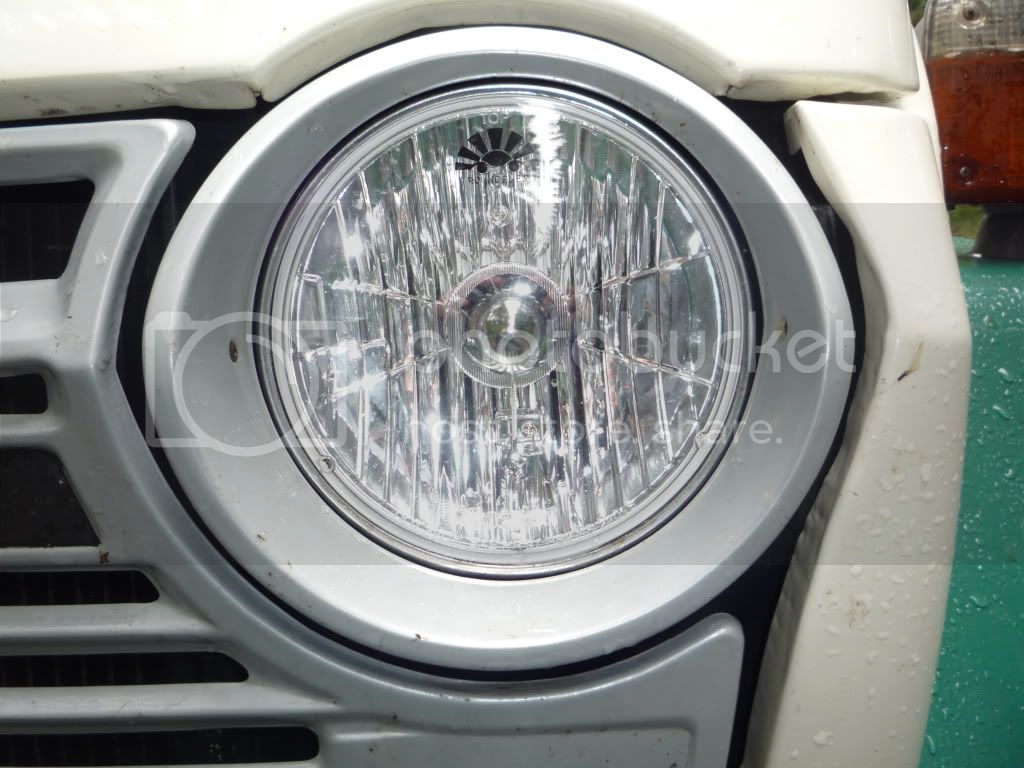

I also took the opportunity to upgrade to H4 headlamps when one of the sealed beams finally blew. Went with Round Eyes. Huge difference, plug and go!
