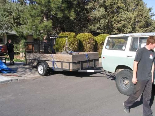

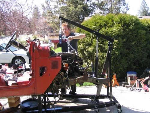

Here are a couple porgress pics of pulling the donor engine from a rolled '81 FJ40. Plan is to pull the entire 2F engine, 4 spd tranny, and transfer case as one unit and then replace into my cruiser.

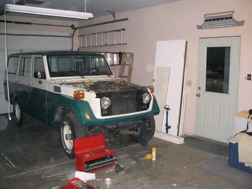

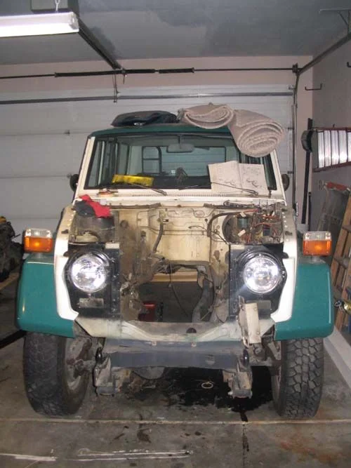

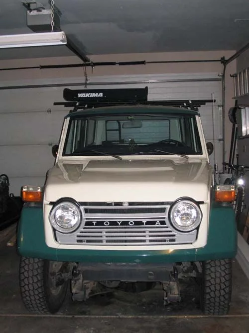

A couple pics of my cruiser sitting in the garage awaiting/during surgery. I have removed the skidplates, driveshafts, gas lines, battery/tray, vacuum lines and some other stuff. Plan is to remove the radiator and coolant this weekend and everthing else in order to be prepared for the removal. I plan on yanking the old engine while attached to the transmission and transfer case again. I have a a couple stubborn bolts to deal with also. Not many questions for the masses yet but I anticipate some head-scratching soon.

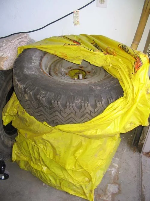

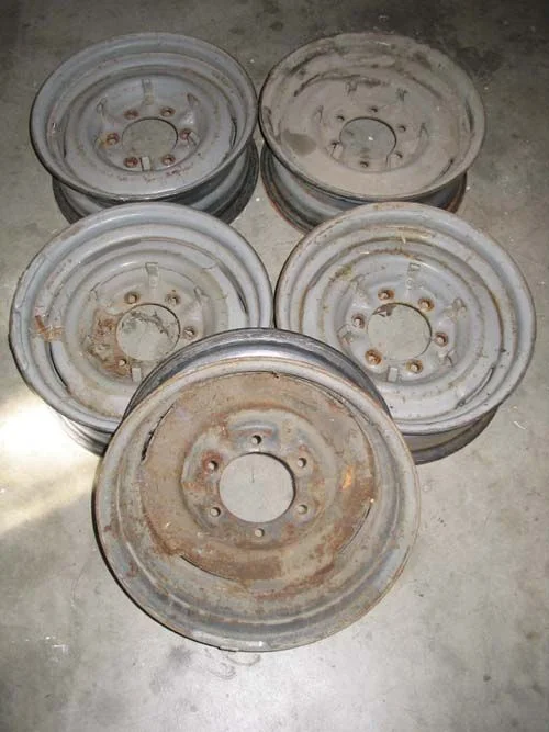

A couple weeks ago I unburied the stock rims for this cruiser from the dark corner of the garage and had the tires removed. Plan on mediablasting these rims, spraying some new gray paint on 'em, and then getting new tires. I would like to run the stock steelies and caps again.

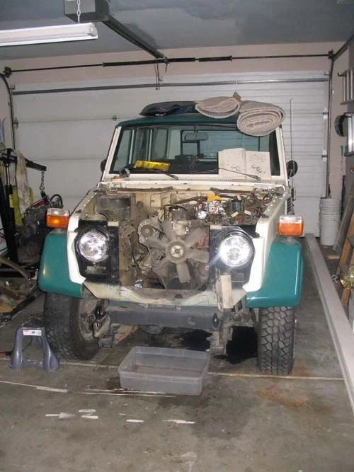

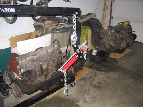

FINALLY yanked the old, tired engine out of the rig last night. What a great feeling. Now I can get started on prepping and installing the donor. Shouldn't be too bad. I have an email out to Jim C. for some advice and I may get my carb rebuilt by him. Still trying to figure out which power steering set-up to go with and I have a few other details to figure out. Last pic is of both engines side by side and waiting for me to swap parts. I think I will clean the engine bay and drivetrain a bit before installing.
