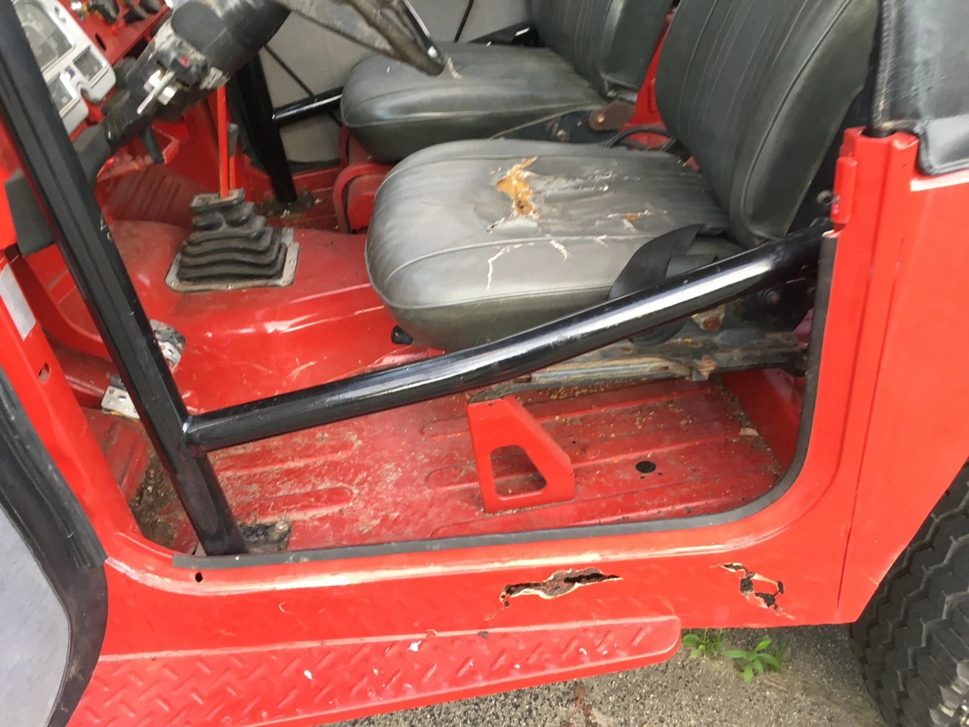

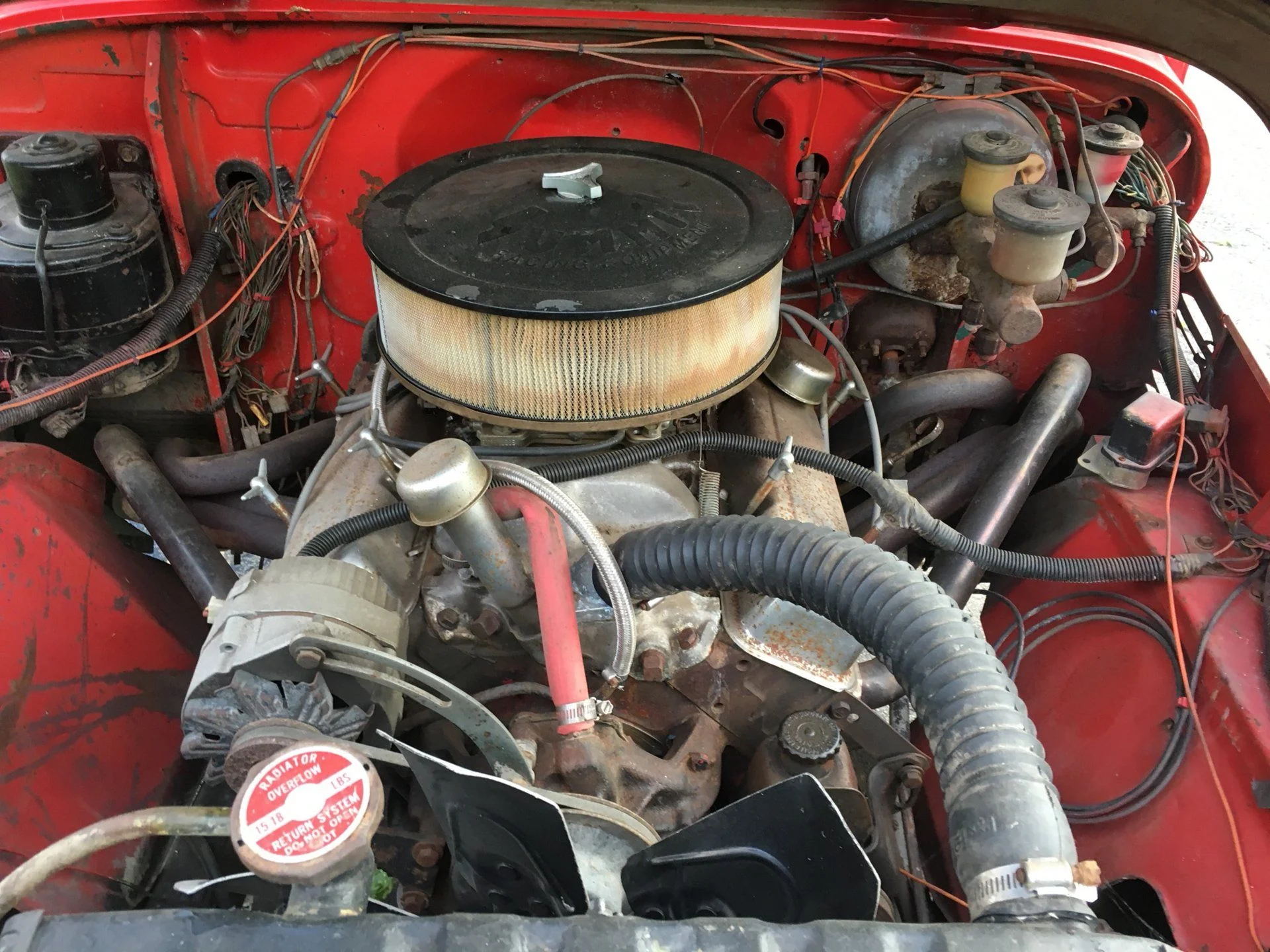

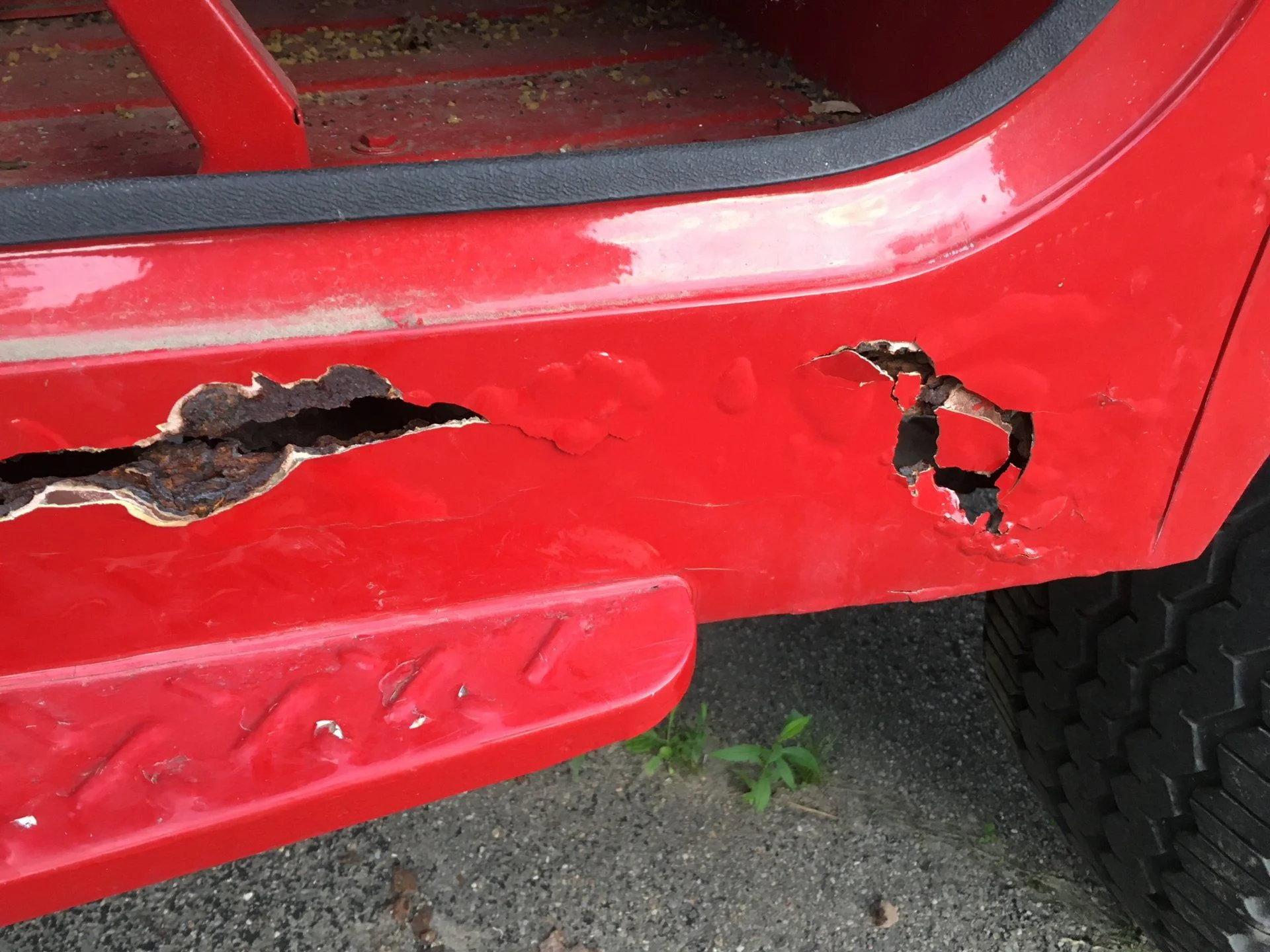

Those holes under the door didn't show up in the first pictures. It is going to take a lot of work to make things right. If you have a clean title and he doesn't try to rob you I say go with it knowing to make it a good ride is going to take a lot of work and $$$$$$$. If you are a decent wrencher and have a place to work and time I say go for it. In my opinion one of the first things I would do is dump that crappy small block conversion and start over. Not an installation most people would be proud of. I almost agree with 3 puppies about running, but I have seen worse finds that have been transformed into really nice rigs. Just remember the basics, time and $$$$$. :cheers:

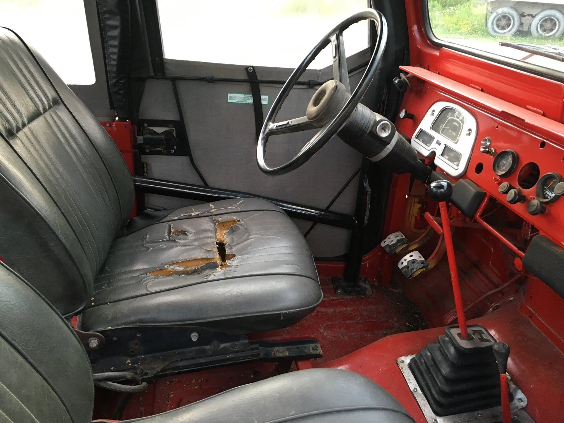

It was looking a bit interesting until that last batch of pictures! Some individual with some red paint and "A LOT" of body filler had their way with it. You have to be honest with yourself.... It's showing you indicators where the shoddy bodywork is imploding. It wont take long for other areas to present themselves. I would also think the mechanical's "craftmanship" would follow suit. Also, someone claiming ignorance of it's past is another glaring RED flag!

BTW from the looks of the front drive shaft angle the engine is not correctly installed.

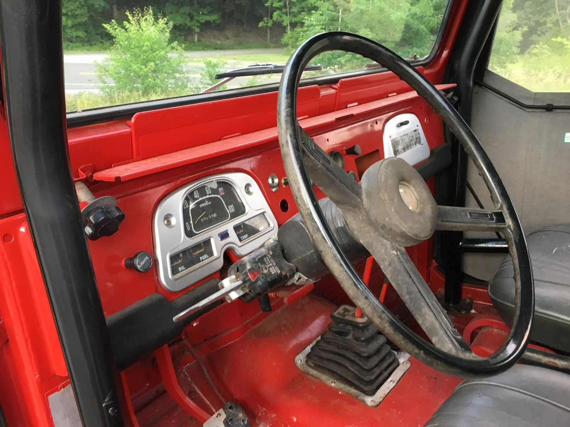

As an fj40 it isn’t worth much. Everything has been modified. The value is up to you and in how much you like the idea of owning a project.
Lots of PO stuff to write about there. My first thought was the exhaust. With those header pipes running under the floor like that will keep the cab nice and toasty in the winter and a hell hole in the summer.

I am pretty confident in my abilities but that looks like a lot of work so if I was looking to buy it I would offer a junkyard price of the V8 for the whole thing.
Basically, it is a mismatch of parts and years and aftermarket. (with NY rust and damage). I would offer 1000.00 and try to part it out. There may be enough to double your money to 2000.00.

Yeah I bet that tub is like swiss cheese based on the rocker holes. The wireing harness looks suspect. Lot’s of goofy stuff like the turn signal switch makes this a $1000 jalopy in my book.
If you want to buy it cheap to fart around with, make certain to closely inspect the frame.
