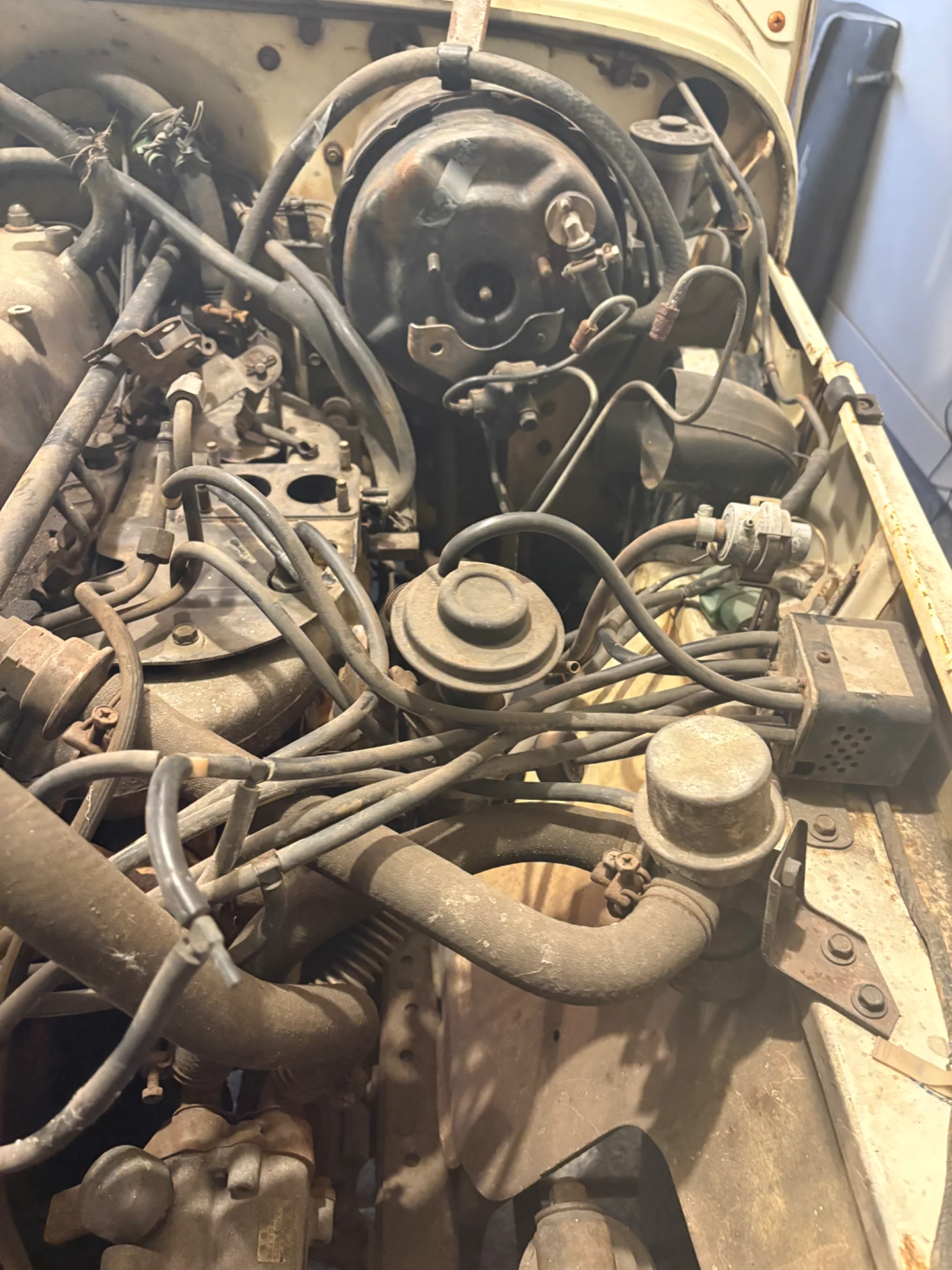

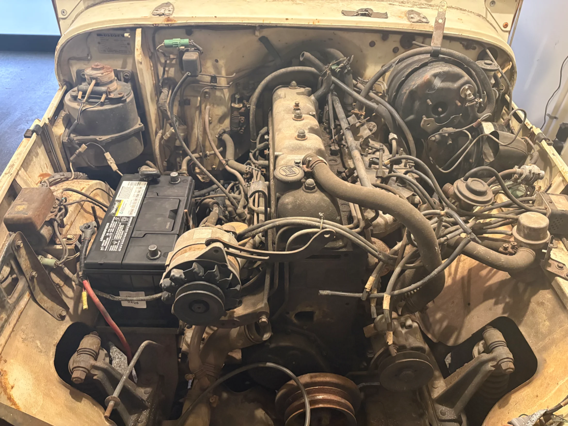

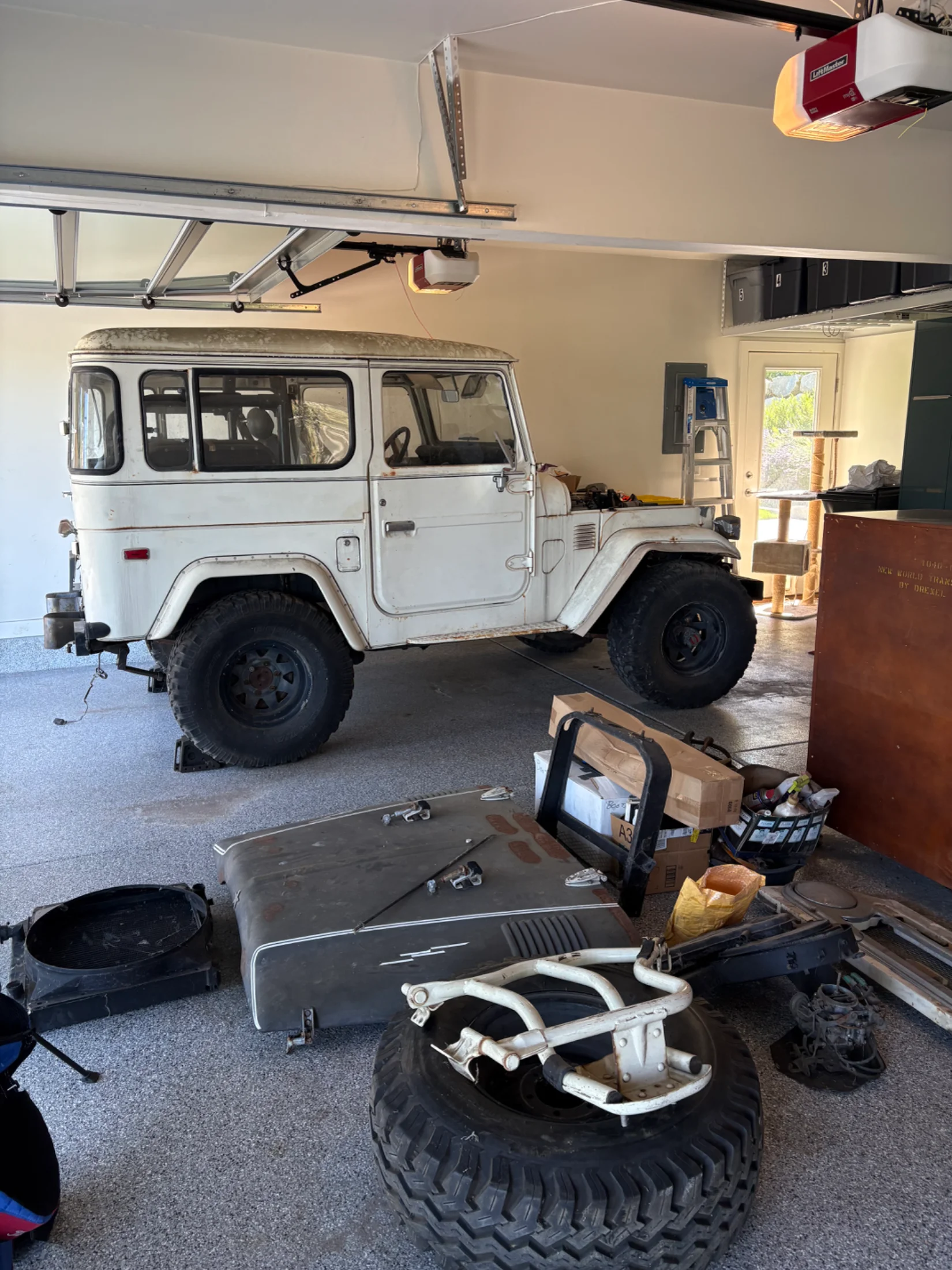

I recently purchased a non running 40 which I’m ecstatic about as it’s been my dream car, but I’m pretty inexperienced when it comes to all this as this is my first project car. I’m looking for some advice on a couple questions. First off I bought the car in California and have since moved it to Utah I would like to remove the California smog just to have a simpler engine bay, is that the right move? And how should I go about doing that? I also need a new water pump, carburetor, and master brake cylinder what do people recommend I get? I will also need all new weather stripping, is there anywhere I can get that for pretty cheap, everything I’ve found so far has been pretty pricey. Thanks so much I’m in need of a good amount of help!

I’m definitely leaning towards making it as stock as possible and daily driving it, while also wanting to take it on some trails

The carb @charliemeyer007 identified would not be my first choice for a rig that is going to be desmogged. A 75-80 non-US Aisan carb, sometimes referred to as a 61010 or 61011 would be the best choice. Behind that would be a 75-77 stock Aisan carb that has been properly rebuilt and desmogged. Third would be a properly rebuilt and desmogged 78. All of these will fit your current carburetor linkage, fuel lines and air cleaner without modifications.
The 61012 non-US market carb is a popular choice among many on this forum because it also comes without provisions for smog and is available in aftermarket versions for a fraction of the cost of a genuine Aisan that has been professionally rebuilt. Being designed for a newer vehicle with a shorter valvetrain, It is about 1/2” shorter than the 75-80 carbs, so you will need a spacer to seal your air cleaner to it. They also do not have a provision for a fuel return line, which your truck currently has. So you would need to either drill your own hole in the air horn for it, or delete the return line. I personally don’t favor drilling the carburetor.

You've got the "simple smog" and it doesn't look like the california specific one...probably federal. If you were to remove it....I personally would store it and not sell it. The rig can sell (if you eventually sell) to more places with smog components installed. Obviously there are different opinions on smog....but I think all of us have reconsidered decisions after we let something slip from our hands.

I think that link should be accurate, mine is oct '77 (we both have '78 model years I believe). Looking under your hood, you have lots of the same bits I do, although I can't tell if your regulator is a 3-wire or a 6-wire.

Check the '78 section of course. I 2nd the recommendation from @65swb45 re: de-smogged Aisan carb (I have the same unit), if you are going for something stock-ish and you are de-smogging.
Save that smog equipment / remove it carefully! It's in high demand on the ebay for folks doing factory resto's / trying to get their truck up to smog standards. It can help you pay for some parts down the line, of which you will need many :)
Nice rig! I need to replace all of my weather seals on my 72 also. Here's what I'm getting from City Racer. I would include part numbers but your truck is a later model than mine and will need different seals in several places. Obviously, you have Ambulance doors instead of the tailgate/hatch setup that I have, different doors, etc. I don't want to steer you down the wrong path on that. Here's a link: Land Cruiser 40 and 55 Series - https://www.cityracerllc.com/collections/land-cruiser-40-and-55-series

do all your underhood hoses - both Water and Vacuum. and then the fuel hose (can be generic fuel hose from local parts store.
Looking at the Brake Fluid, that should be changed as well - it looks pretty nasty, Clutch Fluid the same.
SOR, CityRacer and there are several other good vendors, some have hose kits. Check if you have the Oil Cooler option - depending on year, it has a couple of special hoses. and of course your Thermostat and perhaps WaterPump - take a look at them when you are replacing hoses.
Nice Rig!
