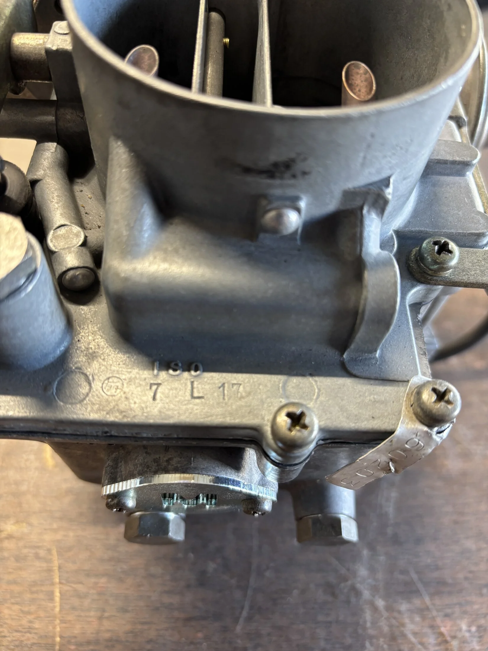

@65swb45 I recall you saying there is a difference between the born on date and the model year for the carb. Based on the date code "7 L 17" this one is born on 1967 or 1977 December 17th. I don't recall which year you told me. I know there is significance to the tag "60203". This is mainly for my sanity when I am looking in the FSM for adjustment instructions it'll help to know which model year I am supposed to reference for the carb.

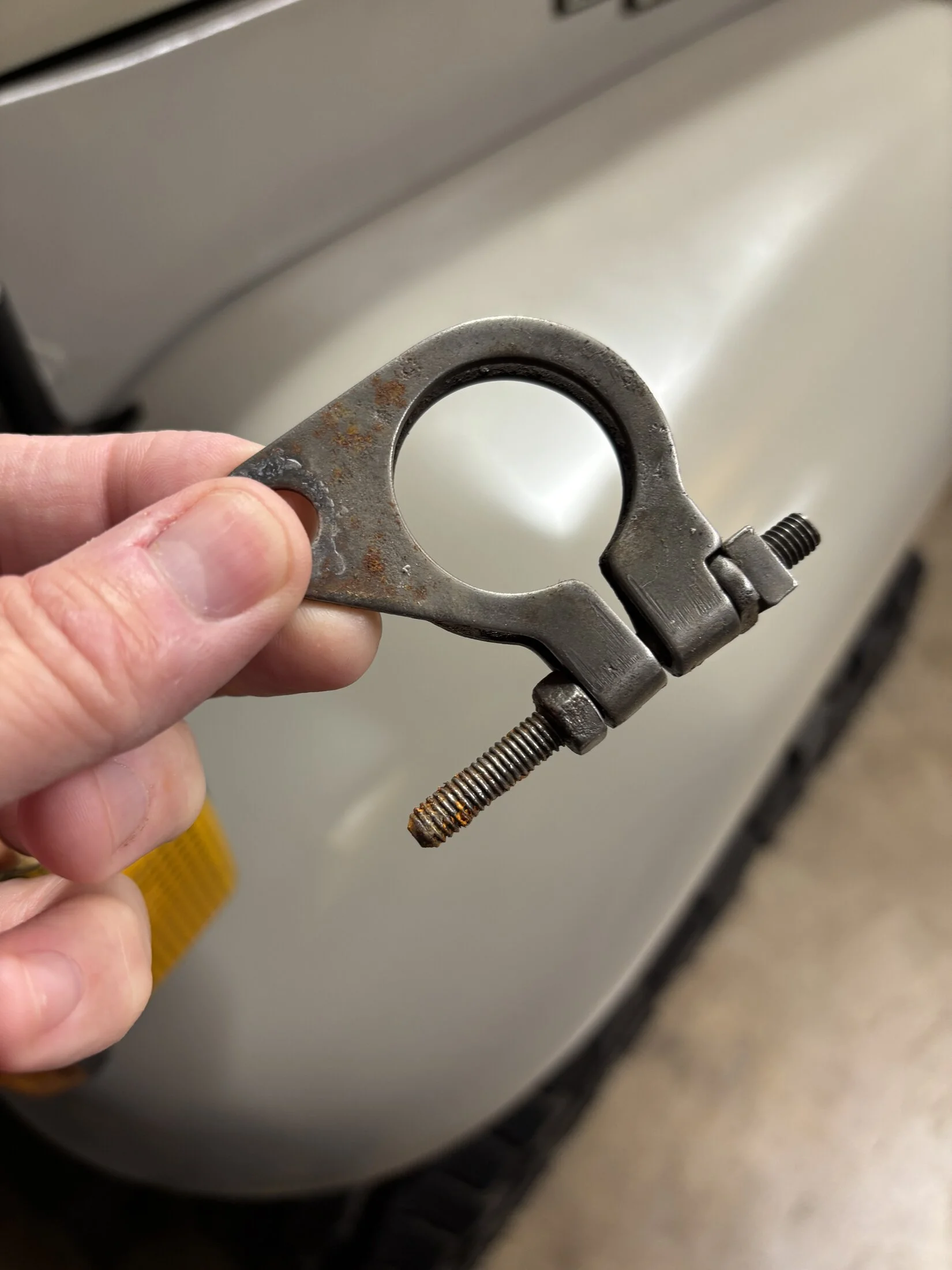

Do you have the 2F-type distributor clamp? I've broke two of those clamp bolts, and I don't trust old ones.

I have two distributor clamps. One in use on the old engine and one that came with a dirty distributor on the new engine. I am going to test fit it while it is out of the truck.

It looks like the PO of the new engine had trouble with that distributor clamp screw as well... It is an M6x1.0 iirc; mine came from the Hillman collection at the hardware store, an all-chrome plated screw with 8.8-marking on the head. Your threads look rounded and corroded. At least you still have the square nut to re-use - do you have a tap to restore for the thread on the nut, if necessary?
The 7 is irrelevant. The tag is your go-to. 60203 is the microfiche reference number for the carb it was designed to replace
