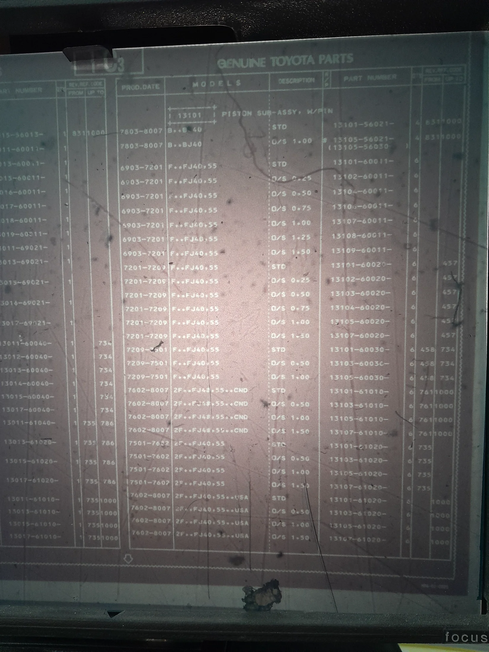

I have the Toyota forklift parts Catalog EPC. I’ll see if I can fire up my old windows XP machine and I snoop around and see what part numbers show up for the F and see what uesrs they used the F in. Maybe the fork lift catalog may have some info. I’ll see if the part numbers cross over to the dealer epc. Hmm.
This pic is from my jan '81 microfiche set for the US and Canadian markets from 03/69 to 07/80. Part numbers may have changed since jan '81.
