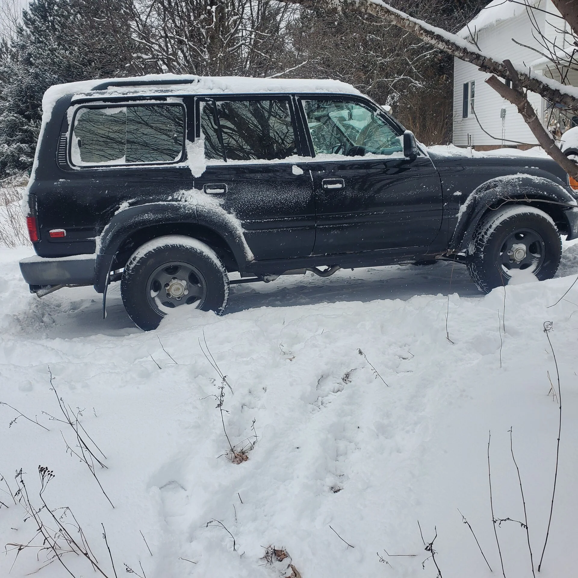

Hi all! I've been lurking on IH8mud for about a month now, and this seems like a great community.
I've recently purchased my first Landcruiser, a 97 FJZ 80 series. I'm both excited and worried. I'll elaborate a bit on how I came to purchase this rig. If you just want the pertinent info without the explanation, skip the next paragraph.
My '04 AWD MT Honda Element's unibody is about to fail due to rust, so I decided I'd better look for another vehicle to drive year round. I'm traditionally a GM guy, but have had a great ownership experience with my honda, so I was looking at Hondas and Toyotas as well. My family has recently grown to 4, so I started thinking something bigger and safer than an Element might be a better choice. I live in an area where we can get 300+ inches of snow a season, and half of the cars on the road are full size pickups with plows in the winter. I am also 100 miles from the nearest Honda or Toyota dealers. One day I happen across a 97 landcruiser on Facebook market for less than most 4 runners I've seen. The photos look better than most older Toyotas for sale locally, and it has front and rear locking diffs! My recollection of landcruiser's was that they were pretty stout vehicles - should get through the deep snow well. I figured based on my honda experience that repairs may be a little more expensive, and parts may be a day or two out, but all together reasonable. I figure it will be the same for a Toyota. A quick Google search shows these are very reliable highly regarded vehicles, and the asking price seems pretty good. According to youtube this is the most reliable and off road capable vehicle ever mass marketed and I can drive it from Michigan to Africa and back again! (Taken with a grain of salt). It was 9 hours from me, but much closer to my parents. Based on a test drive by my parents, and a conversation with the PO, I buy it. Excited about my new daily driver I start to learn more about it.... like it has a fork lift engine, a bus transmission, and front end hub assembly that was developed for use on lunar rovers. I start to worry about parts cost and availability...
So I find myself the proud and concerned owner of an FZJ 80 with a lot of rust (albeit little rust for the age and miles for where I live), and a lot of quirks. Most concerning is some play in the front wheel bearings?, and bad rear shocks. Annoying is the floppy parking brake that doesn't seem to be attached to the floor, the shift lock that always locks, the ABS light on the dash, the attena that won't go all the way up or down, the cigarette lighter socket that seems not to work, the rear window sprayer that actually activates the front sprayers, the very large tear in the drivers seat and the fraying seatbelt.
My intent for this rig isn't to cross deserts or rock crawl in Moab. It is to be a safe capable family hauler 4 seasons, no matter how bad the weather, that can explore some local trails in the summer within an hour of my house. I can't help but really like the Landcruiser. It's such a cool vehicle and I understand its following, but my question is do I keep this one, or put it back up for sale in the spring before something goes seriously wrong? Anything I drive in the winter here will eventually succumb to rust. I am a novice home mechanic- I've replaced rear shocks on a not rusty yukon, front quick struts on a rusty honda element, and have unbolted/ unplugged a few things that weren't working under the hood to replace then with things that were working. I only own a butane torch, I don't weld, and I know with rust something as simple as replacing a tie rod end can become a seemingly impossible task...
I took off the running boards ( the drivers side was falling off) and I plan to change differential and transfer case fluids this weekend. Also change oil and oil filter while I'm at it. I'll snap a few detailed pictures and some shots of the underbody while I'm there. If I keep it I'd finish baselining it, probably apply fluid film or similar after some wire wheel work, put new possibly upgraded shocks all around, and try to fix everything I could within reason. Would probably have to have the Birfield service done professionally as I think given the rust, it would be beyond my abilities. If I stick it back up for sale, will probably put OEM shocks in back, fix what little things I can without much expense, and hope to get back out what I'll have into it.
Thanks for the welcome and any experienced Insight provided.

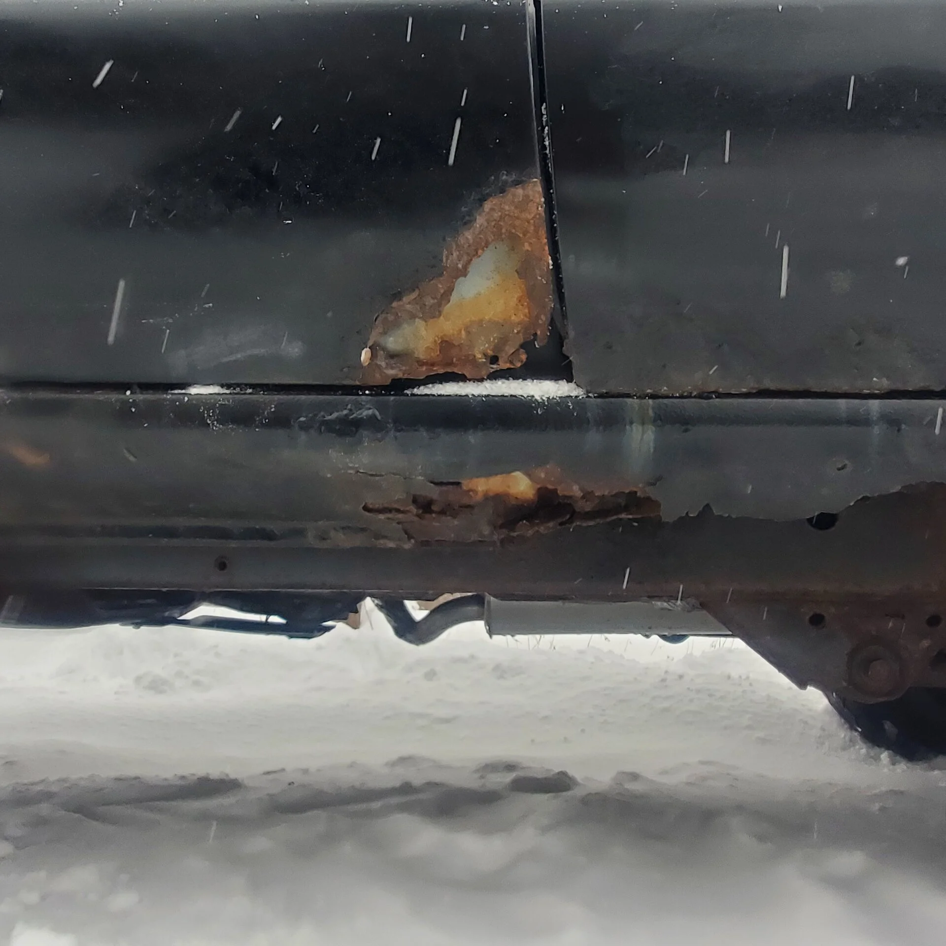

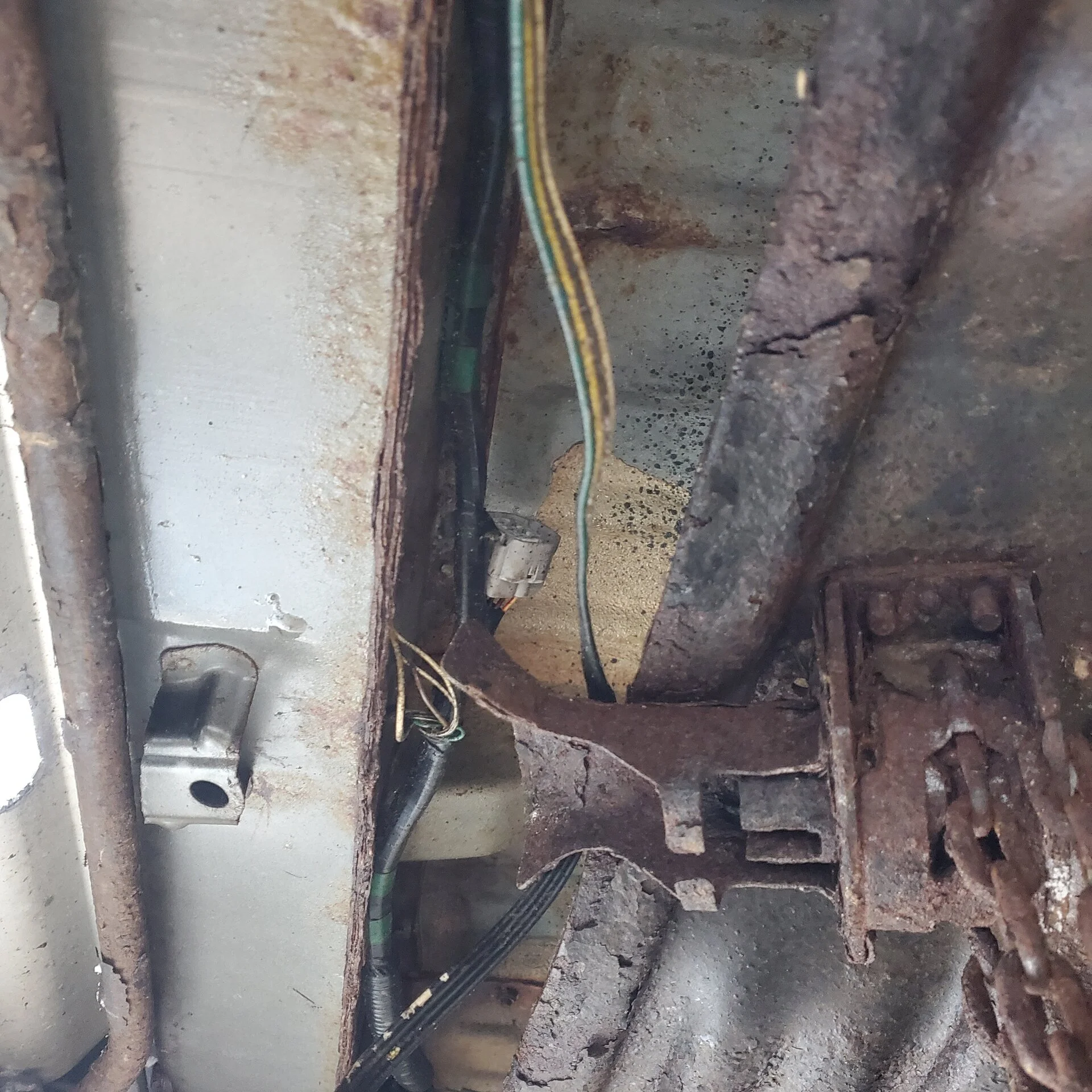

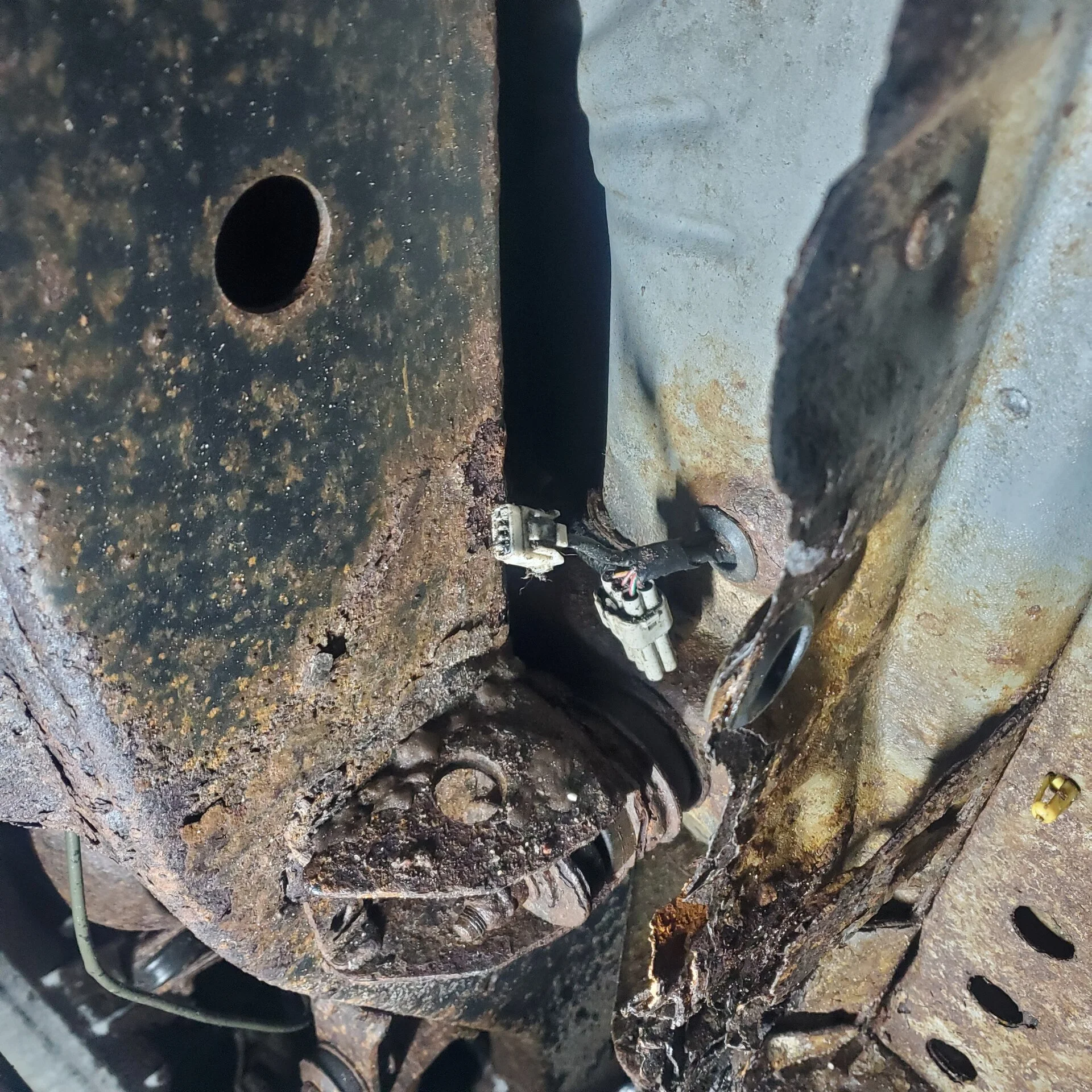

I took a few more pictures of the rig, some details of the rust. I also took pictures of a couple plugs that aren't plugged into anything underneath. Anyone know what they are for?
Found out today I don't have a Cat, looks to have been deleted by the PO. I did the rear diff and realized there are crush washers I didn't have. Based on the Doorman generic washer the parts store gave for the oil plug, I heeded the advice and decided to order OEM crush washers for the diffs and transfer case online - the rest will have to be next weekends project. I already had an OEM toyota oil filter based on the info I previously read on here. The oil filter on it was a brand I'd never hear of, there was no crush washer on the plug, and the oil looked quite dirty. The rear diff fluid was black, opaque, and smelled burned. I don't think this rig was well cared for by the PO
I will try no to ask too many stupid questions, but I'm sure I'll ask a few and this may be one - It doesn't look like there is much room between the bump stops and the axle in the rear - is this due to the bad shocks, or can I conclude my coil springs are tired and need to be replaced as well?

Not sure about the unplugged plugs. There are some test points (?) scattered around the various harnesses, so may be inconsequential.

Aiee, that rust. You won't hurt it much more by winter driving it IMO.

"It's such a cool vehicle and I understand its following, but my question is do I keep this one, or put it back up for sale in the spring before something goes seriously wrong?" (This)
"the floppy parking brake that doesn't seem to be attached to the floor" (Because it no longer is)
"the running boards ( the drivers side was falling off)" (Not a good sign)
"probably apply fluid film or similar after some wire wheel work" (change that to after replacing the frame and body)
"I started thinking something bigger and safer than an Element might be a better choice." (not if the frame cracks while driving at 70mph or the body comes off it's mounts due to rust)
"this is the most reliable and off road capable vehicle ever mass marketed" (not in it's current condition)
IMHO, it may be too far gone.
So one option is to sell the rusty one as soon as you can then find one in the South or Western US without rust, put temp plates on that one and drive it home.
But if you do find a clean rust free 80 Series have it professionally rustproofed (complete (ie Ziebart or similar) rust proofing treatment $1000-1500) (B E F O R E) you drive it in winter weather, ice, snow, salt, etc. IME rust free vehicles that spent their lives in the South or West rapidly develop rust after they enter the Dead Zone rust belt.
Expect to spend $10,000-15,000++ for a good one then spend another $5000 minimum to get everything right. What you spend is determined somewhat by what repairs/service you can do yourself versus paying someone to do it.
These are not inexpensive vehicles to buy, drive, or keep up.

Yuuuuurkk!! I would not sink anymore than necessary into something that rusty!
As stated, bringing a 30 year old landcruiser up to scratch will take a decent sized investment of time and money.
Why put that into something so far deteriorated? It's doomed from the get go.
A cheaply purchased cruiser is likely to need a bigger outlay to baseline.
A better maintained/ better condition cruiser might cost more to purchase, but may already have a chunk of work done.
SNIP If I can buy something inexpensive ( this was relatively inexpensive), keep something running cheap, and not be out too much when it dies an inevitable rusty death, I can accept that also. I don't know if a Landcruiser can fit that bill now that I'm learning more about them....As far as I'm concerned there is no way to preserve a clean vehicle while winter driving it here.
If you look at this from the point of view of keeping it running for cheap, it may not be as costly as it might seem with many of us here trying to preserve nice examples of the breed. There was a Canadian member back when I first started who did a lot of things on the cheap and managed to keep it going without any big outlays for several winters. Unless something clearly breaks that;'s vital, these are remarkably rugged and resilient trucks. There's nothing that really stands out as a show-stopper among its issues, especially if you do your own work to the extent possible. When it's time to go, someone will pony up some cash for those locking axles.
Personally, I would cut your losses now and sell it. I understand that rust is an issue in the UP, but you are missing chunks of that car due to rust. I see that you're a Honda guy--get a used Ridgeline in decent condition and you'll be happier, and safer.

Let's see a photo from underneath of the rear springs and shocks. If you decide to keep this one, I would NOT be buying new springs unless the current ones are broken or headed in that direction due to excessive rust.
IMO that truck is a trail rig now. The rust will make everything hard to do, and it will never stop now that it's that deep. What you can see is about 50% (or less) of the actual rust. If you were my friend I'd tell you to try to at least get your money out of it, make a little if you can of course, and find a different vehicle. I work on all my vehicles and my '97 80 series takes quite a lot of my time. I do drive it almost all the time, but it's a 30 year old vehicle now, and it was in at least a couple of winters. It has fairly minor surface rust underneath, but even that little bit of rust means almost every smallish diameter bolt breaks upon trying to remove it. It's needed a full exhaust, almost every rubber part has been replaced or will be in the next year or so (hoses, window seals, door seals, etc.), brake calipers were replaced because of rust on the pistons, brake lines (30 yr old rubber lines), LPSV (MAJOR PITA), little rust in the rear of the rocker panels needed fixing (I did the work myself), front axle seals replaced (super messy), oil pump seal, fan clutch, radiator, intake hose, seat leather replaced, seat gears replaced, to name all the big jobs. I was into the truck about $2800 because a buddy sold it to me cheap as he was moving overseas, I've spent double that (and likely much more) fixing all the bad stuff. And this is a truck that was way better off that yours is right now. So sorry man, I say cut your losses and find a better vehicle to start with from the get-go. Your mental health will thank you.
