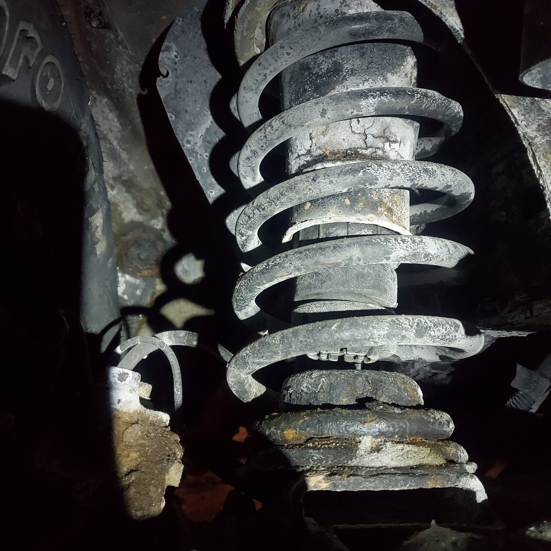

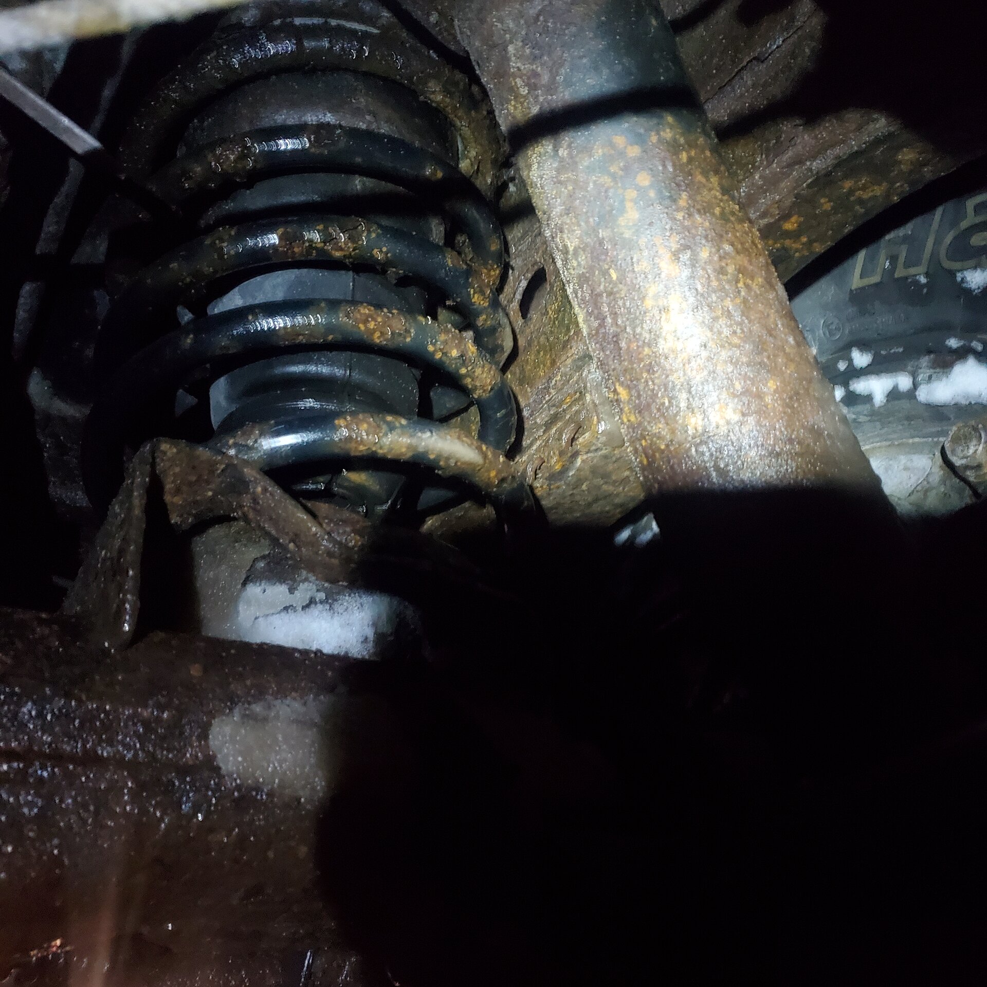

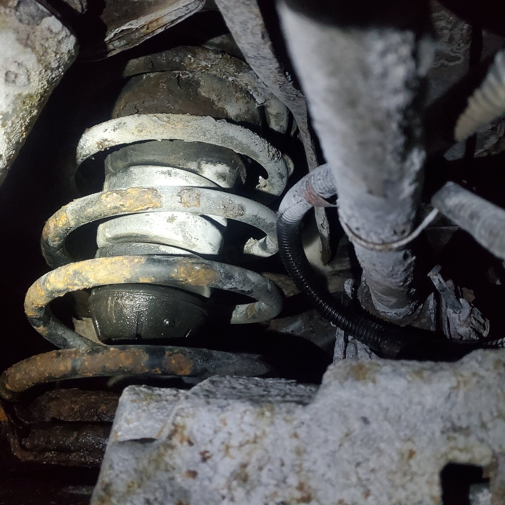

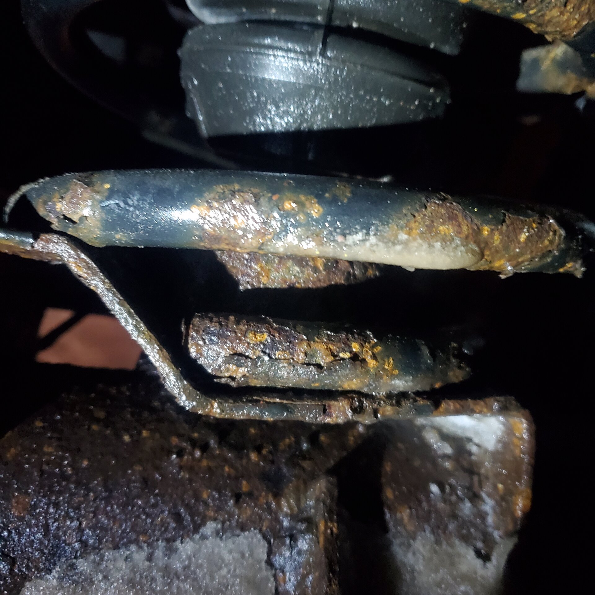

Let's see a photo from underneath of the rear springs and shocks. If you decide to keep this one, I would NOT be buying new springs unless the current ones are broken or headed in that direction due to excessive rust.

Definitely check the underside and ensure the shock mounts and spring perches are not rusted through before putting money out for shocks. As you already said, a wire wheel and fluid film should be in your near future. In one of your pictures you can see the stock spare tire carrier and it is past its life, you can just remove it and that is one less rusty part to worry about.

I took some photos of the coils as suggested by @Devils Paw 80 . It is nearly sitting on the bump stops on all 4 corners. There's some rust there, but I don't think the rust is the cause if the sagging. I can certainly try shocks and see where I'm at before buying coils. Looks like shocks and coils would be something like $1200 + from OME or Dobinsons. I'm not apposed to that exactly, but that's a commitment to have this a while, and I'm still feeling pretty non-committal at the moment. I can get toyota shocks for less but looks like rear oem coils for a truck equipped with the 3rd sear are discontinued. Would I mix oem front with aftermarket rear I'm this case if i wanted to keep investment low? Is it a big deal to run standard coils in back with it possibly loaded with passengers sometimes?
No issues with OEM coils, these things had full productive lives straight from the factory. Keep a sharp eye on the MUD classifieds, never know what you will find and don’t be afraid to post a wanted there. You can do the same in your local clubhouse section, you never know what someone has laying in their garage a couple miles away.
If you want good quality shock that is affordable, get the Tokicos. OEM coils are fine for what you want to do. I think you should decide on whether you want to do a lift on the vehicle. If you want to do one relatively soon, you might as well do it now.
Rust holes in the body don't bother me so much, but you'll want to keep an eye on the left side of the rear axle where the panhard mount and spring perch come together. That area is prone to corrosion and if you lose the panhard mount, the rear axle will try to exit the vehicle.
