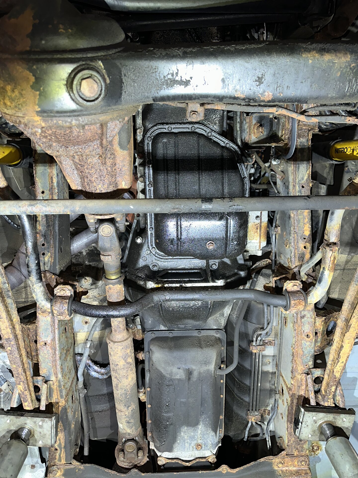

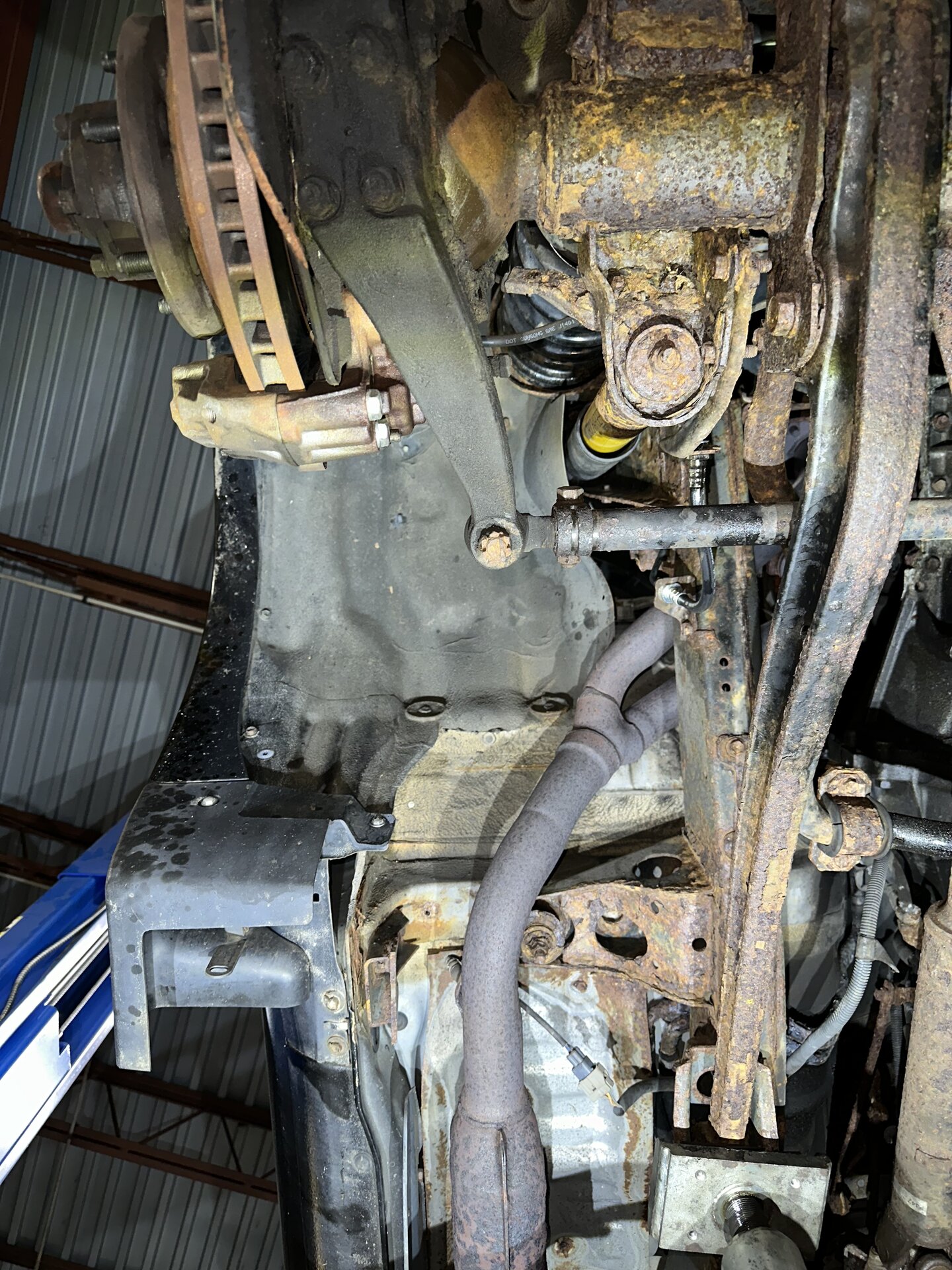

In my personal opinion, yes, you made a mistake. Id sell it without putting a cent or minute of time into it. If you lose a little money, its worth it to be rid of it. You will forget about that soon enough. Cut your losses.
Perches don't look that horrible to me, but hard to tell overall. Just remember on the shocks that they do nothing for ride height...they may make a temporary height adjustment when you install them without springs, but the springs are what control height, shocks just keep them from bouncing too much. I'd look for some OEM height springs and basic shocks and it will make a huge difference in the ride.

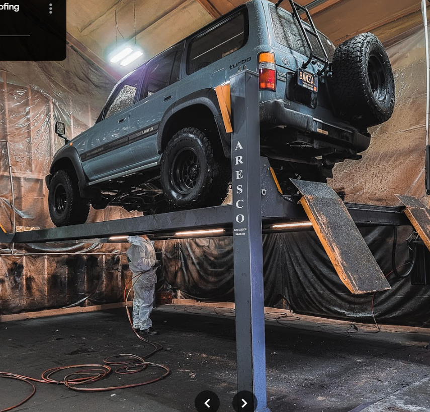

I would make a serious plan to address the rust and rot, before it turns into full rot and ruins the truck.
We had one here recently where we guided the owner to a great place who did amazing work.
See for yourself, before & after (metal brush scrubbed, dry ice cleaned and lathered in protection).
Well worth every penny.
