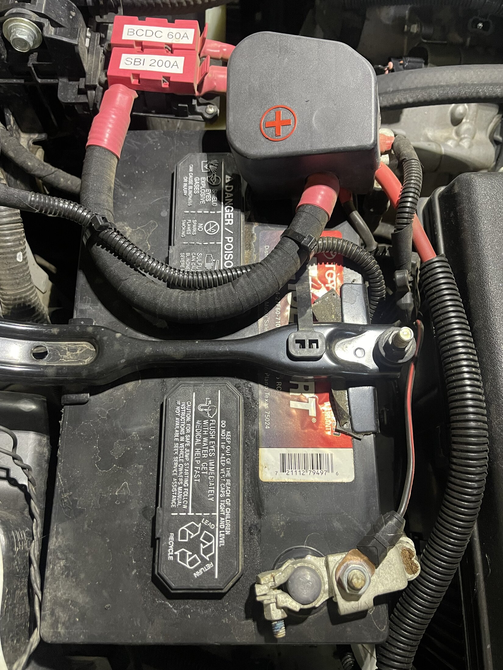

Reading through the different battery threads and this one seems like the place to pose my current conundrum.
2021 with dual batteries and most accessories running off second battery. My camper charges off the starter battery as recommended by Redarc which is what my camper uses for BMS. Use case consists of plenty of punishment, long days towing on and off road with plenty of trail running in between.
Camping this weekend and I get the beeping alert from my Redarc battery volt meter upon start up. Voltage is dipping into the 10 volt range under starting load at camp where temps were in the 30°s. Testing today with my battery load tester and it reads 11.5 under load in my garage.
While not being driven these batteries stay on my NOCO charger. I try to drive once every 10 days, truck is a weekend warrior with a few multi week trips during the year.
I’m on the fence if I need to replace now or not. However, we do have a 2 week trip to big bend and southern New Mexico coming up in December that has me leaning toward replacement.
Another note, there is some evidence of seepage on top of the battery, see picture.

My vote is to replace it. It’s given you 4 good years and replacement will give you peace of mind as well as clean terminals. Your instinct to avoid dealer involvement is right on. The caps are removable if you ever want to check levels. And yes to TrueStart.
I would start by cleaning ALL your connections at the battery. They may look fine, but corrosion sneaks into there and can cause the issues you describe. Costs nothing but a few minutes with a decent terminal cleaner and a wire brush.

I also have seepage as well. I clean terminals and spray protector in the connections.

I agree with all these comments. Batteries start wearing the day they get put into service. The threshold for a "bad" battery is generally 80% of its original capacity but there's no common practical way to test that. Most of us are using it well beyond that to starting failure. I agree with @gasman4u , these should be looked upon as consumable if you want optimal performance. Or avoid issues on a trip.
The Truestart is a flooded lead acid and you can pop off the caps to see if the water levels are low. A good way to test health is a battery hydrometer which are easily had. They can tell state of charge and also cell health. Probably not worth testing as assuredly the battery is worn enough at 4 yrs in. Still serviceable but it's not going to be at top performance.
Another way to tell wear is seepage and corrosion. Whether from systemic low states of charge or overcharging, they will start off-gassing, which creates the corrosion. Sure sign it's better just to replace than clean/service as the inevitable is not too far down the road.
The cold weather usually precipitates a ton of battery replacements. It slows down the chemical reaction that produces power. Where it may be serviceable in warmer weather, the cold removes remaining margin.
As an adventure vehicle and not a daily commuter, the battery is more critical. As soon as I see signs of lost reserve or starting power, I change it. That's generally around 4 yrs. The low speed crawling and heat saturation, high draw, deep cycling, etc. all put greater wear on the batt.
It's less than a tank of gas to replace a flooded lead acid (which is the best chemistry for the starting battery, because the alternator is setup for that chemistry charging profile). Makes it an easy decision in my mind.
