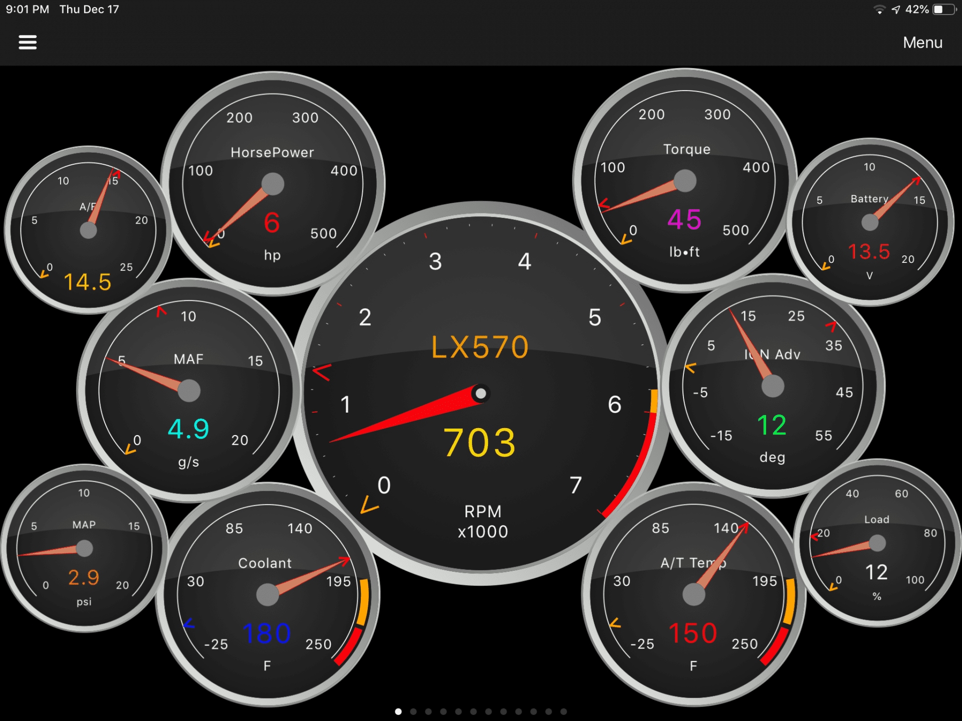

Depending on what someone means by “take advantage”, testing shows that may not be the case.
Note that I’m not saying premium will add a ton of power of mileage, just that the ECU does appear capable of tracking knock feedback and adjusting timing parameters to suit.
Seconded. I’ll lob the grenade into the thread and state that running higher octane in my vehicle absolutely increases the ability of the engine to advance engine timing under load, which sometimes results in a noticeable difference in power. Or more specifically, it prevents a reduction in power which can occur with lower octane fuels under load at high ambient temperatures.
Knock correction learning value when I run 91 octane is typically around +18. I’ve seen it cross 19 with 93. On 87 it sits around 14-15 and very occasionally will get up to 17. KCLV for the uninitiated is the amount of timing advance permitted by the ECU before it predicts engine knocking and has to retard the timing. So there’s no difference in power driving around town, but if I’m on the highway going 75, especially loads down towing, and it’s 95F in Nebraska with a little crosswind on 87 I consistently will find the truck has to downshift to maintain 65-70. If I consistently run premium this doesn’t happen.
All that said to the OP my rig is modified and I notice it more when towing (which means running in 5th gear for me). Your experience may vary. And except in the circumstance where I would have a drop in power in the above conditions and have to drop down to 4th gear on the highway to maintain speed there’s zero actual difference in MPG
