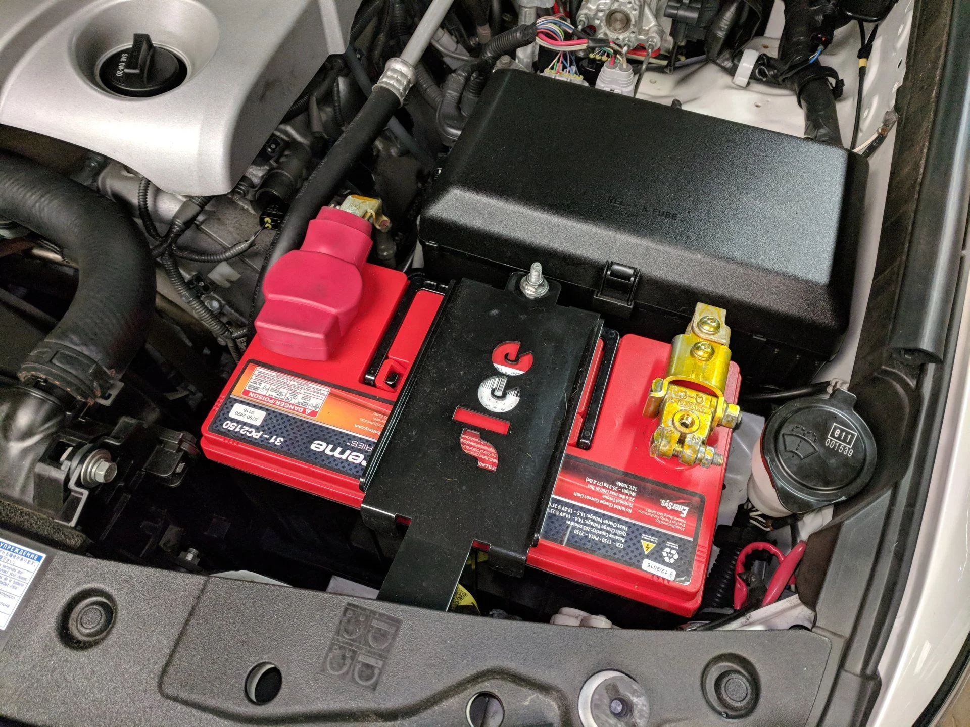

In my fiddling with batteries, I really gathered a lot of feedback via review and speaking with battery folk that while Optima used to be the go-to, their quality controls have taken a nose dive in recent years. Not that they don’t work...but that tgey’ve Become hit-and-miss.
Odyssey, OTOH, has really built a solid reputation with both users, suppliers and through my own personal battery torture chamber tests (my truck basically a torture test for batteries—for all it’s power outlets, microwave, coffee maker, constant fridge use along with a zillion always-charging items).
If you are looking for a solid **brand?**
Odyssey is solid.
YMMV...

Odyssey Extreme has been the best battery I have ever owned. Definitely worth the money in my opinion. You can get them from Amazon with Prime shipping!
Check the video on how they are made. Virgin lead seems to be key to their longevity.
