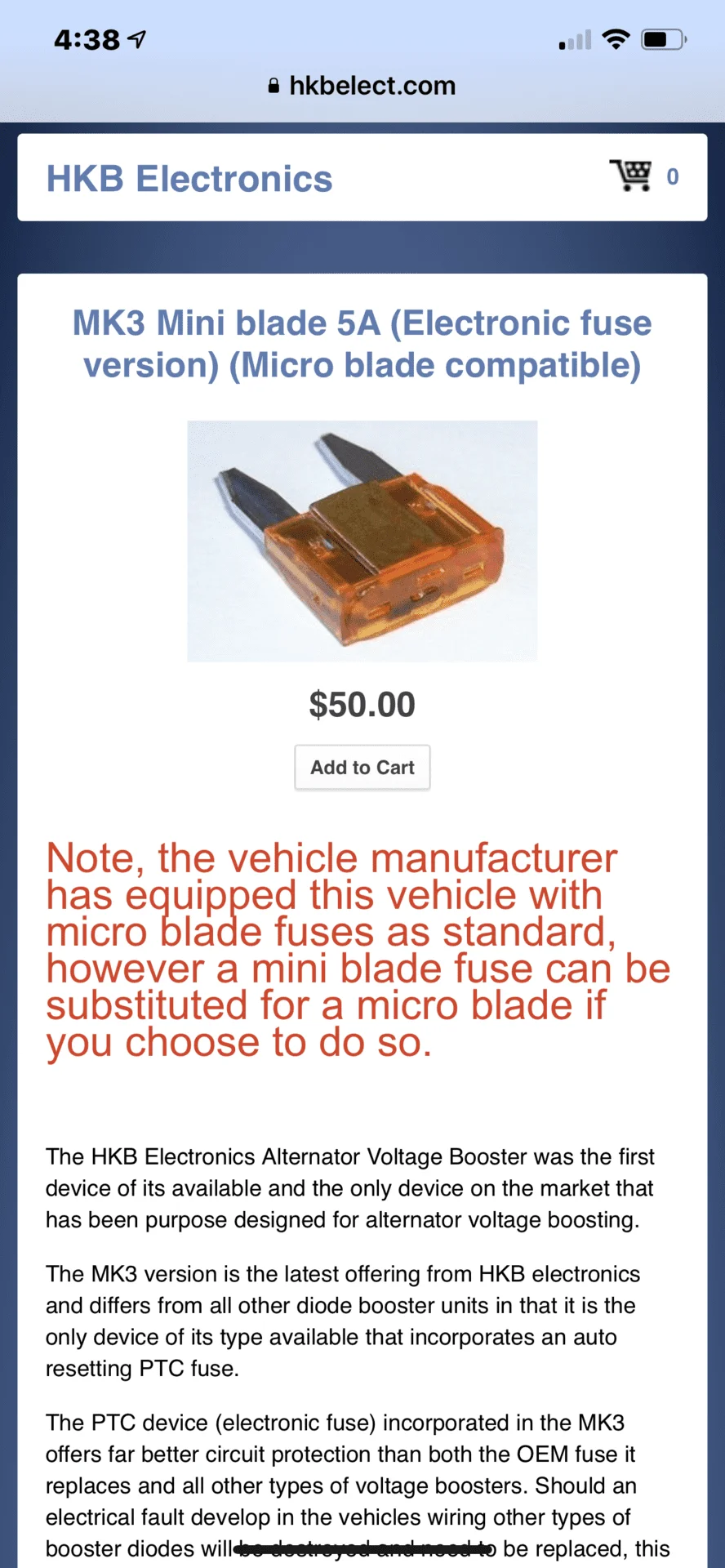

Went with an AGM and put a diode in the fuse box to get the higher charging voltage. So far so good.

Also, worth mentioning, I went this route as I have a dometic fridge in the trunk drawing off of this battery. 100 ah, fridge probably drains it to 50% after two days of no driving. Carrying a jump pack as a backup. Not perfect, but havent run into problems yet. Just an excuse to explore the areas that you camp in once pitching the tent.

I have a yellow top 27f $300, stock it was charging around 70 percent. With fuse booster it’s a bit higher, maybe 85#. I had to buy a maintainer $70 and plug it in every few weeks. Ok for me as I’m going down the mod road. For stock why mess with the extra cost and complexity?

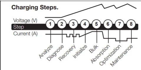

Here's a snippet from the Noco charger manual. What's happening is that the charger is stuck between bulk (6) and absorption (7). Notice that the charging current significantly tapers off as it enters the next stage. A healthy battery should be able to maintain voltage (voltage graph above steps 6/7) as current is reduced to indicate to the charger that it's charged. That's not happening with your battery as it's no longer able to support charged voltage and it is drooping as soon as current is reduced. Which the charger is seeing so it never enters the next stage assuming more bulk or absorption charge being necessary.
Thanks, I really appreciate it. And your explanation aligns with what I was assuming might be happening based on my searching.

I'll try and dig up the website, but somewhere on mud there is reference to an australian website that sells a fuse with a diode in it that you put in your charging circuit which tricks your alternator into charging your battery at a slightly higher voltage. This is more in the ideal range of what an agm wants to get fully charged.
What does the diode not work on 16+ ... ?
because the alternator is controlled by the BCM, not a separate charge sense circuit and fuse. So can’t be easily “tricked” into charging at a higher voltage.
