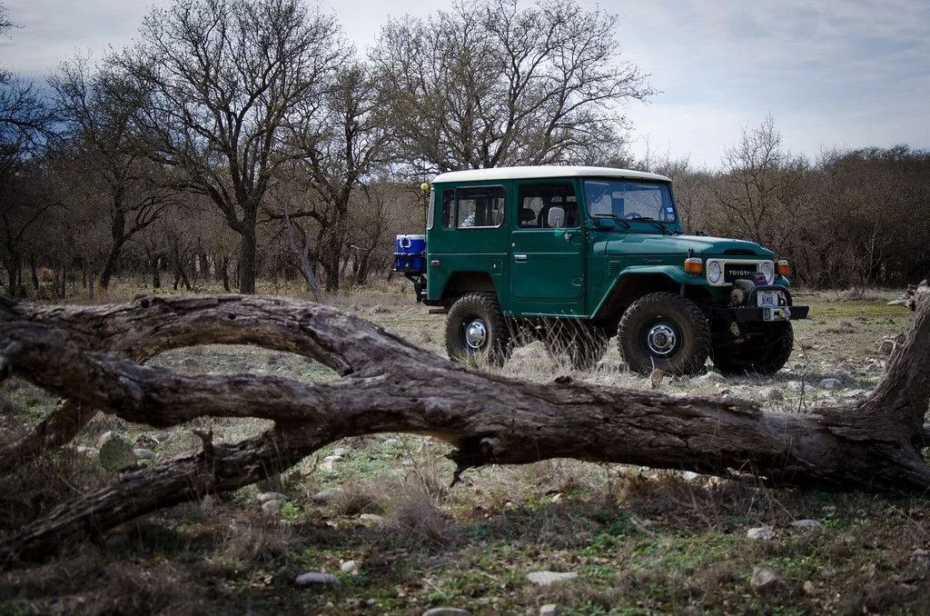

What would that look like do you have a picture! Thank you!

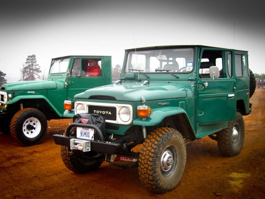

Mine with that combo, and a 3" lift:
Could I do same size without the lift?
If your rear quarter panel wheel wells have not been cut, 33's would rub the sheet metal if the shocks move very much. Most people do at least a 2-1/2" lift to run 33's. Oh, and some previous owner cut my wheel wells; notice how they are not smoothly rounded any more.

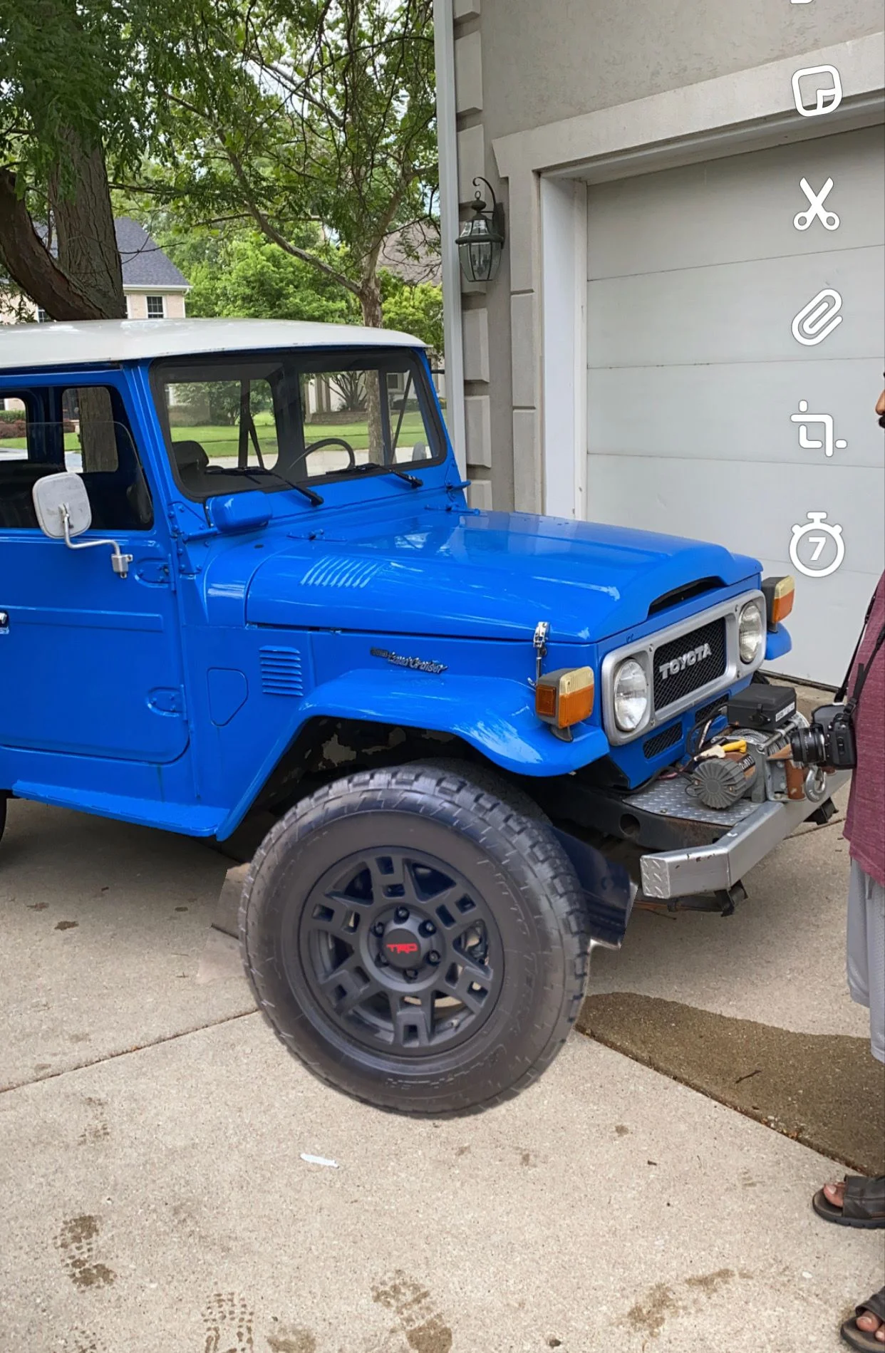

thinking about getting these 18 inch TRD with as big of a tire I can get on them without lift.

After seeing the shape of this one I realize it's not the one I want to spend much on I want to use this to learn everything I need to know about the fj and than buy one that's in good shape to spend money on
I said I am planning going larger on the wheels though :/
a larger wheel with smaller sidewall will make the ride of the 40 worse, no matter how the new wheels look.
