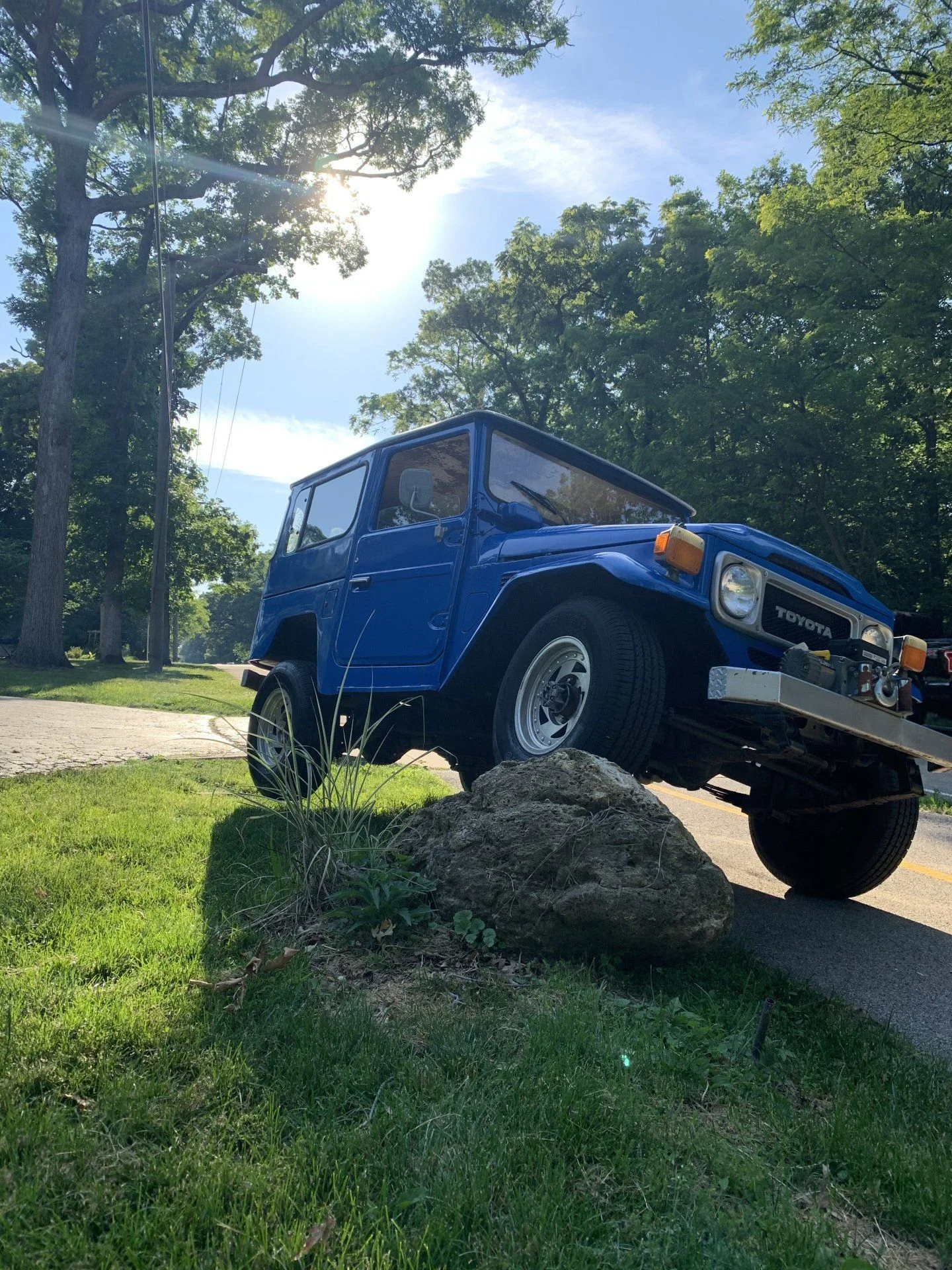

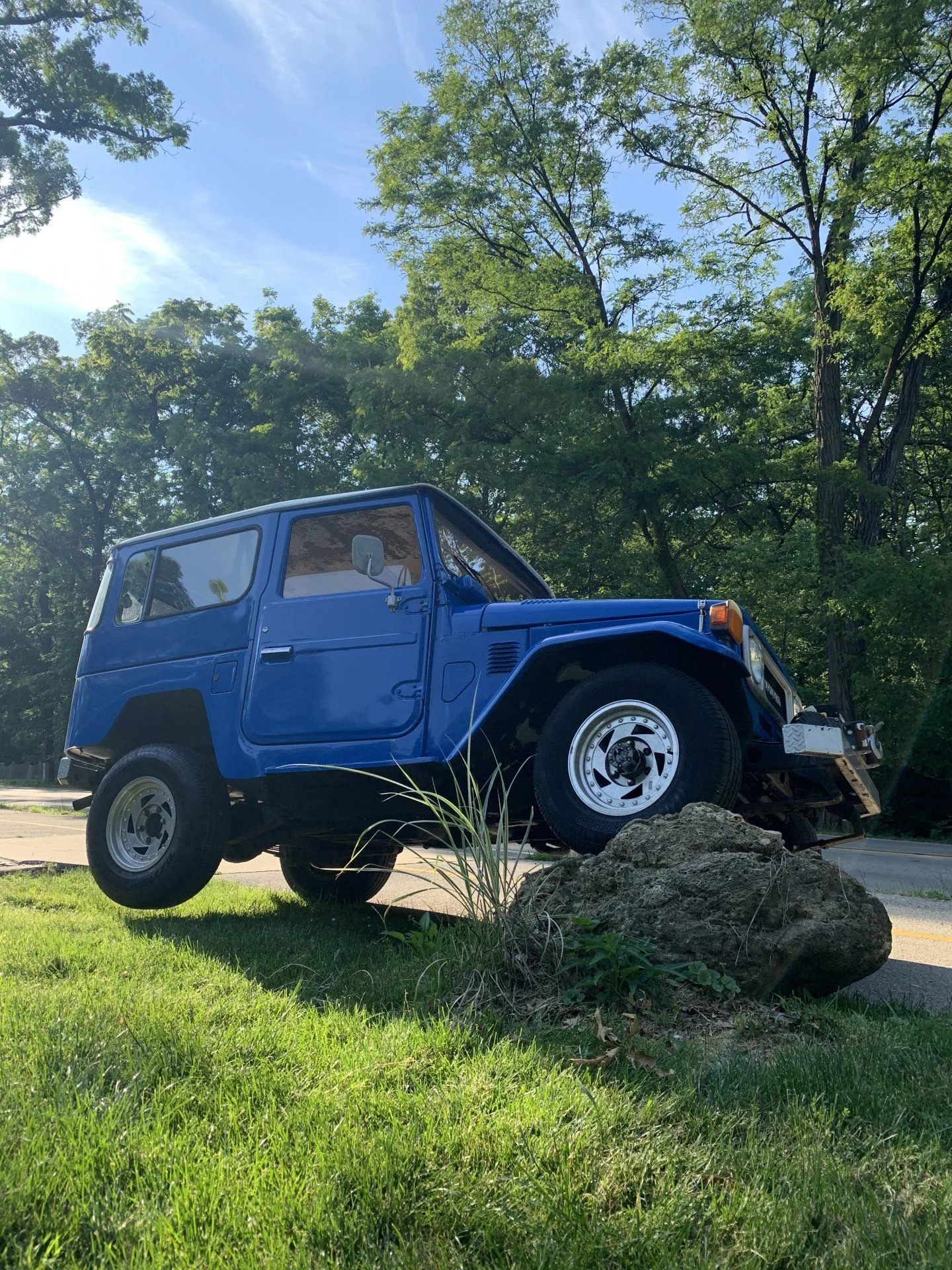

update FJ Family! Bought this instead for $10,000. I want to swap the motor/trans/suspension on it. Could you guys tell me what my best options would be if I want to daily this. Want it to drive smooth at 60-80mph.
they'res nothing wrong with dailying a 2F H42 at all.....i average 150 miles a day with mine.
suspensionwise, you have two choices comfort wise, terrible and not bad....it's a short wheel base leaf sprung vehicle, it will never be smooth.

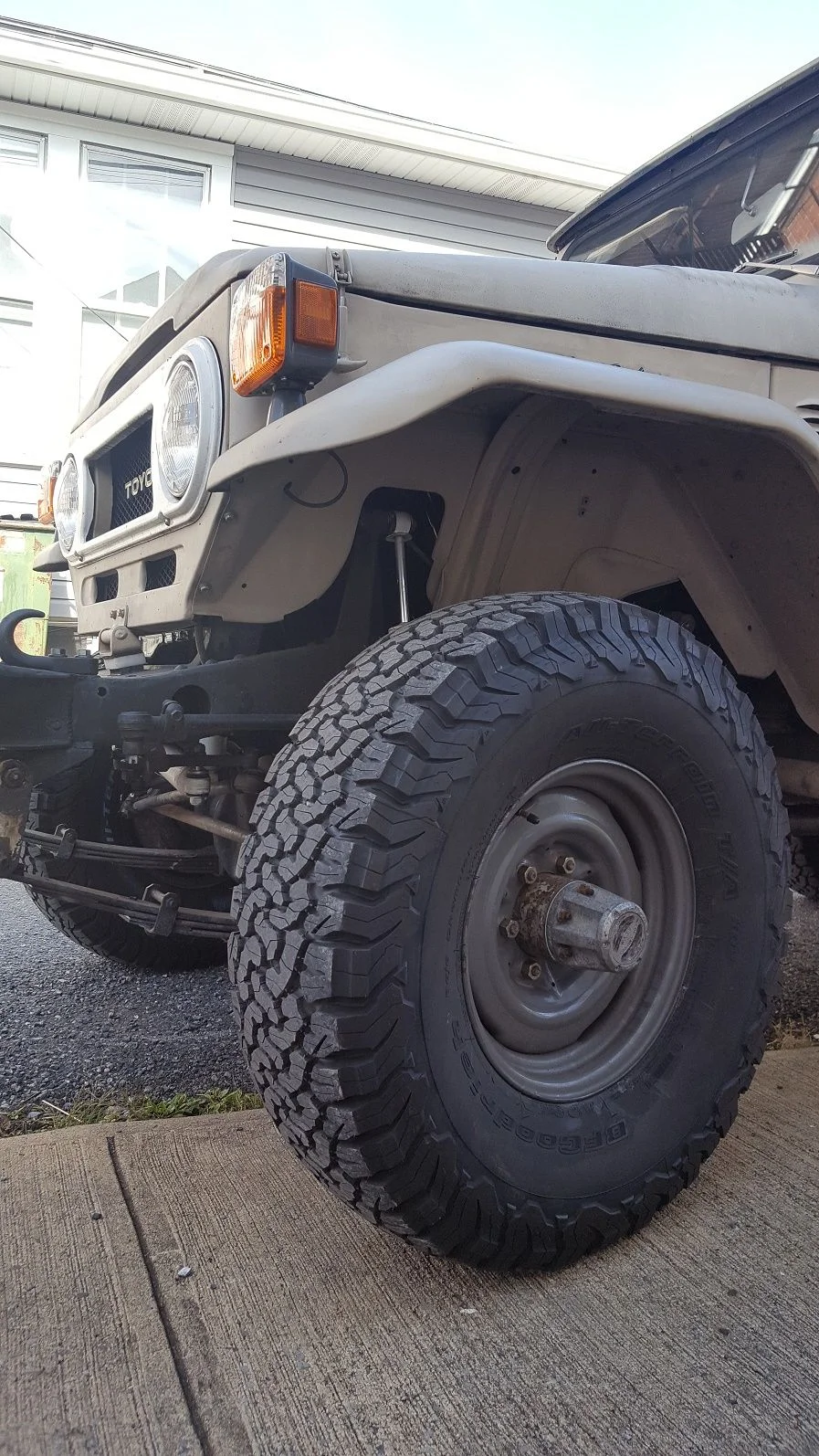

Made it home!! Guys what's the biggest size tires I can put on the stock wheels and what are the biggest rims on I can put the stock suspension?
Those are not stock wheels by the way
You'll soon discover 80 mph safely is sorta unrealistic. Ed
