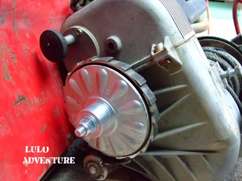

Warn 8274 knob
Anyone looking for a replacement knob for the old style 8274 check out Amazon. They have a 2 pack Gray Part #2-218-300 that looks identical to the original. You can search 3/8 16 female thread knob and see other selections too. Someone in the link previously confirmed the thread type. Have not bought them yet but will soon. Just saw one on eBay for $34.99 BIN.

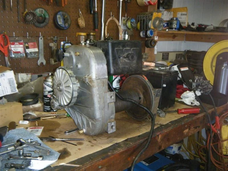

Just finished reassembling my $200 8274. It came complete with with remote, functioning solenoids and cable for that price, and looked decent on the outside, but the inside was at least as bad if not worse than Flintknappers.
I didn't bother to clean well enough to clearcoat or paint, wasn't worth the time to me.
Thanks for starting this thread, Flintknapper! I also copied your method for adding grease zerks to the drum end support.

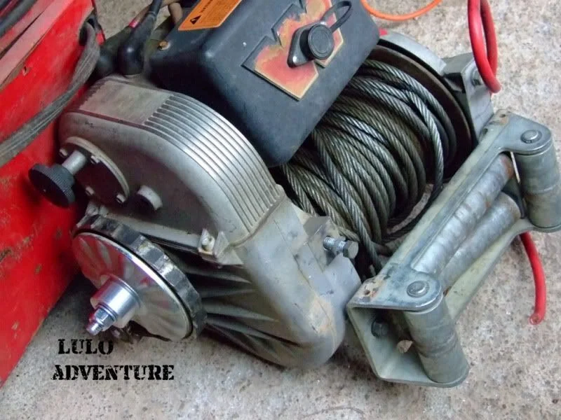

THANKS Flintknapper for this great thread. Finished the rebuild of my 32-year-old 8274 and it works great. Even though the original Prestolite motor still worked, I went ahead and replaced it with a 4.5 hp motor from DB Electrical.
Before picture:
After pictures:
