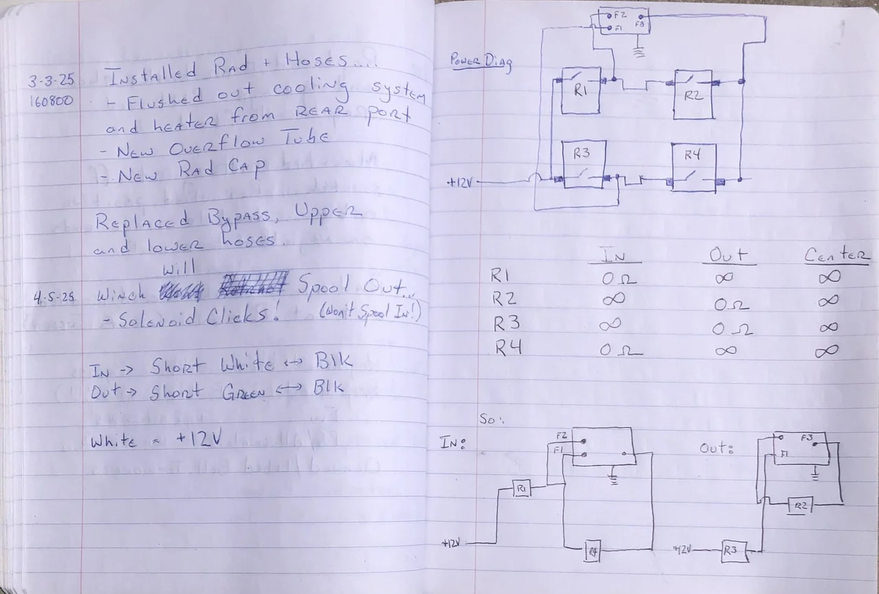

Can someone help me understand this wiring diagram?

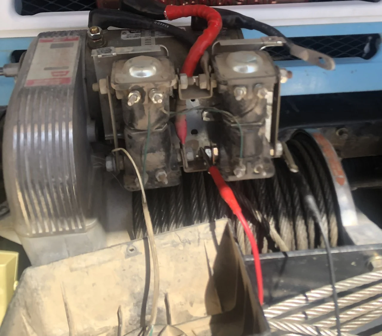

Looks like all my solenoids work (and I hear them click)…. bad motor windings?
Thanks -
Rocky
Thank you - and that is what I am seeing on the solenoids.
It looks to me like my solenoids and wiring are connected correctly…. I was winching for about an hour and the spool just stopped going in.
I’m pretty sure it’s in the motor, but don’t want to pull it if there’s something else I should check.
I’m also curious about the circuit inside the motor housing,,,

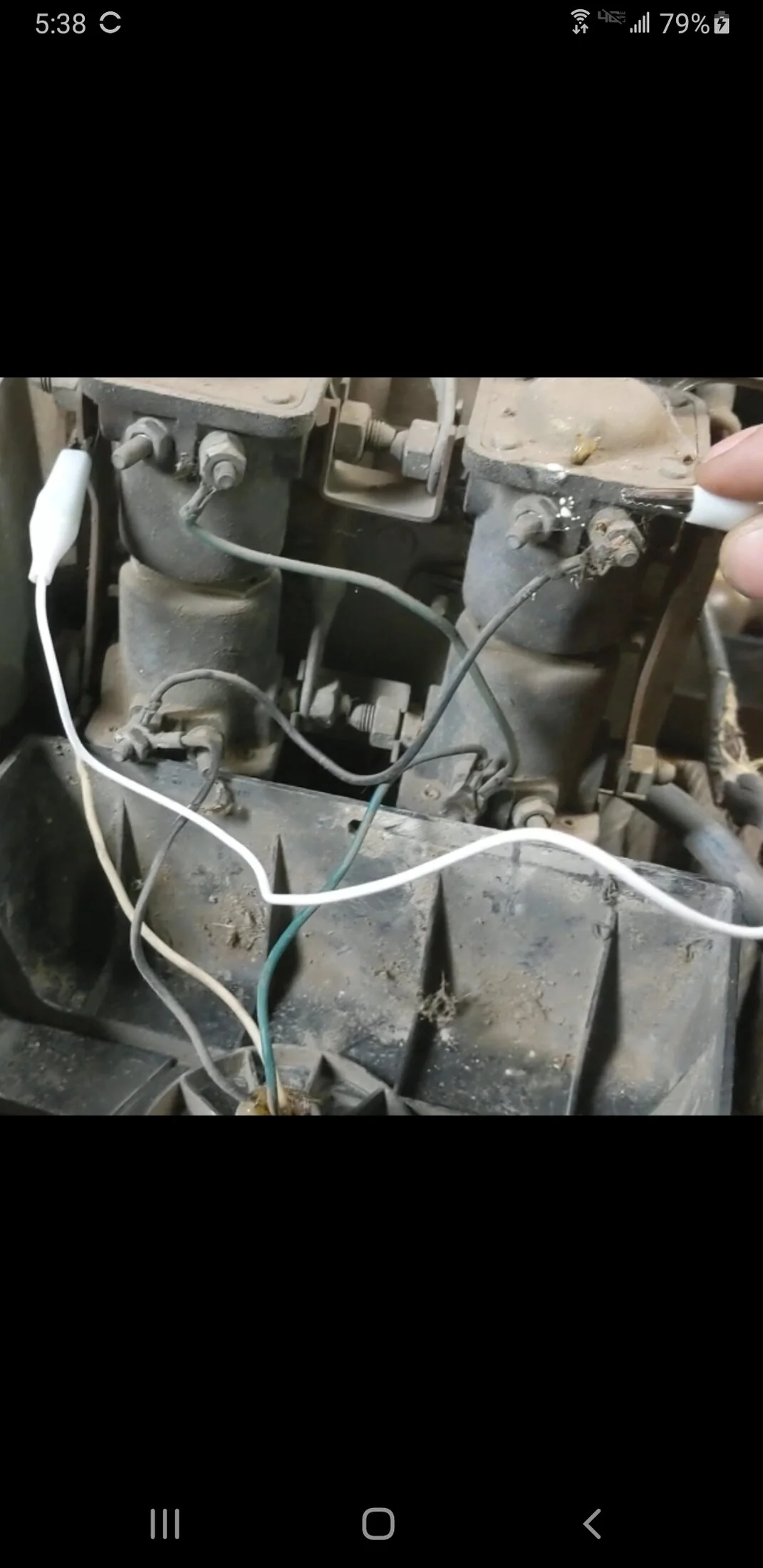

agree, test the motor first. Here is a simple way. I use jumper cables from a battery to bench test winch motors.
You might be hearing one solenoid click but not the other. I’m betting on one bad solenoid.
