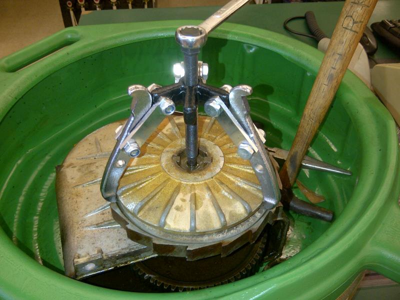

Thanks Flintknapper so much for this thread it inspired me to pull the trigger on and clean up a 8274. I too found that the hardest part was removing the brake assembly. You mentioned taking some emory cloth and sanding down the shaft. I think this is very key, even before trying to remove the assembly. Mine was an 83or93 model and there was some rust. I ended up taking mine to O'Reilys Auto Parts and they just let me work on it there on their bench.
I used the 3 prong puller. I think it was the 2 ton not sure. I cranked on it so much, I was sure it was going to snap the aluminum disc in half. It was all or nothing at that point and what I found worked was hitting the tension screw? with a hammer. Not hard but I kept tapping until a very loud noise happened. It only moved it about 1/8th an inch. I repeated this process 3 times until it finally wrench cranked off.
Just my 2 cents, I hope it helps someone.
I took my winch into their store in one of the oil drain buckets and struck up a conversation with the people there. Just an idea, but if you have a relationship with your local parts guy... they might let you use the tool there for free.
