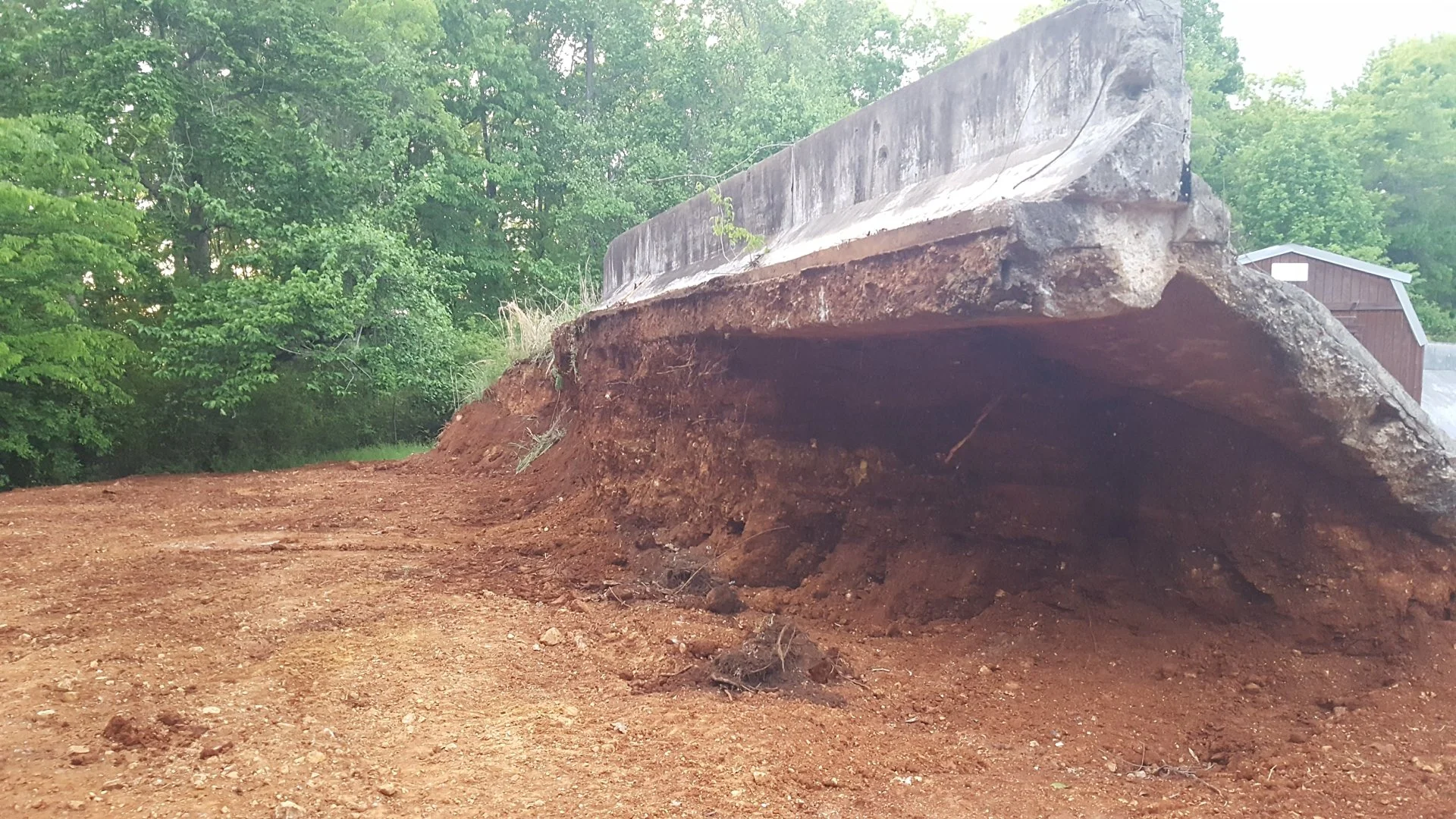

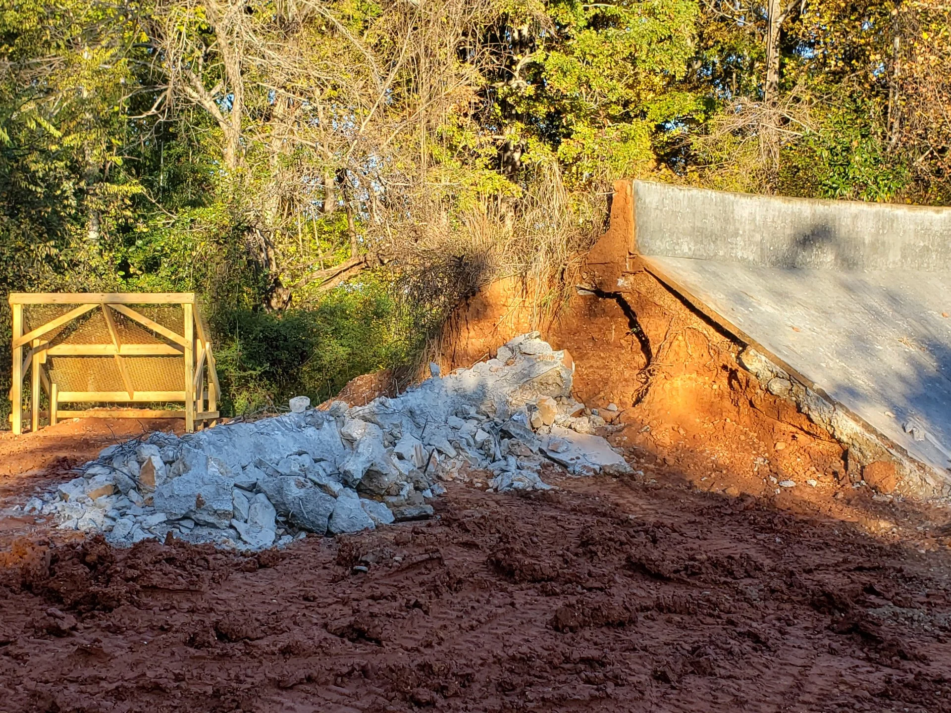

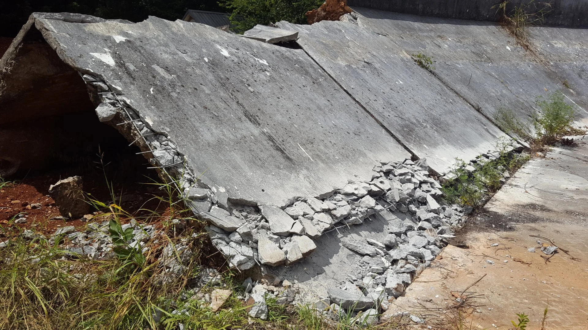

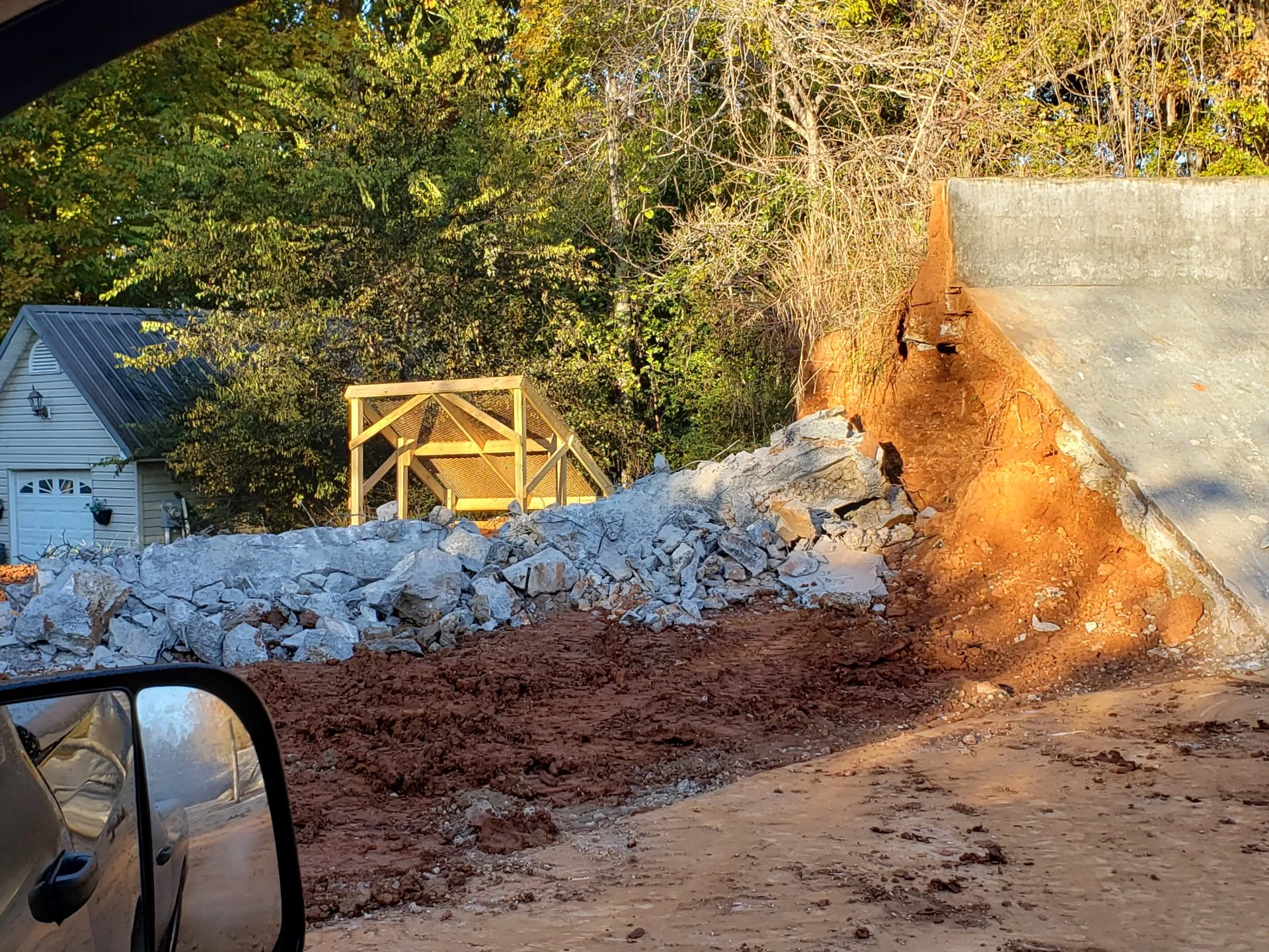

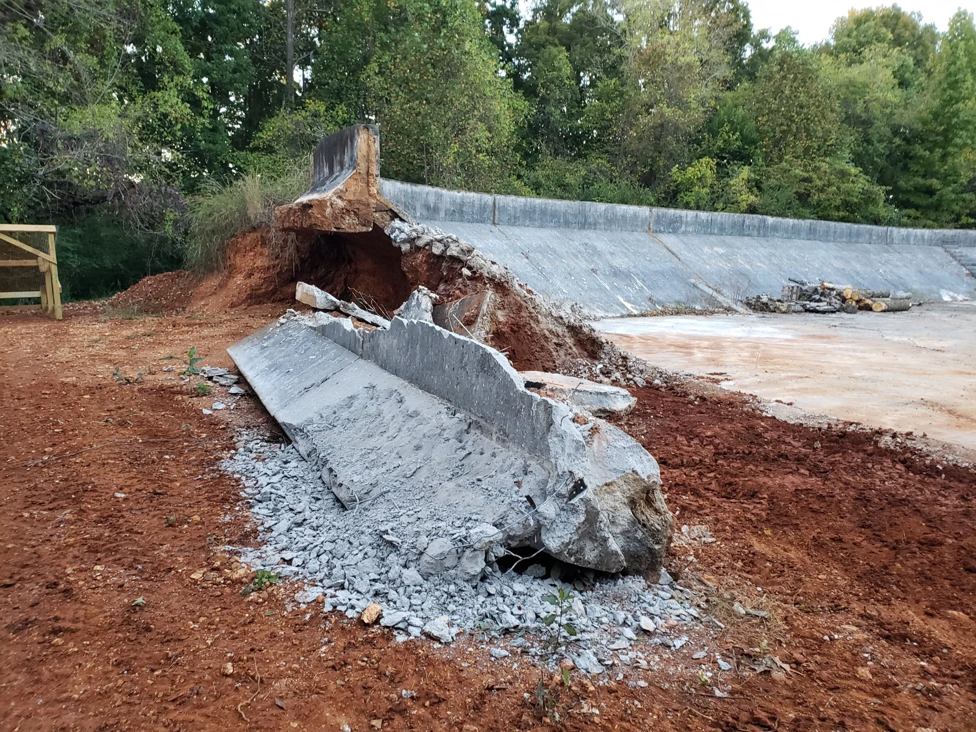

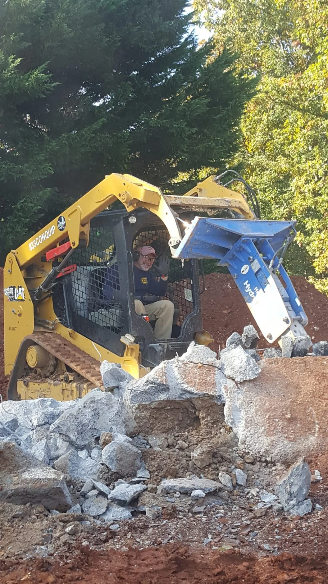

Here are some pics of demoing some of the reservoir wall. There was already a gap the PO made to drive in there. I built a leanto in there last year as a stop gap.

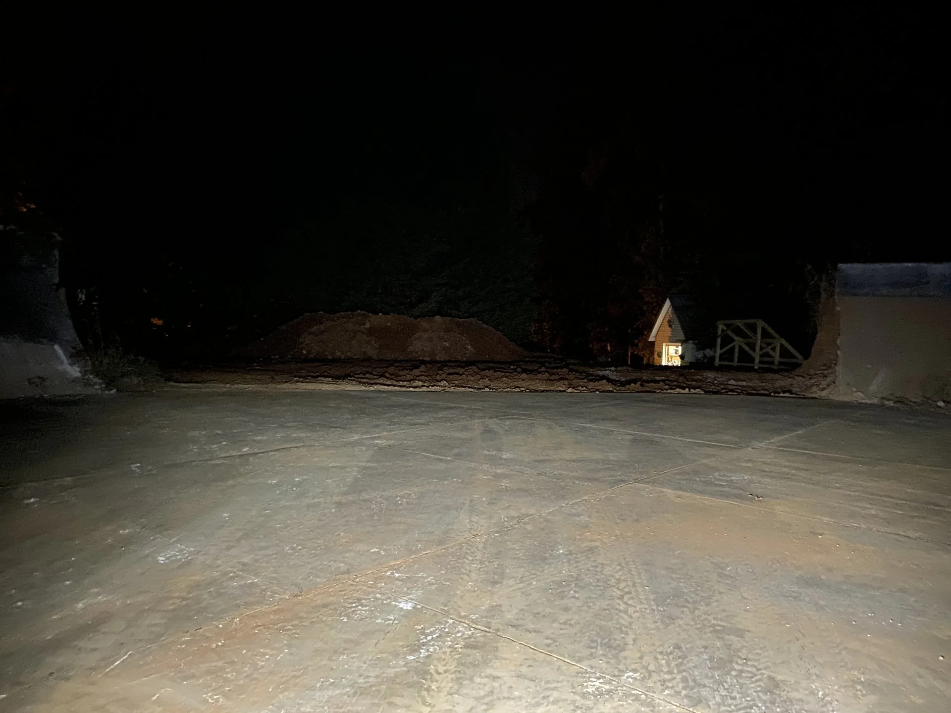

And this is where I am today around lunch.
It seems getting craftsman to show up is the biggest battle but my guy has been Johnny on the spot. I hope it turns out as good as some I have seen him build.

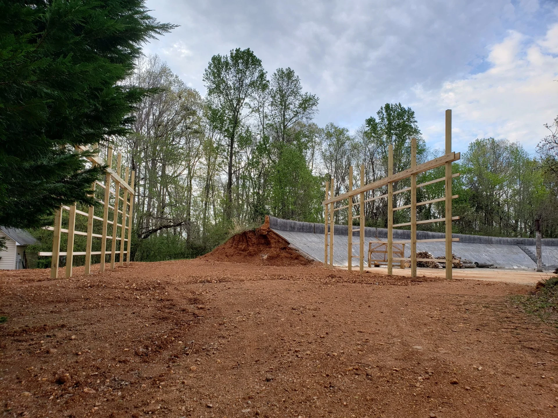

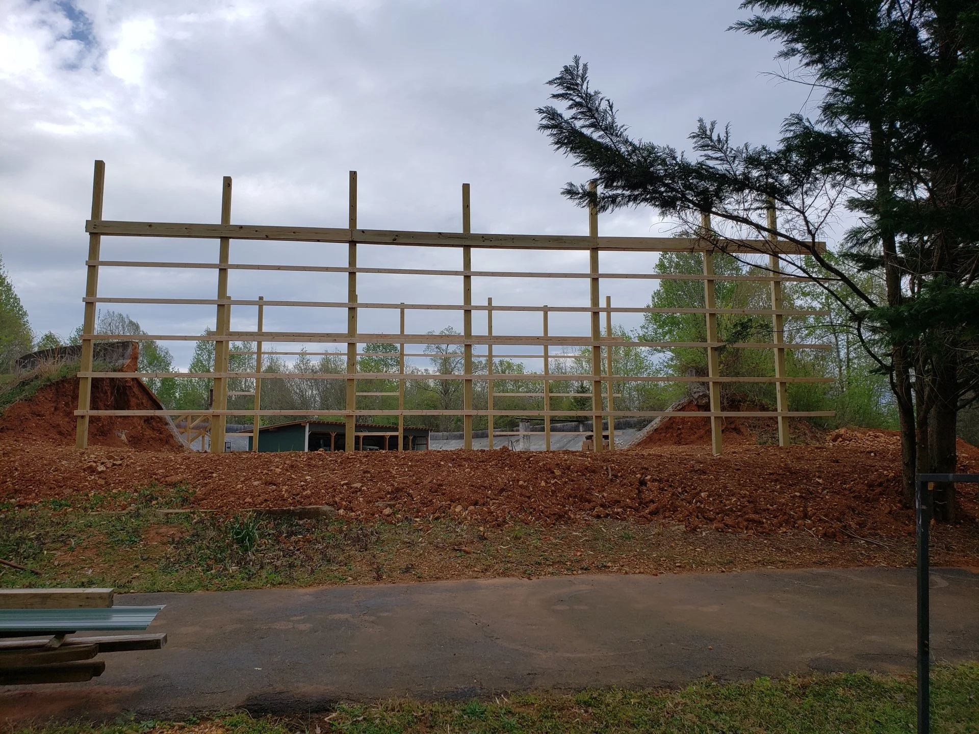

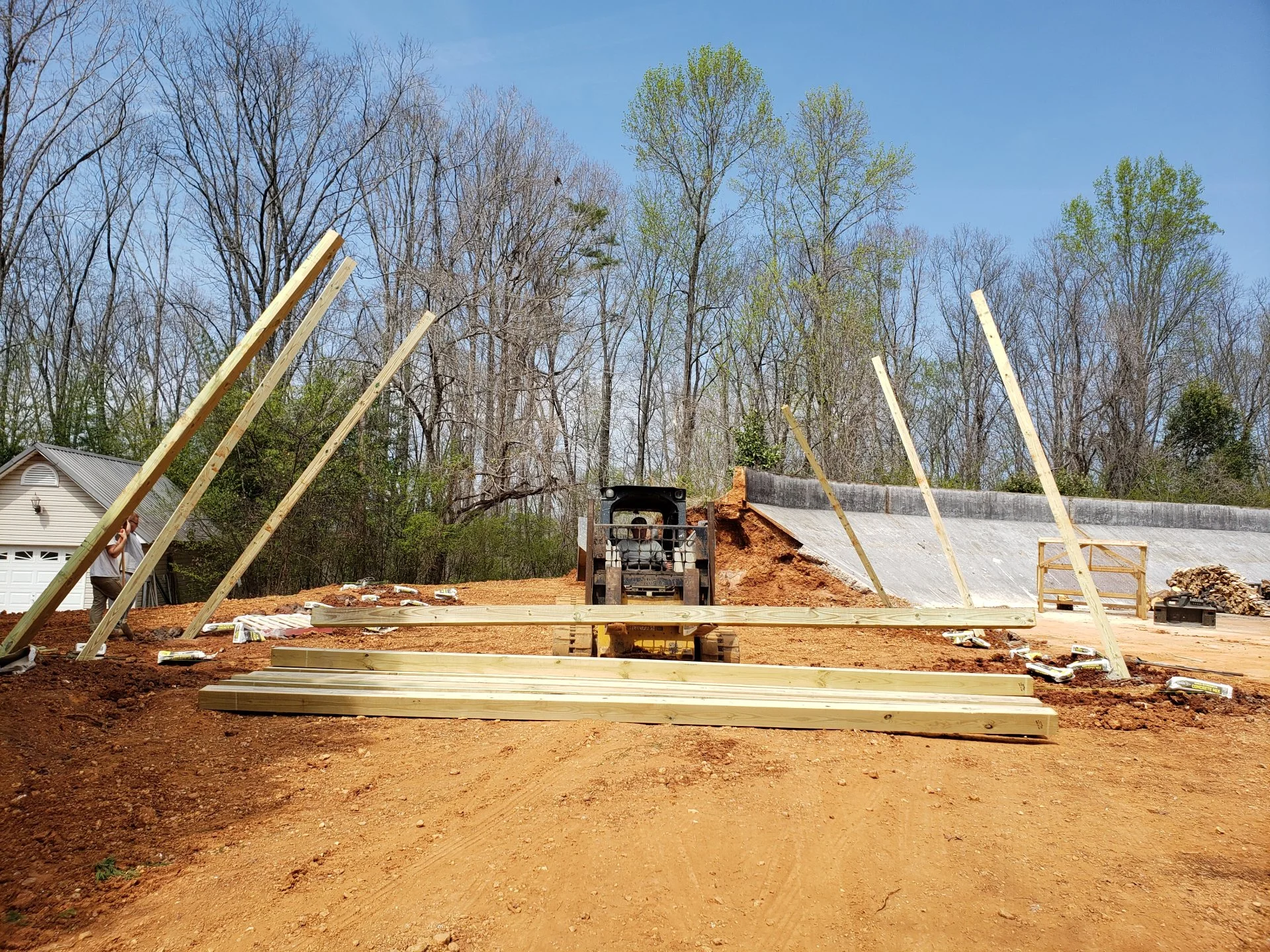

Posts are set.
He is going to let the concrete set up and then be back in a day or so to start doing girts, then trusses, then endwalls, then concrete, then metal, then doors and windows. Should be done in about 14 days if the weather holds.
