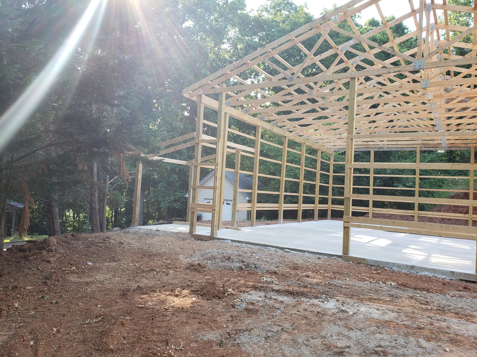

Funny you say all that. The guys were here before I left for work and we had a talk. Concrete poured.
Mrs Heifer and I went out there and have no idea where the extra is. I will have to talk to the contractor and see what he did. He said he was going to measure it to ensure it was in line with the door and where it needed to be blahblah but there is not a mark on the ledger or anything. So it goes. :meh: The heaviest thing I will lift is the hundo.
But the concrete is poured. I am to happy with the progress to worry about it.
He did a 1 inch drop to the exhisting slab. The side door may not be used much but I plan to grade that properly and put some gravel down.
I am happy and excited.

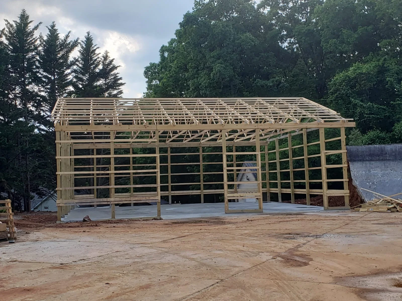

That thing is shaping up nice. Good for you! New concrete flatwork is one of the most satisfying things ever!
Keep on keepin' on!

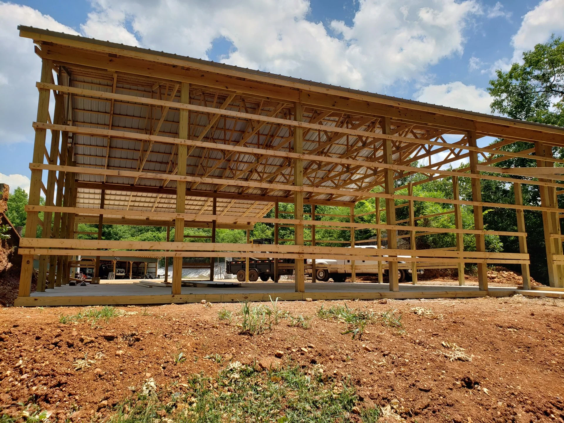

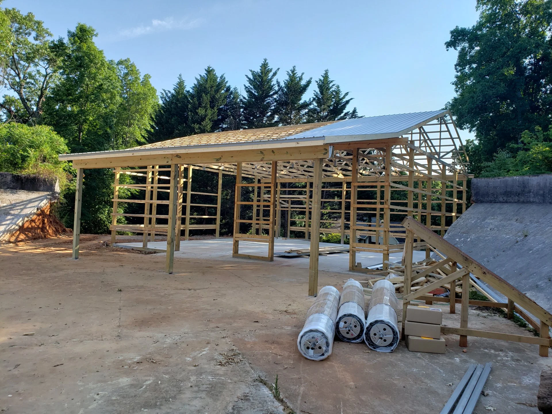

I expected the guys yesterday to finish framing the leanto and porch but they were a no-show. Should only be 3 or 4 days of work left max.

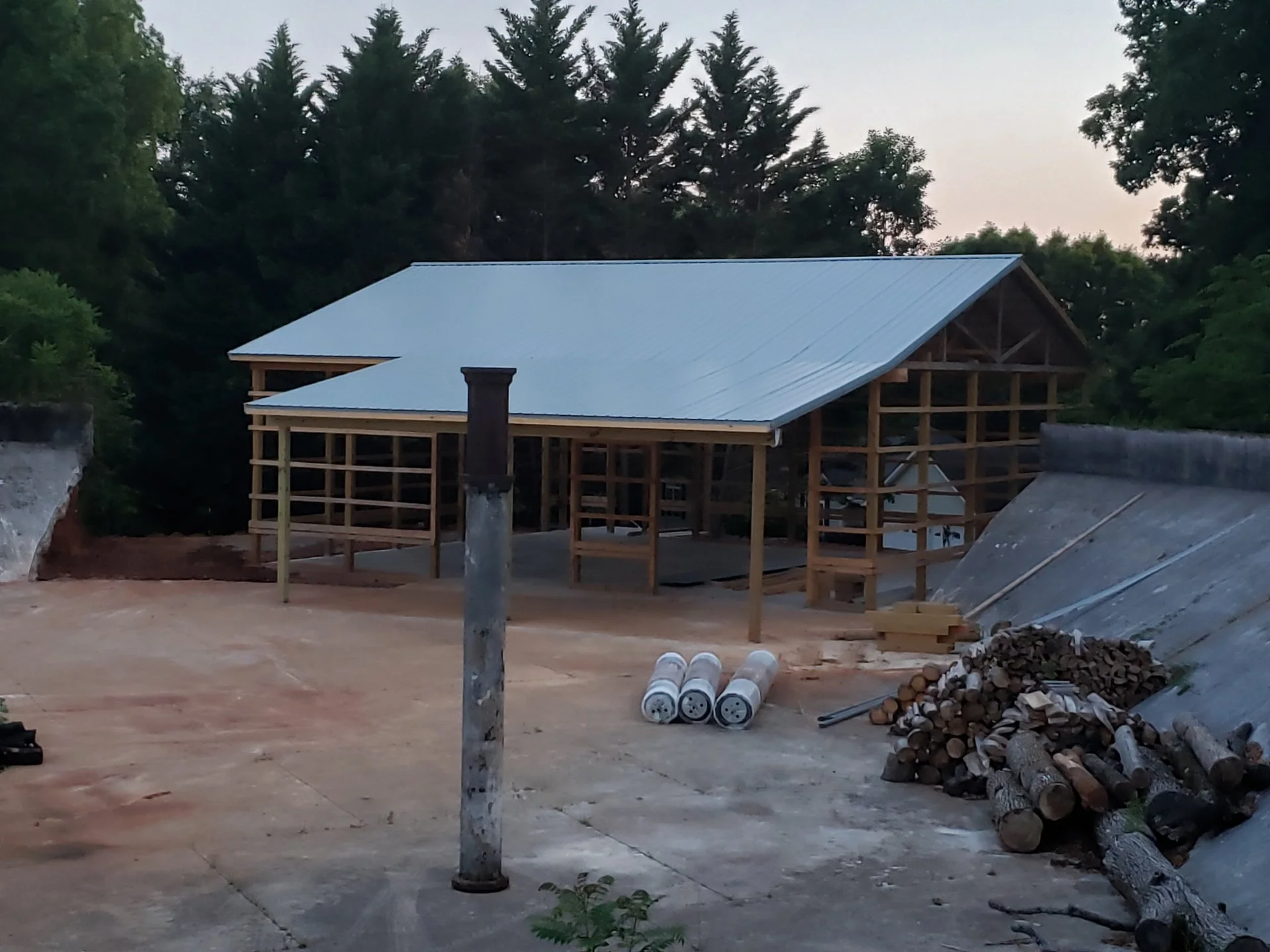

Here is the latest. It is really coming together. They will be here tomorrow afternoon after pouring concrete on a small job to continue the roof.
Under roof.
Builder says if we get rain next week he will be here to put in doors and windows. If there is not we will not see him as he has some other stuff going on that need the attention of the good weather.
Pray for rain in NW GA!
