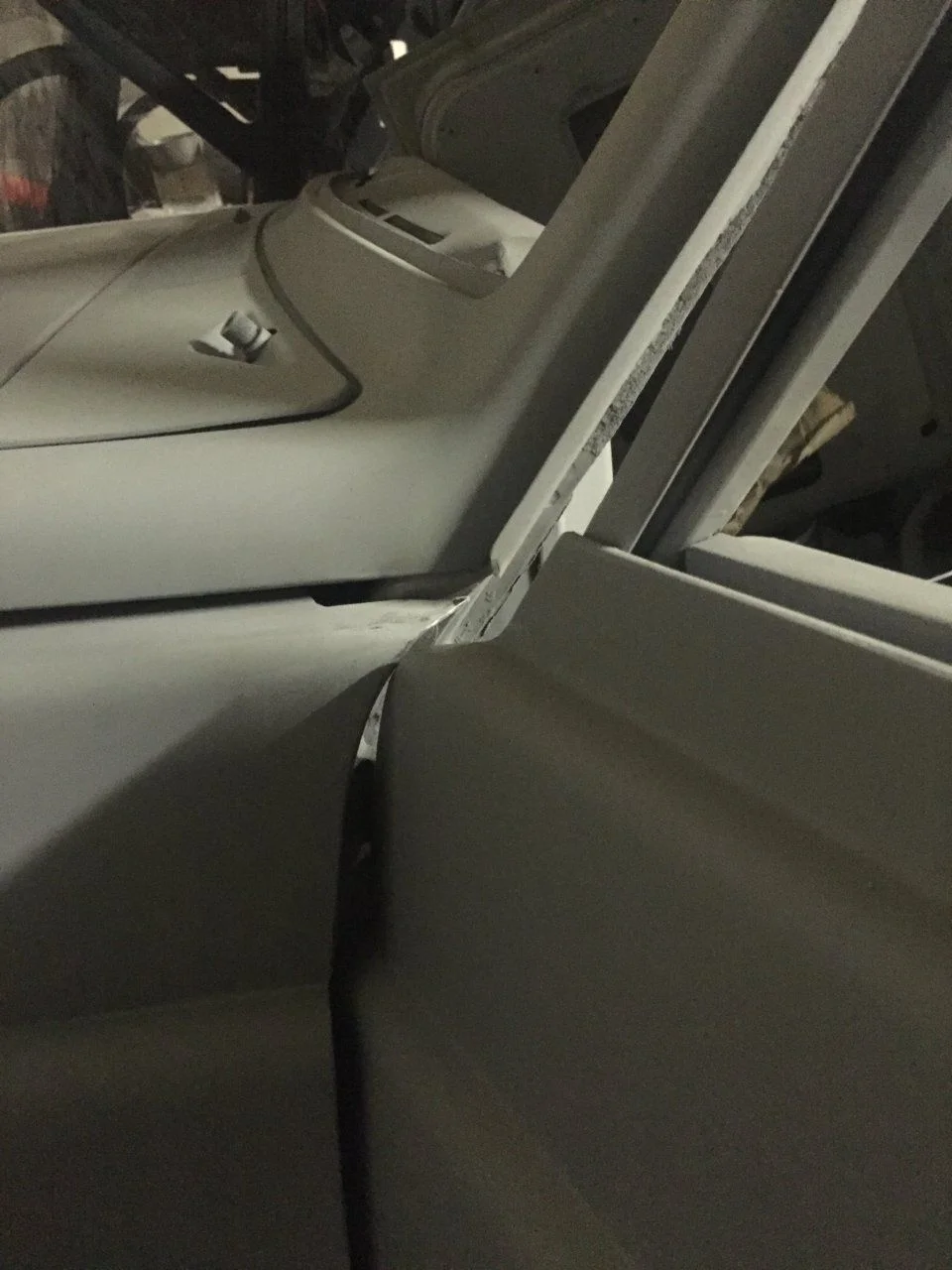

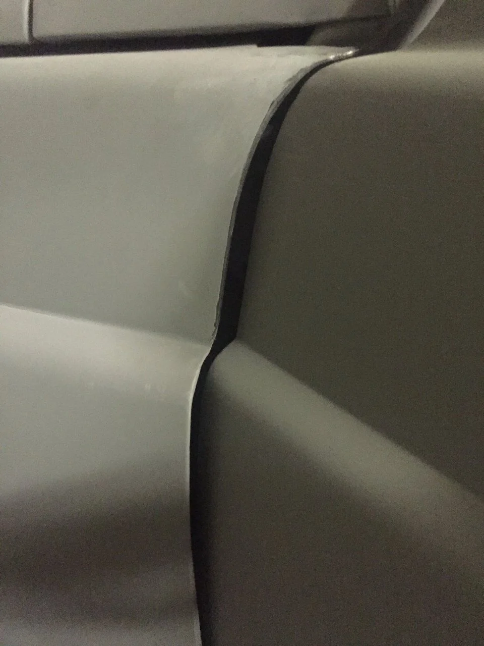

Thanks Ron. I was looking for a picture higher on the door. In that spot I have good clearance. I straightened the metal at the top and now think it should be bent for clearance. (I need to give up on show car gaps and lines)
Ya you have too. Damn things didn't come from factory as nice as you guys are making them. They'll deduct points for originality.
I had the same battle with my door hitting the upper fender. I ended up grinding on the contact point on the fender and slightly bending it up on the radius. It didn't take a lot of work or really effect the line of the door and fender. Count your blessing , you're still in the primer stage. The worst part was that I had the finish paint on and had to make the repair and re-paint.

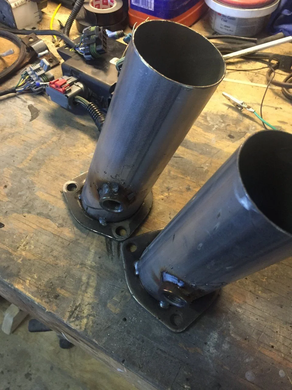

Today I stubbed out the exhaust so I can install O2 sensors to minimize the potential codes and issues with start up. Next, figure out the minimal fuses and wiring needed. I think all I need it to hook the EZ Wiring harness keyed pier to the engine relays, run a wire to the starter and fuel pump. Then turn the key?

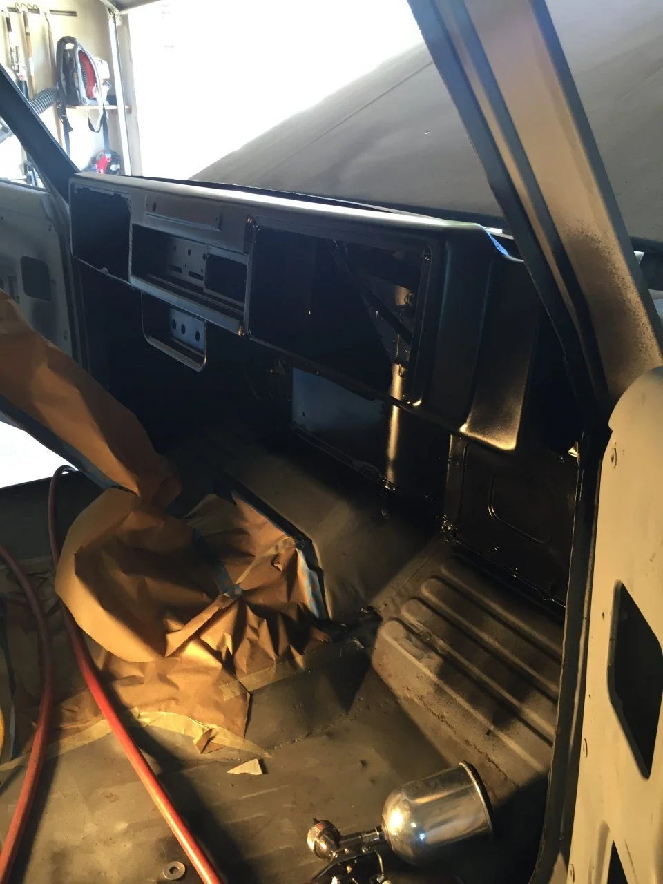

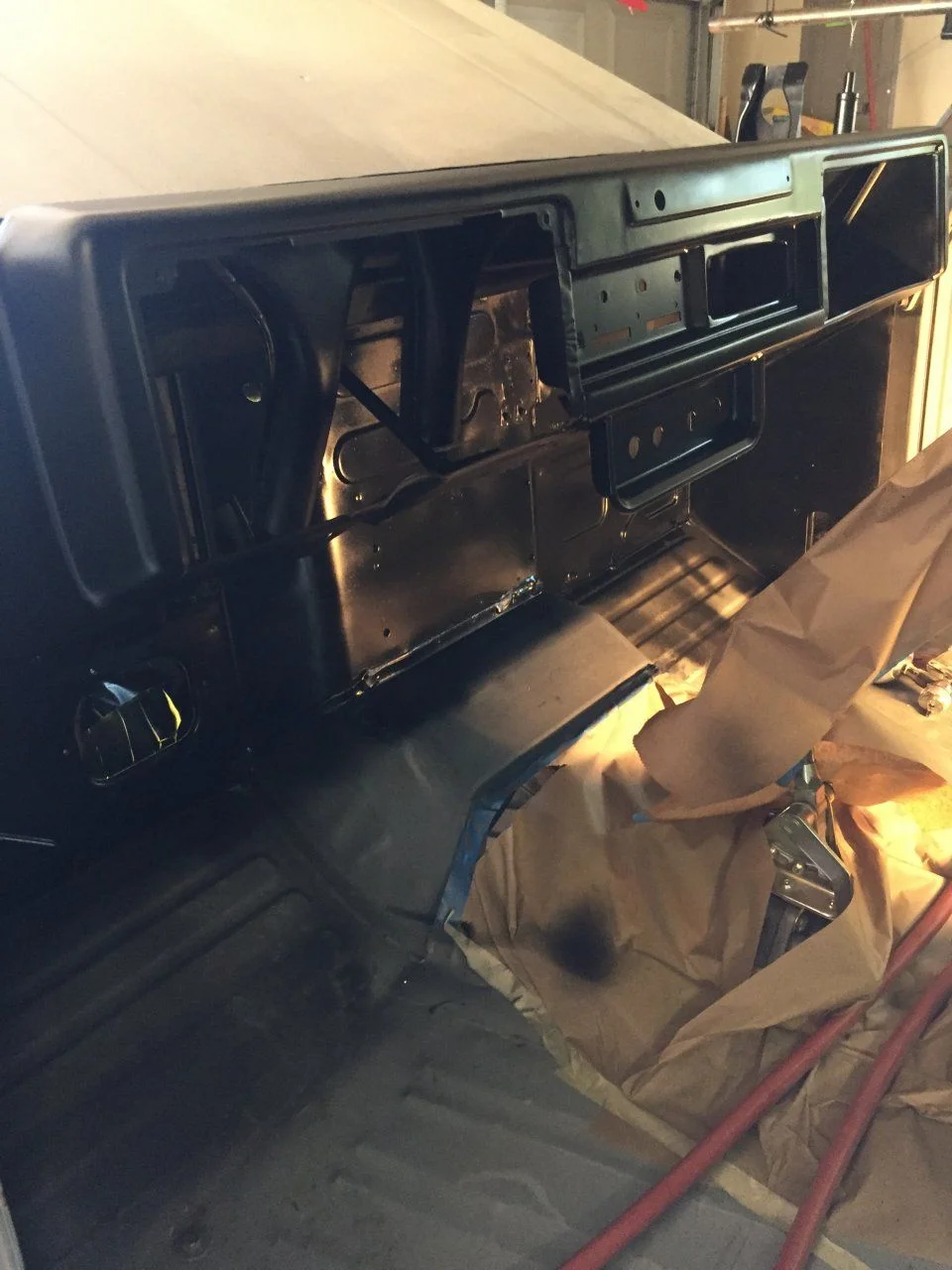

Pulled my temp wiring out to paint the dash and inside firewall. Now that it's in paint, I can start to mount things a bit more permanently.

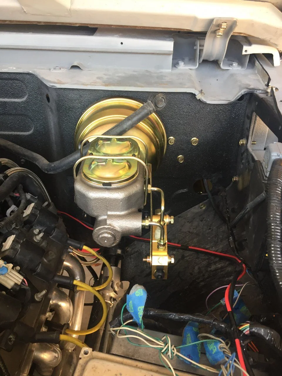

I need to figure out my direction on a brake booster and master. I saw a BTB combo set up on the classifieds and got to looking. I think I can piece it together myself from eBay for about $140 shipped vs $329 price they want. I'll have to drill holes in a different place for the booster but I'm not sure that really matters.
Staying with Toyota options seems a bit pricey for little to no difference since I'll need a booster, master and a proportioning valve.
Next get a driveline lengthened and add a double cardan joint. I'll wait on the front for a while. I'd like to see if I can get a smaller diameter driveshaft to provide more clearance for the transmission pan. I think I've got enough to avoid any pan mods but I'm crossing my fingers that adding the cv joint won't crowd it too. Inch.
So I went the GM route on a booster/master cylinder. I was able to gather all parts for about the price of a reman Toyota booster from the local AutoZone. The trade off you make when you're semi-retired.
I did have to drill different holes in the firewall, but nobody sees them so it doesn't matter.

Looks good! Will the clutch master bolt up with no interference? How do you like the top of the dash after cutting the seam? I like the clean look of it with no padding.
Not sure on clutch master but I'm automatic so I plugged hole and left bolts to hold pedal mechanism. It should clear. I'll check later just to let others know.
Yes I like the clean dash so I copied your idea. It would be different if we could buy the padding.
