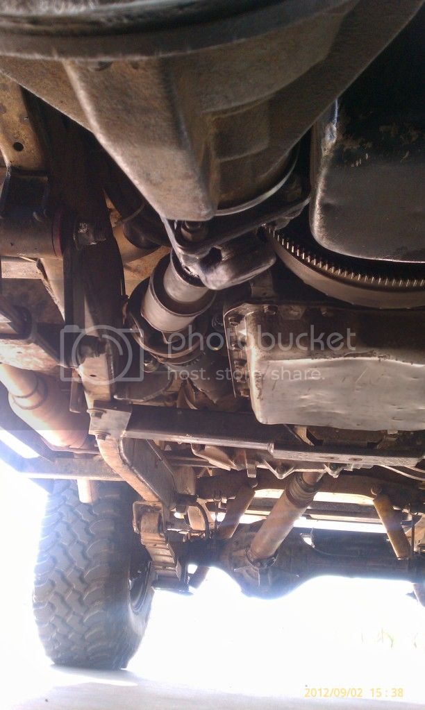

cool build, the FJ60 steering box pics are very helpful! Curious to see your front driveline clearance with the auto trans pan....mine is close
Mine is close also! In theory, if it clears on the top side, there's not much movement to worry about. We will see.
I'm going to ask when I have the driveline work done of they have an option with a smaller diameter CV-type joint. I clocked the front driveline for a CV at the transfer case but Not sure how it'll work out.
I didn't realize how wide a Auto trans pan was when I ditched my SM420 stuff to put in a TH350.
I might go down this road: Two piece front drive shaft in a FJ55 - Pirate4x4.Com : 4x4 and Off-Road Forum

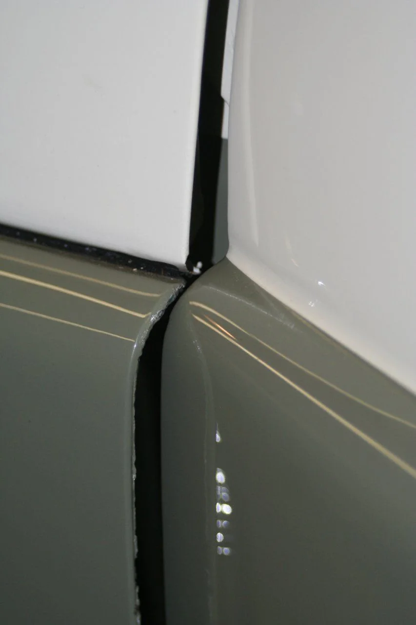

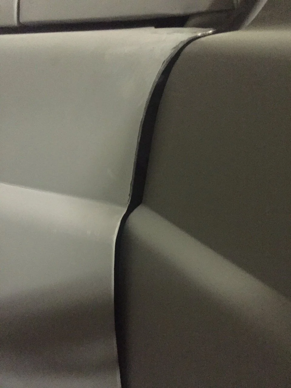

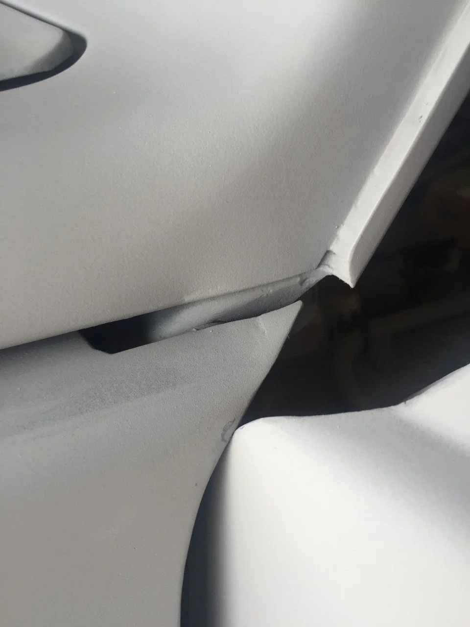

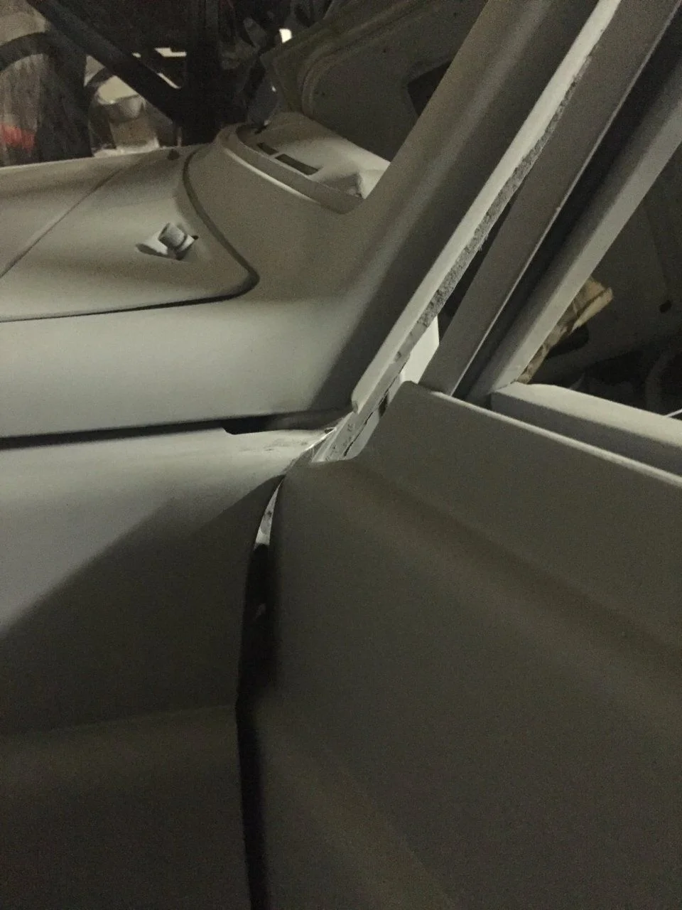

My paint guy quit early today. This time frustrated with the the fab guy.

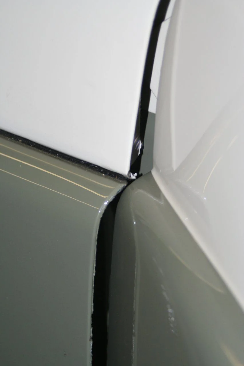

He was frustrated with the door alignment which causes the door to hit the fender when opened. After thinking this through he thinks the fab guy shouldn't have welded metal between the original cracked metal off the door and the hinge.
So the extra metal can be compensated for in the closed position by positioning the hinge a small amoun to the fron. Of the vehicle, when the door is opened it hits the fender. Seemingly caused because the hinge is position toward the front.
Thoughts anyone. I hate to go back to the fab guy, but I think I need to. The base of the hinge isn't thick enough to just mill it down to make up the difference.
Am I missing something? I've fought with door alignment forever. You can see my pencil mark wher I just want to notch it and move on but the door line would look really pathetic.

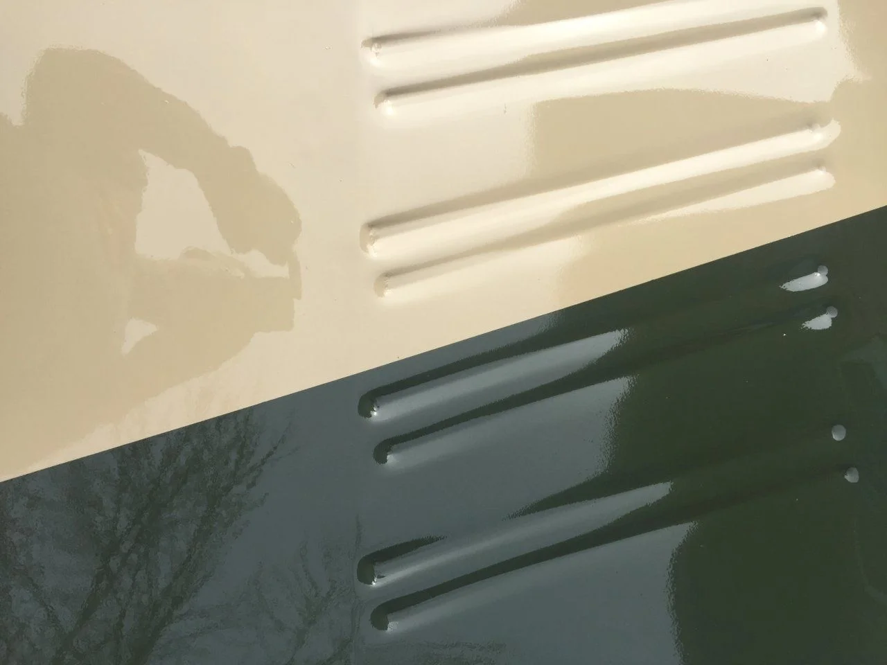

The paint guy then moved on to shooting a test panel to confirm paint colors. Both
Toyota colors. Army green from FJ Crusier and quicksand from a 4Runner.
View attachment 1212522 View attachment 1212523 My paint guy quit early today. This time frustrated with the the fab guy.

Looks like you are a little tight on the gap across from pencil mark. File a little out of fender and door.
NikP,
I'm with Bob.
I welded in hinge support plates on my doors and don't have that problem. I can't offer any good advice, but can't the fender move some. It's not going to take much. I'm starting to accept the idea of it's " Just a four wheel drive " and like you, fix the problem and move on.

You need to adjust the top of your door in, the fender should be proud and the door should be just inside looking from the front. From your photo it looks like your door is proud. loosen the hinges at the door not the jam and push it inward.
Don’t worry about the window frame until after you get the lower half of your door adjusted. Closing it on a folded towel to bend outward or a slight push to bend it inward is all it takes to get the frame were you need it.
Can someone post a picture of a front door opened? I know I'm close but want the satisfaction of seeing one before I lose my senses.

Here's some of mine. It's close, but doesn't touch. The fender has some Lizard Skin or Monstaliner showing on the edge also. I couldn't get the door to stay at that spot without closing or I would have gotten a better angle.
Thanks Ron. I was looking for a picture higher on the door. In that spot I have good clearance. I straightened the metal at the top and now think it should be bent for clearance. (I need to give up on show car gaps and lines)
