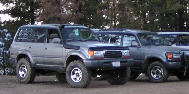

BFG AT KO 285/75/R16 (33 inch tires)
1997 LX450 2.5" Lift
Considerations for Purchase:
I bought these tires before I had the lift and wanted a good Highway/Offroad tire combo that would ear well. Some of the considerations on the tire size were as follows:
- Could fit on a Stock suspension (Now have 2.5: lift)
- Could fit in the Spare Tire location (Now have Slee Rear Bumper.
- Don't need re-gearing. Re gearing payoff seems to come at 35's
Performance:
These tires are great on road. I air them down to 15-20psi when off roading and have had great performance offroad (Includes Moab). These things wear like a tank. I have had them 17,000 miles and they still look new and have seen very little tread wear. In comparison against the Goodyear MTR's on my daughters 4runner, they are much quiter and wear better. Have not been in a situation to determine which one would be better off road, but the AT is a much better onroad tire. I can see the MTR having better performance in MUD and maybe snow (small advantage), but any tire will only get you so far in snow and chains will make both these tires equal.
I also run these same tires on my FJ40 and have been very happy with them.
Recommend:
Yes
Picture with tires before lift:
attachment.php

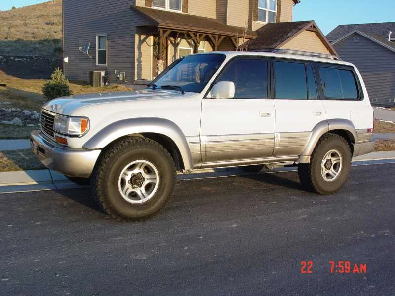

Picture with tires after lift (OME 2.5lift med ):
attachment.php

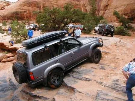

Picture fully loaded with bumpers, sliders, winch, etc. (Added 1" Mr. Gasket Spacers up front)
attachment.php

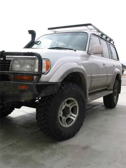

Buckshot Maxxis Mudders
1994 with 4 inch lift
Considerations for purchase:
I wanted a cheap aggressive mud tire that would last and it had to be a 35 12.50"
I picked them up for 115 a piece installed at big chief tire
Performance
You cant hear them when your driving on the street. They self clean beautifully. I have gottent 15,000 and i still have half the tread left. They work good in rocky terrain. I run them at 45 psi and i have them on stock rims.
Recomended:
YES

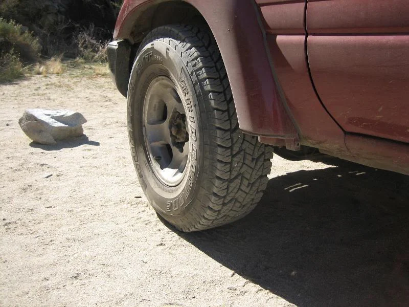

Yokohama Geolander AT 285/75 r16 on black steel rims
Considerations
At the time I purchased it was a toss-up between BFG AT's and these. I went with these because the manager at Discount (a family friend) has them and recomended.
Performance
I have very little road noise that I can hear over my exhaust :cool:
I get excellent traction in the dry rocks and dirt of Southern AZ and have very little trouble with wet surfaces either. I run 40psi street and about 16-18psi offroad.
I wheel on a lot of nasty rocks down here and have lost a few chunks of rubber here and there. I have about 16k miles on them.
They are only a 2-ply sidewall however as compared with the BFG's 3-ply.
Overall I am happy with them and would recomend them.

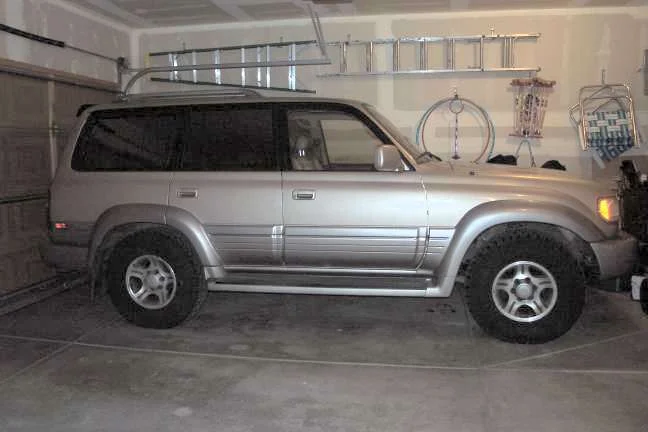

BFG A/T 315/75/16 on stock wheels. No lift.............yet.
Bought used with 60% tread life for a good price. So far so good. The drive is firmer with the 3 ply sidewall which I like. Good traction in wet and snow. Seem to be great bang for the buck.

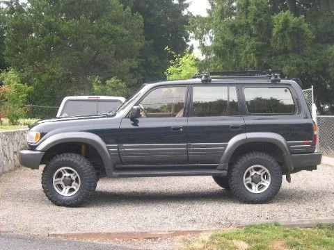

Toyo Open Country M/T 285/75-16
OME J's with Mr. G's up front.
Considerations:
a) Wanted an aggressive tire with decent on road manners. Was a toss up between these and MTR's, these were cheaper and rarer so I gave em a try.
b) I didn't want to re-gear and with all the hills here I would have had to if I went with 35's.
Performance:
So far these are very good on road. There is almost no noise, were easy to balance, and wear very well.
I have only made a couple of trips off road into difficult terrain, but these have performed admirably. As well as my MTR's that I had on a Heep. I have yet to air them down as I haven't had a need to.

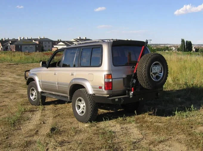

BFG AT KO 285/75R16
1997 LX450 OME 2.5" Medium
- Purchased while still stock height (rotted Michelins made it easy to go to 33's immediately)
- Fit in stock spare location (no rear bumper until Phase III of "The Plan")
- On-road friendly (not loud/bumpy) and off-road capable (only significant weakness is mud -- and IH8MUD :princess: )
- Local Discount Tire (in San Diego) couldn't sipe (I was also considering BFG MT's)
- Great water/snow/ice traction and directional stability (we were planning to move to Colorado)
Performance:
The tires are great onroad and (aired down to about 18psi) very capable offroad. When I air them up to 45psi and drive at freeway speeds, I notice a slight vibration that I attribute to the relatively open tread (compared to street-tires). I now run them at 38/40 psi on-road, and have no issues. I've had them in snow, on icy roads, soft sand, slickrock and granite -- in all cases, I've been very happy with them. No chunking or sidewall damage so far. There's a rim-protection-lip that works great to minimize damage to the wheel (rock-rash).
Recommend:
Yes

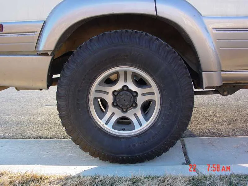

Michelin XZL 9.0R16
Michelin XZL 9.0R16
I wanted a radial tire that performed as well as a Super Swamper (or better) but had better road manners and a better build quality (ie, balanced with less weight, less chunking, etc). I was also a victim of the "cool" factor and mystique that these tires had (have). I started looking for them just before the latest scrap in the Middle East and there were still several sets floating around that were "affordable". I would add, under the given circumstances, that general availability to purchase a spare or replacement should be a big consideration. They are currently very difficult to source in good condition, let alone new.
Performance:
I mounted these on the OEM Land Cruiser alloy wheels with no issues and they required very little weight to properly balance. They measured an honest 36.5" diameter. Each tire weighed nearly 90 lbs unmounted. There was essentially no difference in the tire stance from 50 psi down to 18 psi. Once at or below 15 psi you could discern some bulging. The sidewalls are extremely thick and stiff. The tires were louder than I expected on pavement given what I'd been told, nearly as loud as a garden variety swamper. They did behave fairly well except that as they heated up on the pavement the handling became a bit squirrelly. They were rated to 65 mph although I took them up to 80 mph with the behavior noted above. Off road I had them in mud and they performed excellently. Same for snow. They did not flex enough for rock crawling although I never really got to place that it would have been noticed. They did seem to be wearing rather quickly from all the pavement use to get to trails. Biggest downsides: weight, sidewall stiffness, squirrelly behavior when hot on pavement. Biggest upsides: nice size and dimensions for a lifted 80, very good on most types of trails an 80 would be on, very high quality construction.
Recommendations:
Get them with you eyes wide open. They are hard to source. They are not a miracle, one-tire-does-it-all solution. I imagine the sidewalls are bulletproof.
Sorry for the pics, these are all I have of them.
