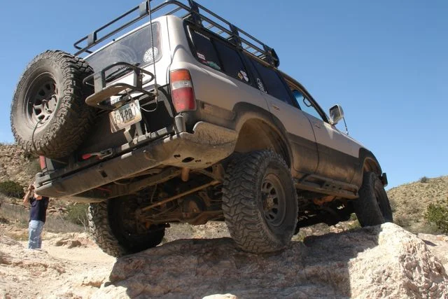

Here’s my girl Tortuga.
ROTW part I
ROTW part II
220k miles
sunroof
cloth interior
no factory roof rack
MODS:
OME J spring/L shock lift
Aluminum CSC front spring spacers
Landtanks Castor correction plates
Slee lower rear control arms (the old style tube ones with stock bushings)
Home made upper adjustable rear arms here
Home made adjustable panhards here
Falken Wildpeak AT4w 315/75 r16 on black steel 16x8 rims
CDL switch and pin 7 mod
Aussie locker in rear

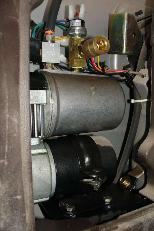

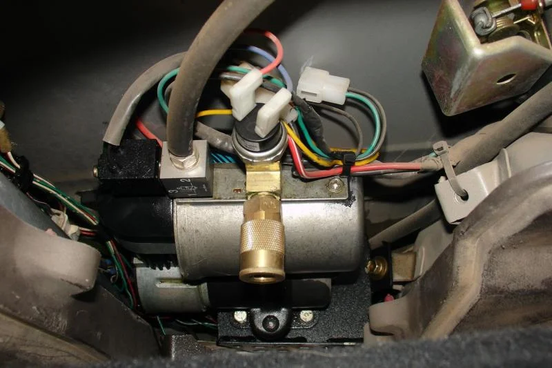

ARB locker in front (air compressor mounted in stock jack location, plumbed with air chuck for emergency air)
4.88 Yukon gears
Slee transfer case skid plate
Slee sliders
4x4Labs DIY rear bumper with dual swingouts (tire/2 gas cans) See here
custom front bumper by me and friend part I and part II
T-Max Outback Series 9000 winch with 3/8x90 Viking trail line(synth rope) on custom receiver mount. See here
sway bar extensions by me (1/2 tube-3-1/2 extended links)
2 Lightforce 170 aux lights with OEM aux switch (LED light bar, not installed yet)
Slee lighting harness and aux harness
National Luna dual battery kit
Urban Landcruisers battery cables
ARB 3/4 length roof rack
OEM hand throttle
40 series Flowmaster muffler with custom 2-1/2” exhaust
JVC CarPlay deck and JVC door speakers
re-tubed rear driveshaft thicker than stock (.2 tube IIRC)
Slee SS extended brake lines
flares gone and Durabak coated (sun damaged a bit, needs a couple new coats or not) See here
front sway bar quick disconnects (custom-me) See here
front diff armor (custom-me)
Blue hub fan clutch fluid mod 15k cst fluid
