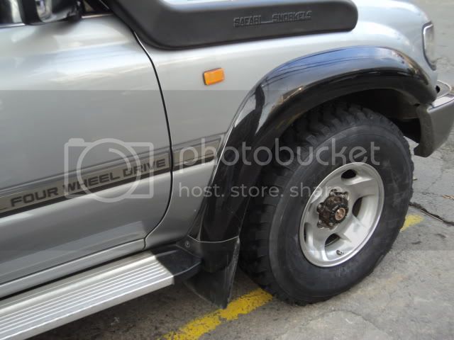

Members Tire Choices (Renamed to not confuse with the other thread)
Interco Trxus 35x12.5x16 (previously 33x12.5x15)
1995 FZJ80 3" Lift
Considerations for Purchase
- Tire had to perform well in all snow conditions from extreme conditions in the Colorado High Country to hardpack around town to deep trail snow
- Tires had to be comfortable and safe for a family of six...no excessive road noise or harshness or poor handling
- Excellent rock crawling tire that can handle both rock and unexpected snow conditions in potential precarious conditions (ledge roads)
- Must have excellent lateral traction
- Reasonable road wear acceptable as mileage is 5K per year
- No smallish 315's that are the size of 34" trxus
Performance
I have run these tires three different times, two of which replaced BFG AT ko's. In a 33" size, they are as quiet as the BFG's, but dramatically outperform them in all snow conditions including hardpack. 35's are something of a different beast. You know you are running a large load range E tire, but I've never run 315 BFG AT's to compare.
Due to the much heavier sidewall, this tire can be run at about 5 PSI less than BFG AT's for the same level of handling, and I have found them to be a more comfortable "around town" tire because of this. They soak up the bumps much better.
As a snow tire, the trxus MT is simply unbelievable. I used to "white knuckle" around in BFG AT ko's, and lose traction in mild offroad conditions, and these things perform like a dedicated snow tire. I trust 4 small kids and my wife in sometimes very ugly conditions, and there is no tire I would rather have in those rapidly changing conditions.
Offroad performance is excellent and they are tough tires. Lateral traction is outstanding.
You will balance and rotate every 3K, and maybe sooner - make sure free balance and rotation is included in your purchase. Some say that no one tire does everything well. I disagree. This is a true all terrain in a true 35" size. Get to know your tire guy and you'll love this tire.
Recommend
Cannot recommend this tire highly enough for people who rock crawl in the summer and deal with snow 6-8 months out of the year on and off the trail. But it is a lot of tire and probably not the best for a daily commuter tire.

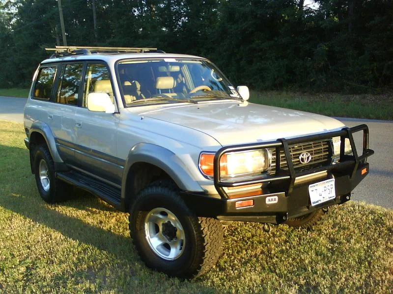

Nitto Terra Grappler 295/75 R16
1993 FZJ80, OME 850/863
At this time my 80 was also my daily driver, so I needed a tire that performed well on and off road.
After reading many reviews both on MUD and elsewhere, I decided to go for the Nittos.
I debated between 285/75s 305/70s and the 295/75s, and chose to go with the 295/75 R16s because they would give me a little more clearance, they looked right on a lifted 80, and reports said they would fit without any rubbing issues.
Performance
The tires balanced very easily, and I immediately noticed how smooth and quiet they were on the road.
Shortly after getting the Terra Grapplers I made a road trip from Utah to Bozeman Montana in the dead of winter. I encountered miles and miles of continuous ice and hard-packed snow driving through Island Park. The tires performed so well I had to stop and verify that the road was actually covered with ice.
I've had them off road in various southern Utah conditions, and they have performed very well. Running them at 25 psi on my 6,000+ lb rig worked very well off road. I haven't had them in any serious mud yet.
They are wearing well so far (I'll add mileage later).
They are a very heavy, beefy tire. The extra diameter and weight was noticeable on the highway.
Recommended?
YES
I will add pics later

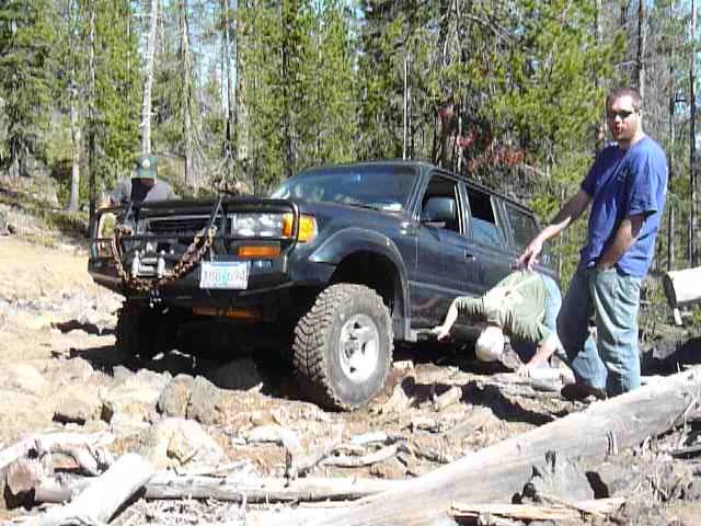

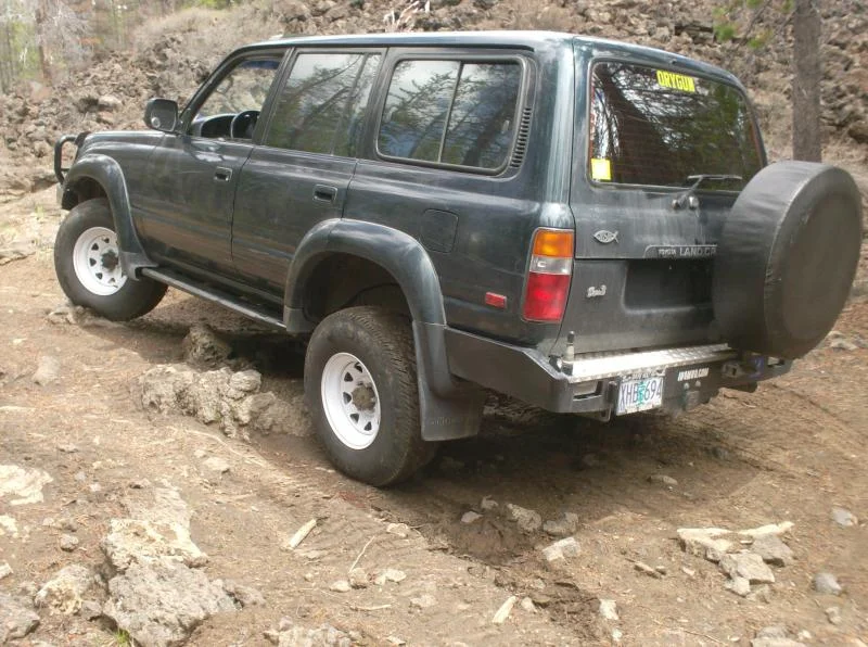

MTRs
Present: 315/75R16 Goodyear MTRs mounted on stock rims
Past: 35x12.50R16 Swamper TSLs on stock rims
Process:
I needed new tires because the swampers I bought with the truck were chunked and couldn't be used for as much as I drive on the road.
MTRs attracted me since they are good all round tires and could handle more road time.
Results:
MTRs are not a good tire for the east coast (or at least the southeast). They do great on rock, but add mud and leaves and they don't void nearly enough to make it through or over a lot of the things down here. I suspect in a dry climate with rock/sand and the occassional water it would ideal.
Recommend:
Yes, for anyone living anywhere but the Pacific NW, the NE, or the SE US.
No if you live in these areas. If you wheel get swampers. If you adventure go for a Toyo or something other than these in the geographies I mentioned the MTR not working well in.
Personally, I am going to a 37" Irok radial next time. I want to be able to dig when I get into the muck down here.

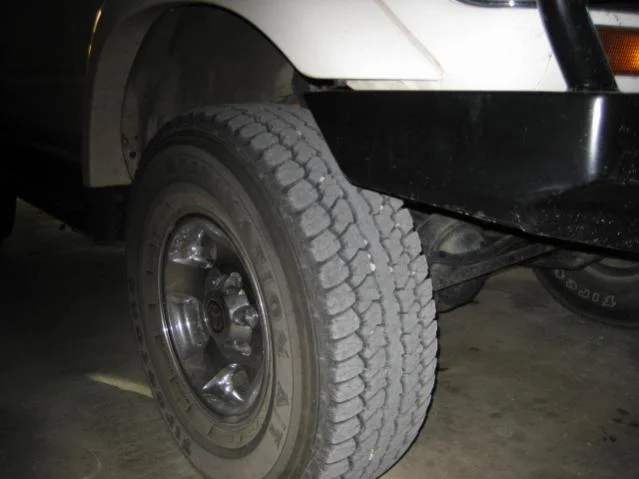

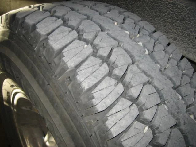

Tire Choice
Firestone Destination A/T 285 75 16
Considerations for Purchase:
My Cruiser is my Daily Driver. I wanted a tire that would do it all, year 'round
I do 90% on road driving, yet I live 2 miles up a dirt road.
Love to "off road" here in the mountains, yet I do 2000 mile road trips commonly.
I'm in the gravel, bare rock, ice and snow on freeways and around town.
I wanted a tire that was good on ice, and low on hydroplaning (A/T KO's were bad for that)
It had to be affordable, yet tough, and get good mileage thru low rolling resistance.
That's a tall order for one tire.
Performance:
I nearly slid off a cliff on on my icy road, on my AT KO's, which also hydroplaned. At that point I determined to find a tire with better ice performance. Did tons of research. No un-studded tire is going to be "great" on ice, but these performed admirably under a 3 ton truck on ice, churned thru a foot of fresh dry snow on a 10% grade, and do not track in semi ruts at 80mph. Air 'em down, and they conform well for off road. Good tough sidewalls. Bridgestone Uni-t technology at Firestone prices. A good value, a dependable tire, and it wears well. The pics show it with 12K on them, I should be able to go 45K before changing. I don't like to get too bald before changing. Need the good snow traction.
Recommend
Yes​
