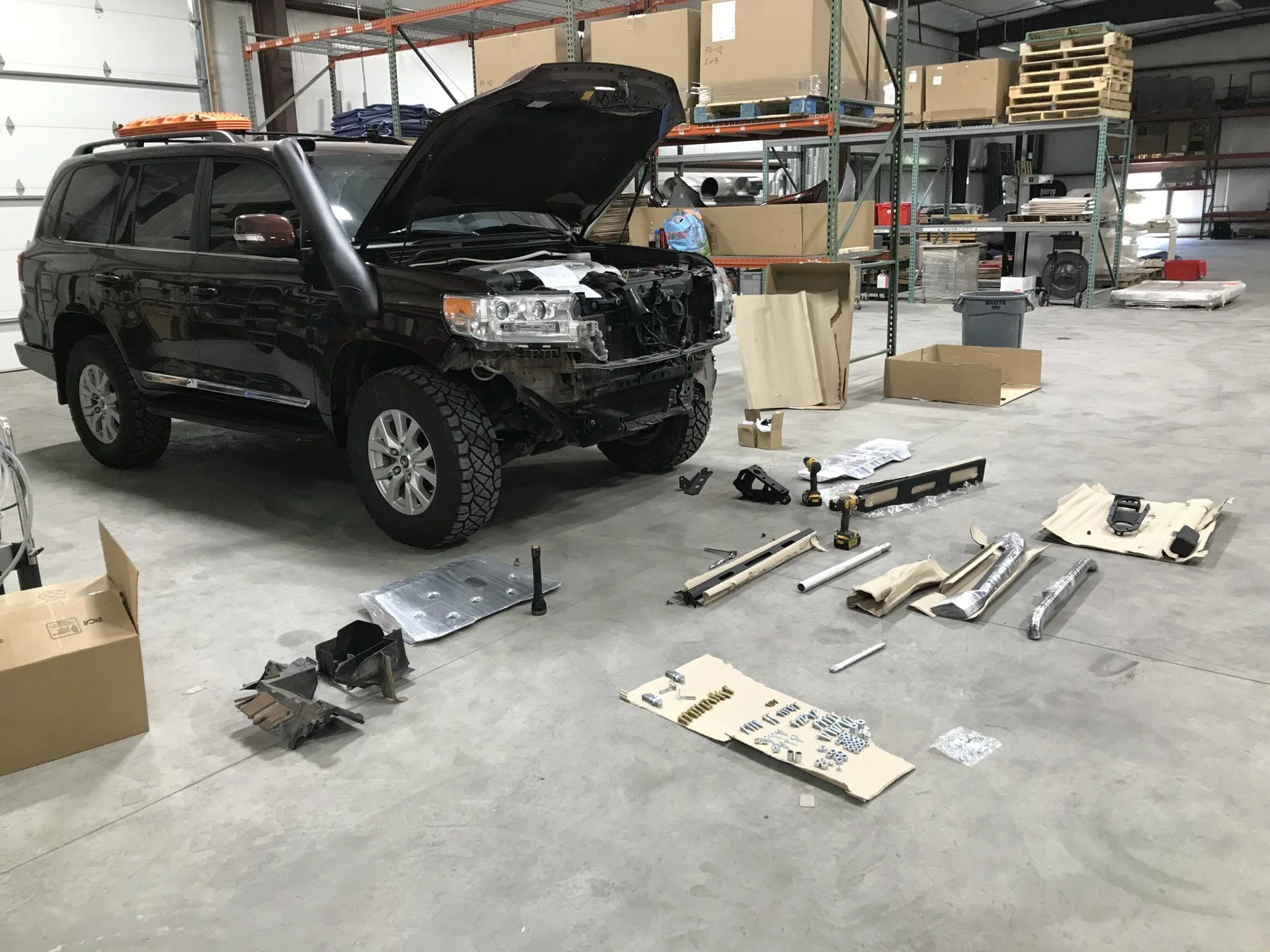

Time for an update. I finished up the install of the front bumper, winch, snorkel and spacers a few hours before I left for Cruise Moab. I did a tire rotation and got a fresh balance on the tires at Discount before hitting the road, and I have to say the improvement overall with all the changes was noticeable right off the bat.

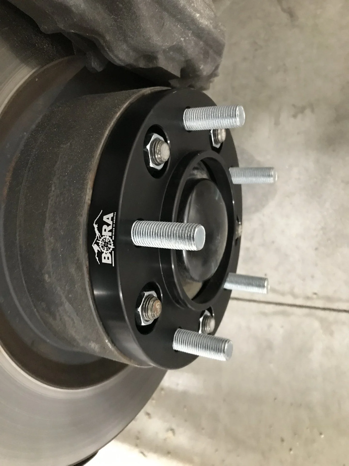

SPACERS:
Likely the biggest difference in feel was adding the 0.75" Bora spacers which immediately made the truck feel more stable on the road, and the tiny bit of wheel rubbing at full lock on the KDSS is now gone. The spacers combined with the fresh balance made the drive much more enjoyable, and my wife commented on it right away as well. I've generally shied away from spacers in the past, but these from Bora are perfectly machined, use high quality lugs and threads, and are solid and beautiful. I have not experienced any negative repercussions from the spacers after several hundred miles of highway at high speeds and low speed trail use. I wish I would have added them sooner!
SNORKEL:
I went with the TJM Airtech because IMO it's the lowest profile and best looking snorkel that one can (relatively) easily acquire in the US. I know ARB has released a new snorkel for the 3URFE which is great, but I still prefer the aesthetics of the TJM. The install was not nearly as scary as I expected fortunately, and cutting the fender was surprisingly the easiest part. The hardest part was mating up the new intake tube to the airbox which does not appear to be a perfect fit for our US spec trucks. Fortunately, my buddy Greg who is a master of all things mechanical had already done the same snorkel on his 200, so he was able to help figure out how, where and what to trim to get them to line up well. We of course added copious amounts of silicone to all of the fittings, and I have to say I am very pleased with how it turned out.

I saved my favorite mod for last. I started this thread and documented the search and install for the bumper here: Rhino 4x4 Front Bumper
I won't rehash everything in that thread, but the highlights are:
- Crash tested and certified; airbag compliant
- OEM looks, especially when color matched
- Retains all safety features, parking sensors and headlight washers
- High quality steel approximately 1/8" wings and 1/4" center
- Excellent winch mounting and easy access
- Amazing clearance while still being a true full width bumper
Granted I was at Cruise Moab where people are more likely to notice mods, but I received dozens and dozens of compliments on the bumper and color match. I wheeled it on some trails where clearance is necessary to avoid scraping, and I'm pleased to say the bumper never touched anything on steep descents, steep ascents, and rock crawling.
The bumper is also very aerodynamic, so it did not create the kind of turbulence I was used to with my ARB on my 14 LC which also helped with gas mileage. On the freeway portions of the trip, we were getting around 15 mpg when averaging 82 mph or 16.5 mpg when going 65 mph, and the bumper did not create any new noises, squeaks, or rattles even when off road on washboard.
I didn't have to use the winch (Comeup Seal Gen2 9.5 RS), but it appears to be very high quality. Access is easy with the Rhino bumper too which is nice, and the winch came with both wired and wireless remote controls (Slee - Winches).

Did you get the spacers here? Wheel Adapters, Wheel Spacers, Hub Rings for your car! | Motorsport Tech
And did you have any issues with them? Slee claims that any thinner spacer is going to have issues with the vehicle studs sticking through the spacer causing fitment issues with the wheels. I am selfishly asking b/c I want to run .75" spacers on my Rock Warriors.

Thanks! Yes that's the place I ordered it from. It was a little slow, but I also ordered during a Black Friday sale. It's a small made-to-order shop, and I didn't mind the wait. They asked for my VIN and pics of my truck to ensure they'd make the right spacers, and they are a perfect fit. As for the stud length, the 16+ stock wheels have little pockets on the backside of the mounting surface that the studs fit into perfectly. There was no interference at all, otherwise I would not have put them on. Some people would say to cut down the original studs, but I'm not comfortable with that. Fortunately the spacers were as easy as could be to just bolt on and go, but I can't recall if Rock Warriors have the same pockets for the studs.
Found a pic! As you can see, not much of the original studs are poking through, and the pockets on the backside of the wheel are plenty large enough to accommodate:

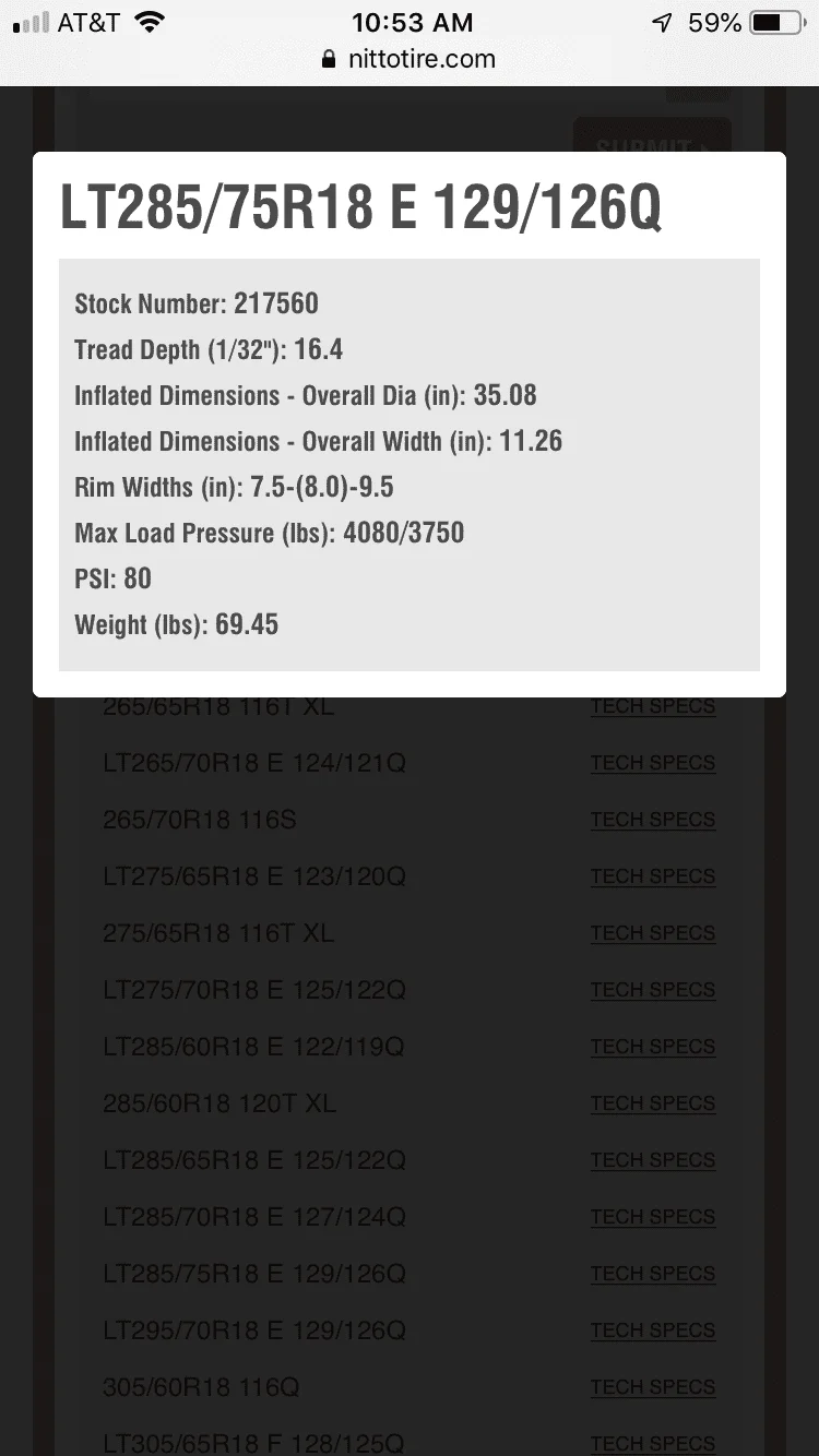

Looking for a tire expert to help with something I find a bit confusing. I have 285/70/18 Ridge Grapplers now and the only thing I’d change about them is a little more sidewall height. Fortunately they are available one size up at 285/75/18, but the specs show they’re actually narrower in the larger size. @gaijin any thoughts as to why this might be?
