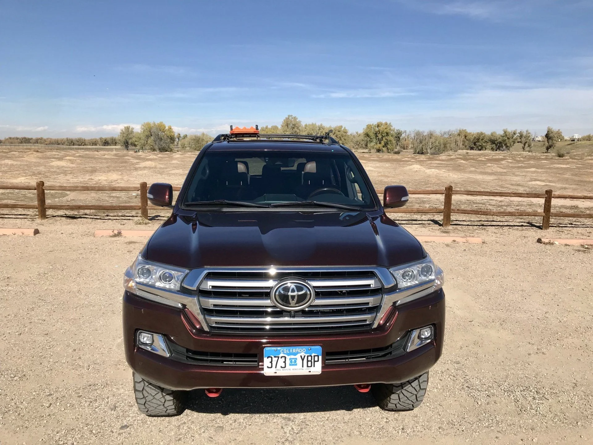

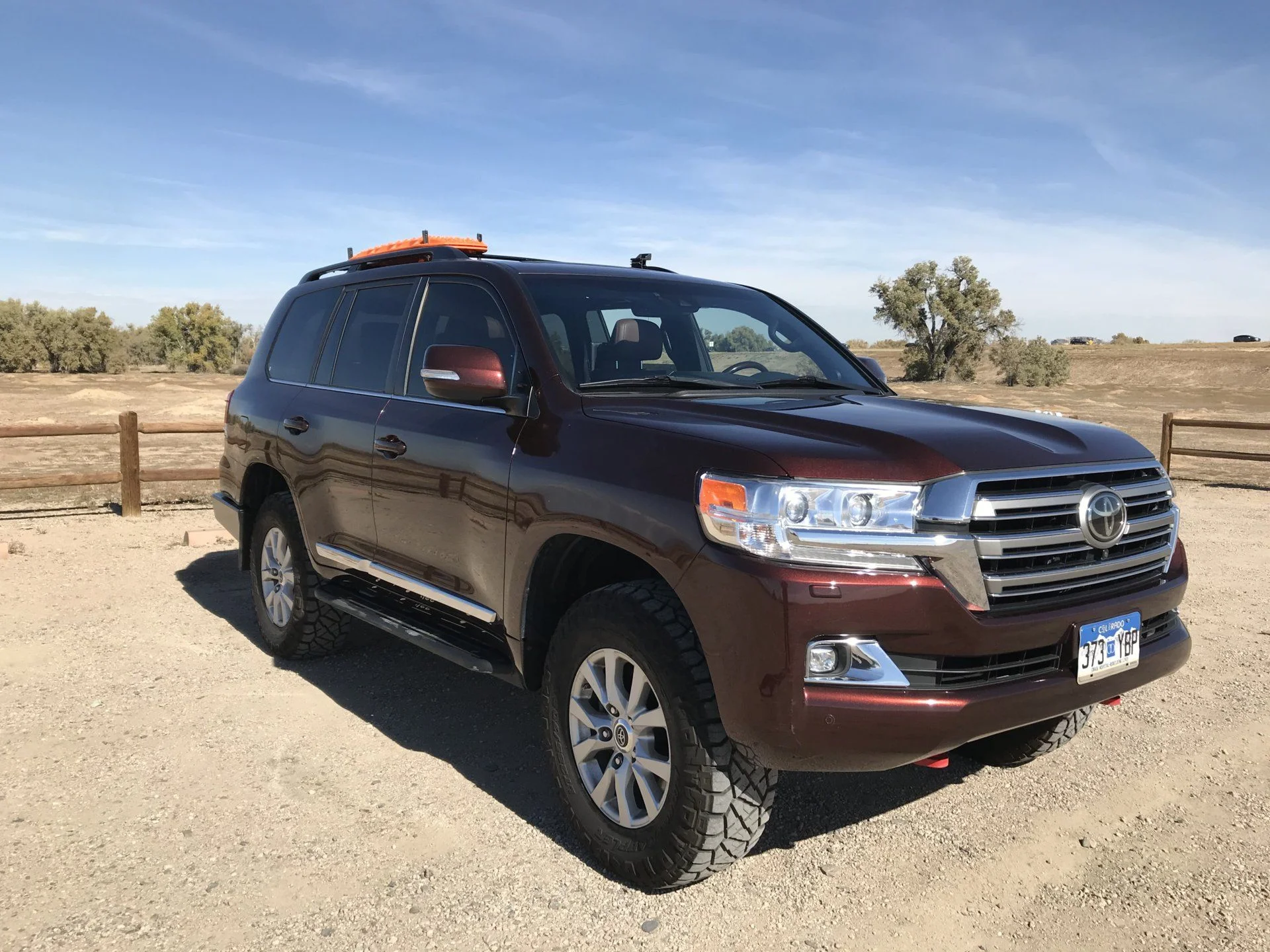

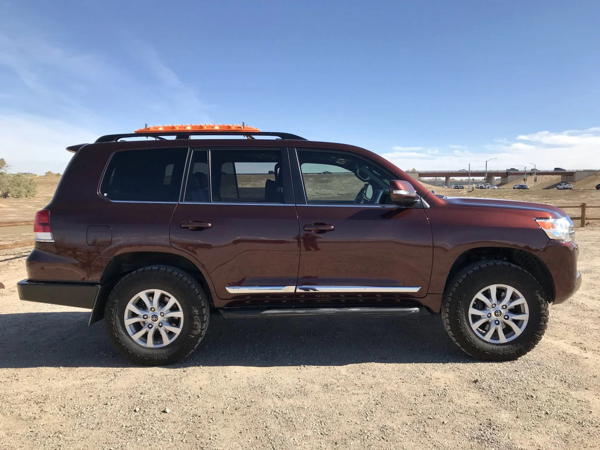

@blatant and others have asked an important question I didn't address in this thread - do the tires fit with no rubbing whatsoever? The answer is not quite. I really wanted to keep the stock wheels, and I wanted the biggest tire I could get on them without major issues. I ran 285/75/17 RGs on my 14 which according to Nitto are 33.86x11.26", and they were close to perfect. I ran the KDSS relocation on that truck, and they only very slightly rubbed at extreme angles, but it wasn't enough to address. Ideally I wanted a tire that was a touch taller and narrower, so I picked the 285/70/18 RGs which according to Nitto are 33.98x11.50" wide. I was expecting a ton of rubbing, but to my pleasant surprise it was pretty minimal. After removing the front mudflaps, about 90% of the rubbing was gone. What remained was mainly present in reverse during sharp turns, and it was mostly up front and slightly on the KDSS.
When Slee installed the BP51s, they aligned with the truck with the tire in mind, which is another reason I think it's important to show up with the tire size you want to run already installed or have the shop install tires there at the same time as the lift/alignment. I noticed some very subtle plastic cutting they did at the very front and bottom of the fender liner which alleviated the rubbing further. I still get some slight rubbing on the KDSS at full lock, but in my wheeling in Moab and Telluride it was never bad enough to do anything about. I am still considering adding 0.75" Bora spacers which I think would eliminate the rubbing altogether, but I'll admit the desire is as much of an appearance thing as anything else. I do think the truck would have the perfect stance with the spacers, but again it's such a minor issue I haven't made it a priority at all. My biggest goal with this truck buying it in late March was to get it built and get it out on the trails and enjoy the summer as much as possible. Now that wheeling season is close to over, I can go back and address some of the more minor issues.

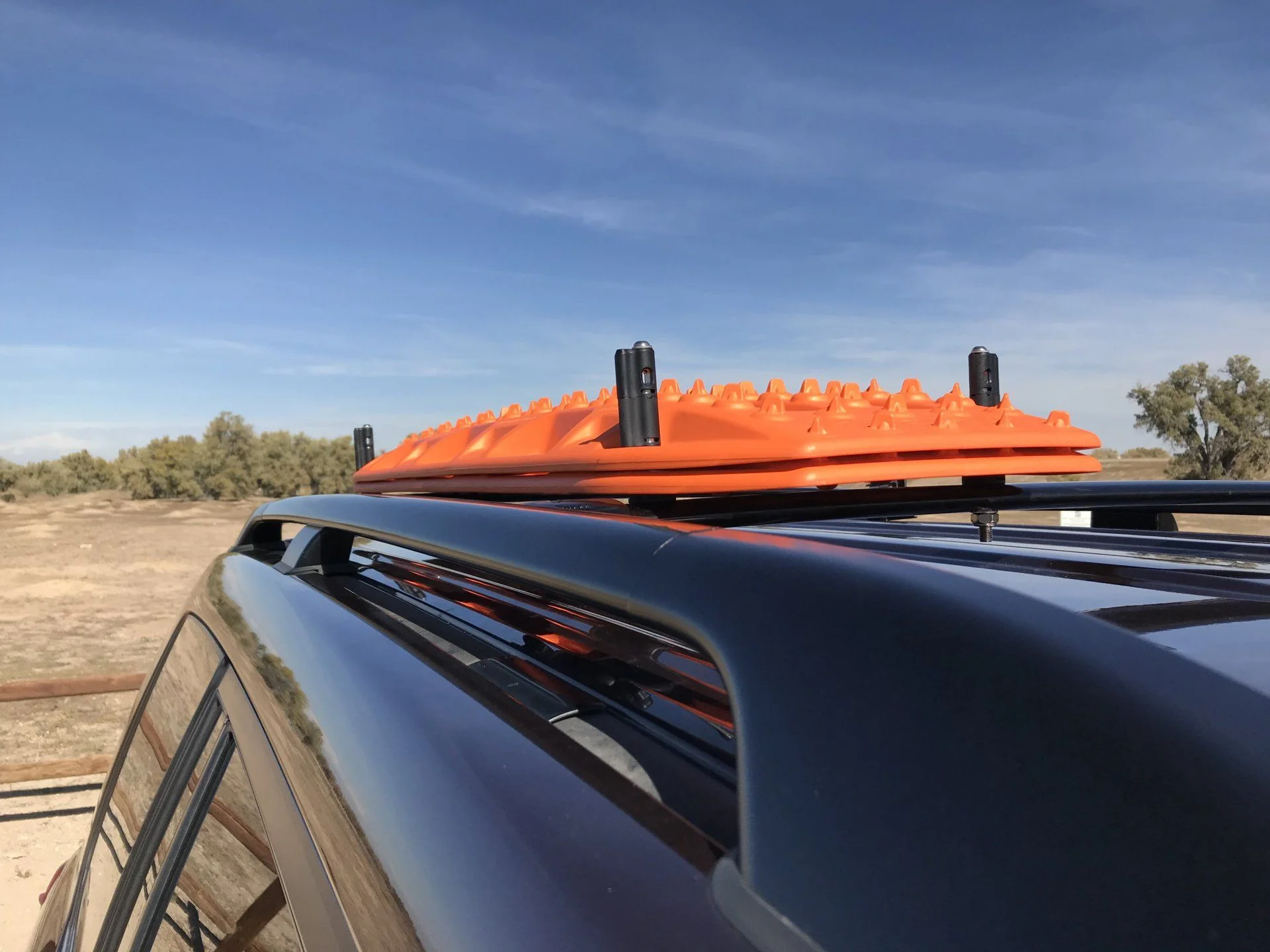

I mounted the Maxtrax on the roof with their universal mounting pin set. I drilled through the factory cross bars because I don’t really have a need for an aftermarket roof rack, and if I’m being honest I’m not a fan of them due to wind noise. I’m the most sensitive person I know to any creaks, rattles, squeaks, squeals, etc. and I have not found a silent rack yet other than OEM. Oh and I also have a full OEM rack in the crawlspace if I jack this one up. Fortunately it turned out just fine and clears the garage door at home by roughly half an inch :D I’ll add some small locks onto the pins and get some rubber caps for the bottom of the exposed bolts. Very pleased with how low profile it is, and best of all it’s totally silent even with the sunroof open.
I can't agree enough with the OEM rack. Yes, it's not as cool and expo looking. But they are built strong with significant cast aluminum feet and side rails. The crossbars tend to be a bit more flexi, but flexible is durable!
As you have an extra rack... One of the great things I've done was to add additional OE cross bars to my rack. I have 3 on it, but 4 would practically make a platform. And still ever so quiet!
