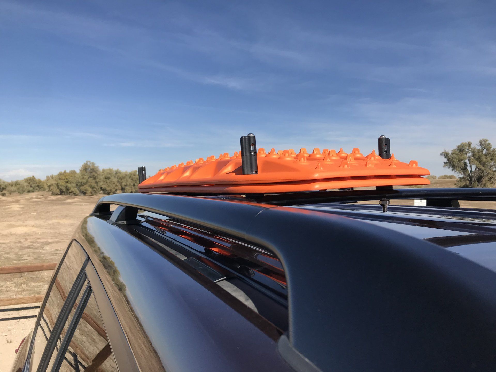

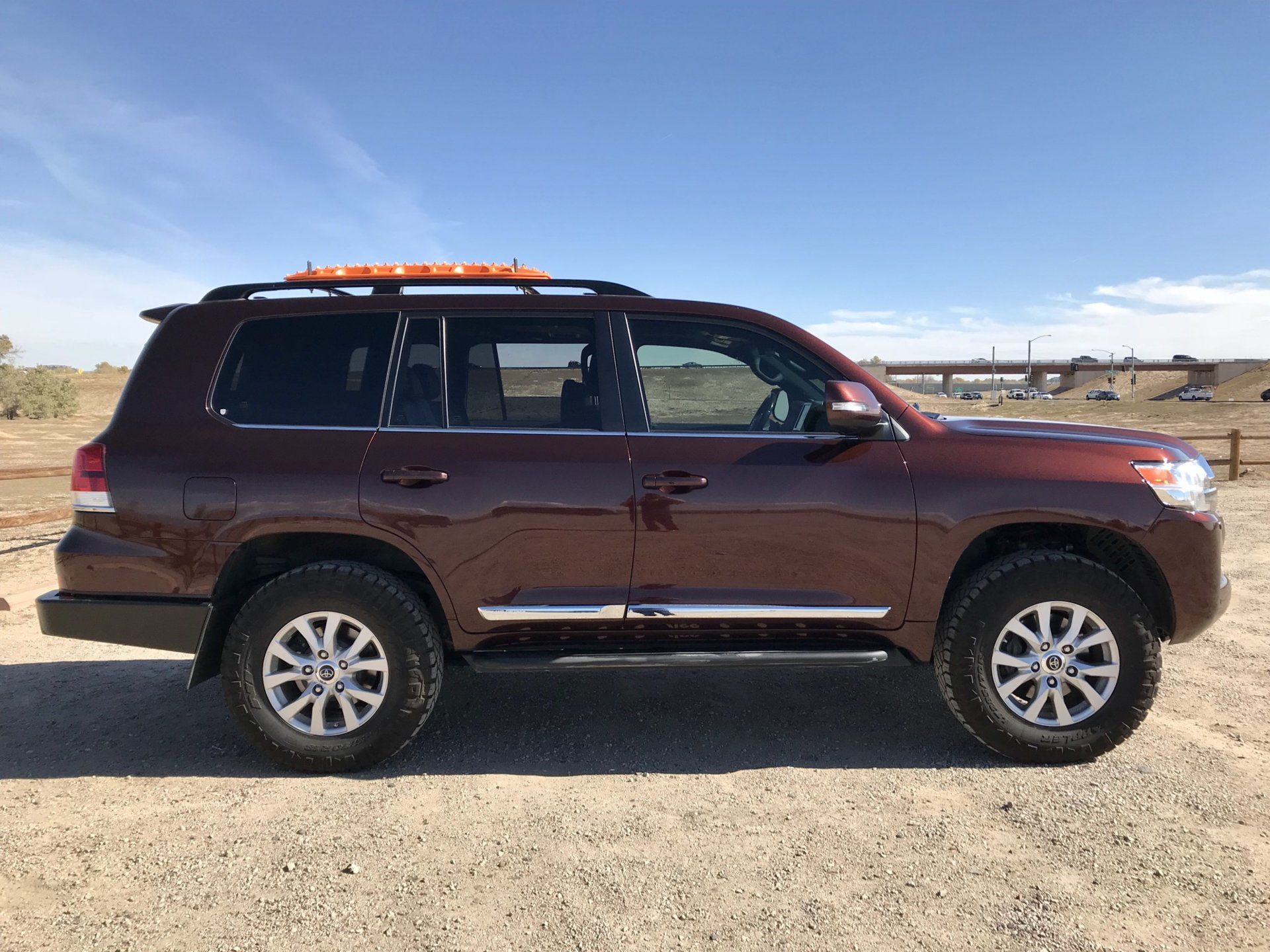

I mounted the Maxtrax on the roof with their universal mounting pin set. I drilled through the factory cross bars because I don’t really have a need for an aftermarket roof rack, and if I’m being honest I’m not a fan of them due to wind noise. I’m the most sensitive person I know to any creaks, rattles, squeaks, squeals, etc. and I have not found a silent rack yet other than OEM. Oh and I also have a full OEM rack in the crawlspace if I jack this one up. Fortunately it turned out just fine and clears the garage door at home by roughly half an inch :D I’ll add some small locks onto the pins and get some rubber caps for the bottom of the exposed bolts. Very pleased with how low profile it is, and best of all it’s totally silent even with the sunroof open.
View attachment 1815524 View attachment 1815525 View attachment 1815526
To answer a question I received regarding the height of the truck with the Maxtrax, the truck measures 82.5" at the highest point which is the top of Maxtrax mounting pin.
Regarding the noise, I did a quick unscientific test with a free decibel monitor on my phone after the Maxtrax were mounted. I had a new loaner Lexus IS250 last week and compared it to the LX570 and LC. Over the same stretch of road with the cruise set at 70mph, the LX was 1 db louder than the IS and the LC was 2 db louder than the LX. All are very quiet, but I was very surprised the LC is as quiet as it is considering all of the aftermarket mods/tires and worse than stock aerodynamics.

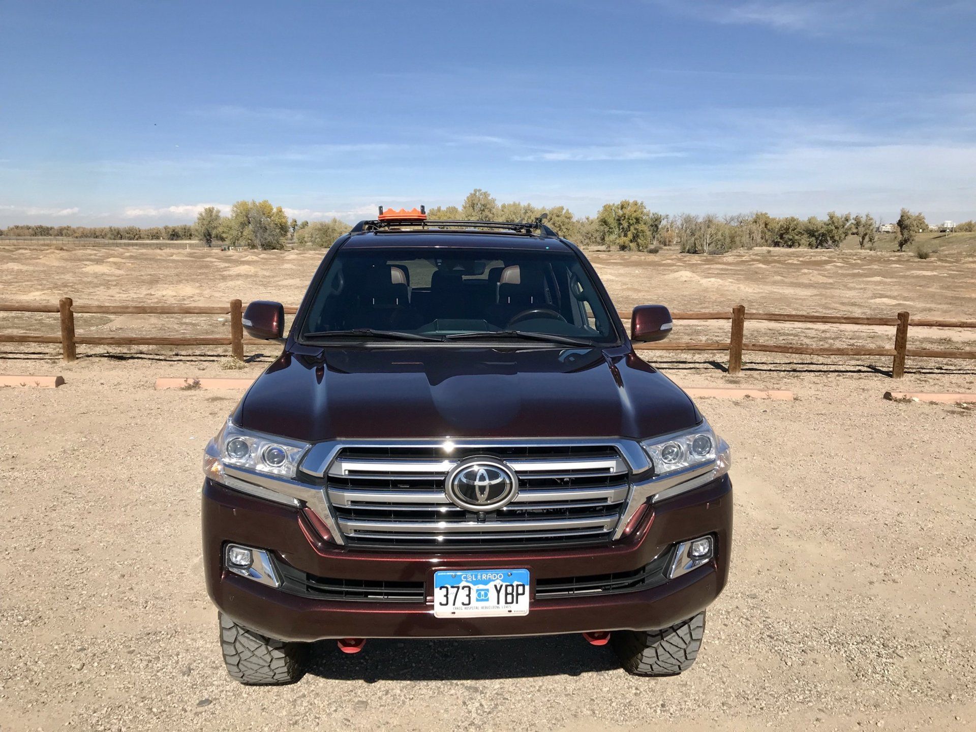

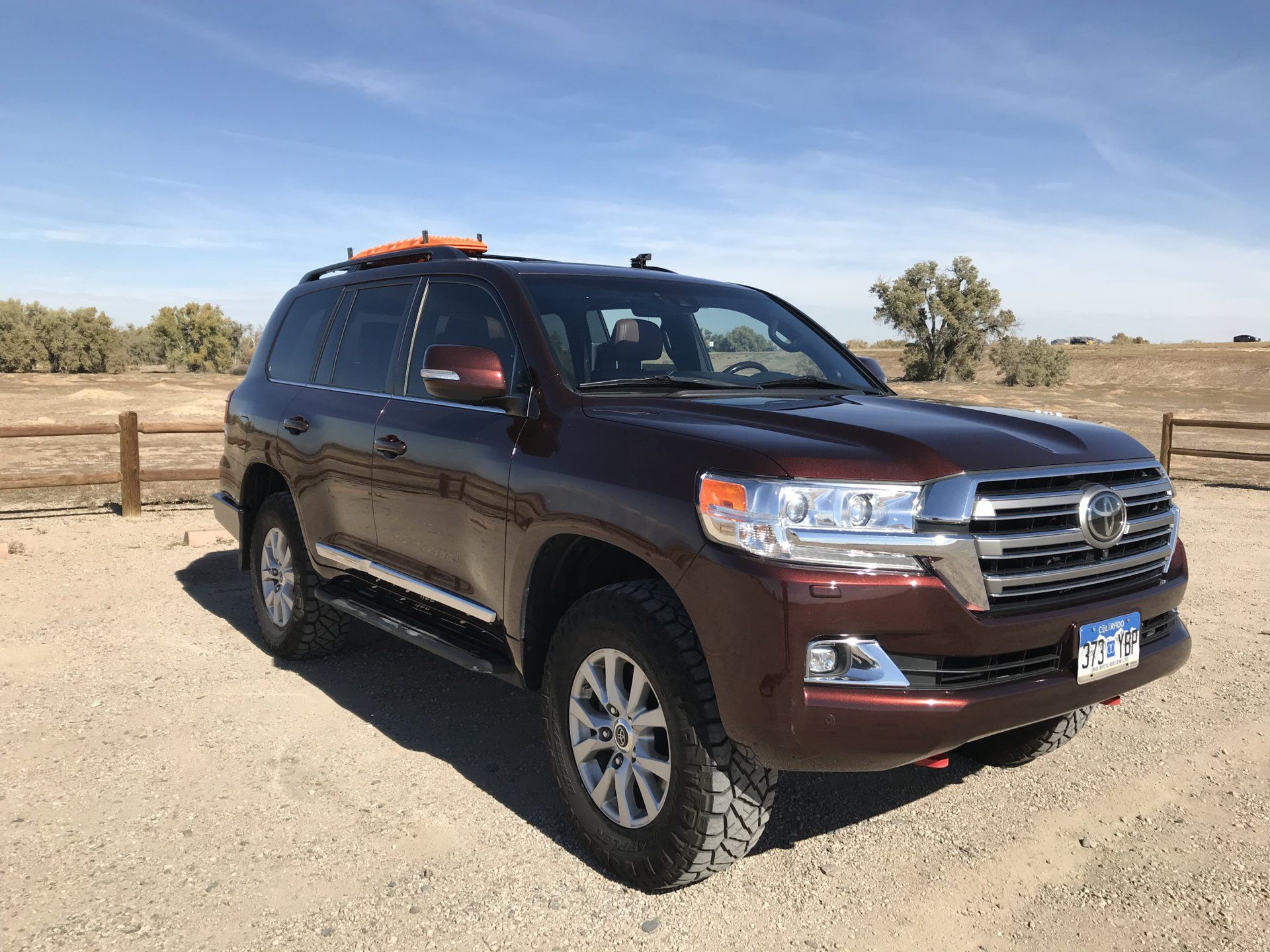

I've had some questions about how much lift I have on the truck, so I measured mine at a local Toyota dealership next to a stock new one. Spoiler alert for those who like short answers - my lift is roughly 2.25" related to the suspension and 1.75" related to tires (see chart at the bottom). A caveat - a stock truck sits about 1.75" higher in back than in front, but mine sits level front/back after the lift. I have about 10mm of preload on the front coilovers and 2722 springs in the back.
Stock truck - front end, ground to top of fender = 35"
