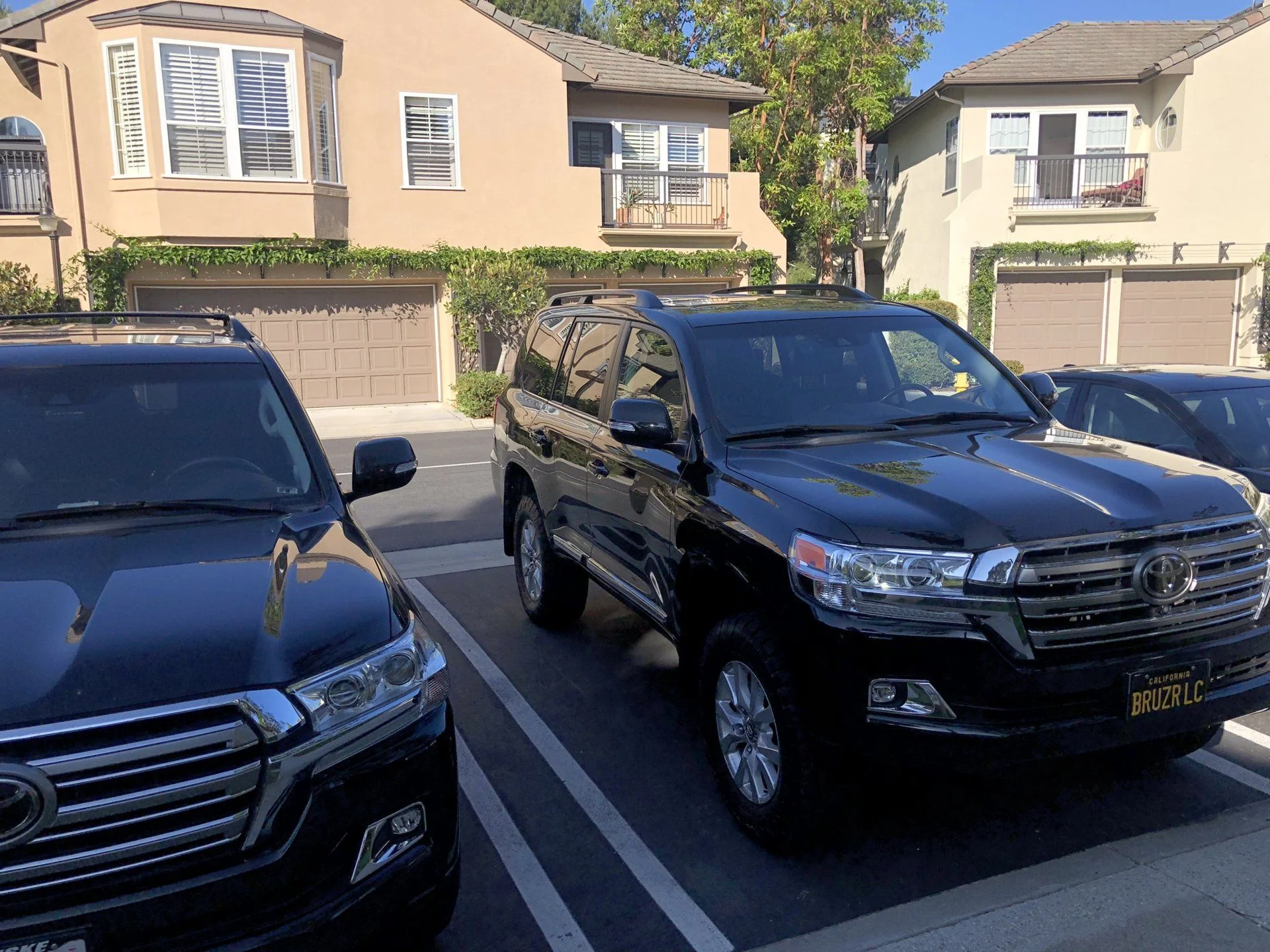

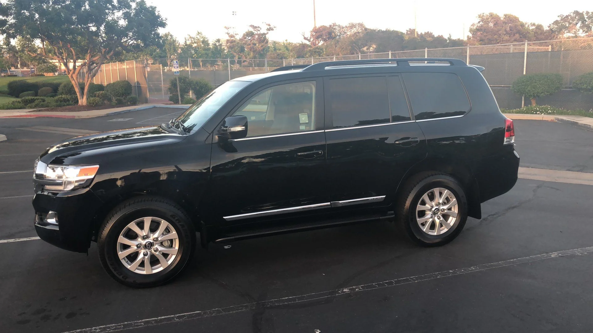

Picture from the day I purchased

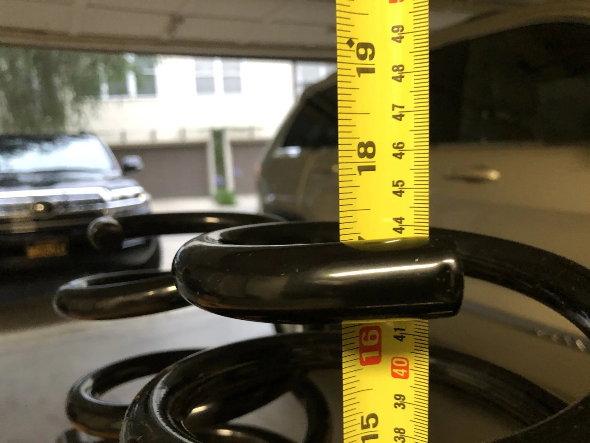

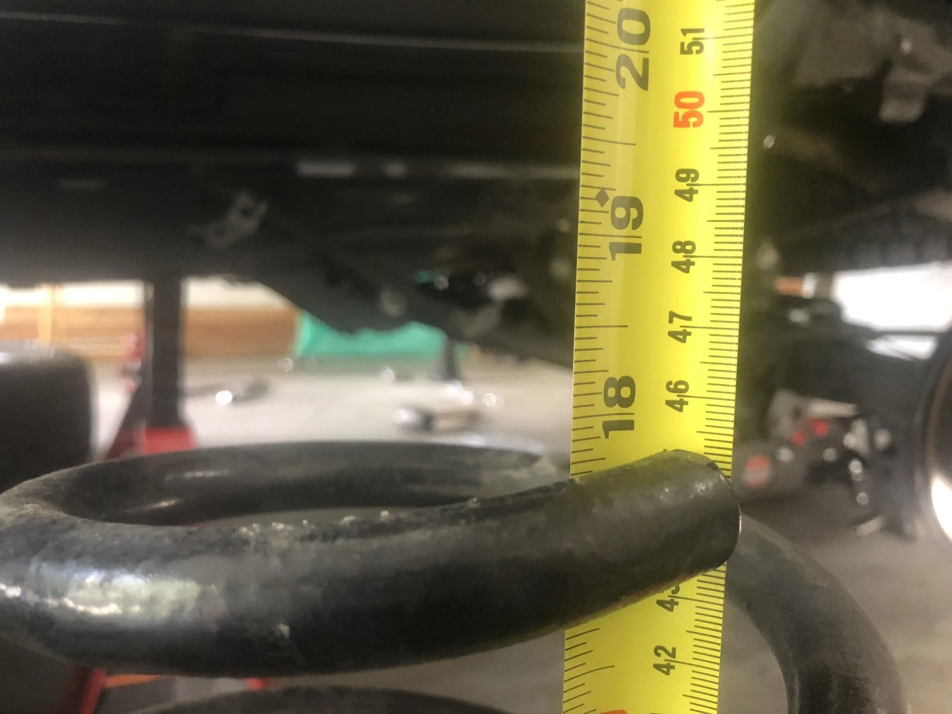

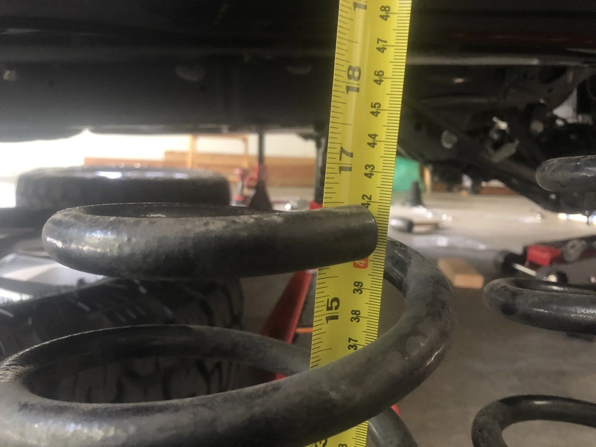

There was some debate recently on OME spring heights not working well with, or not designed for the 2016+ models.
I took initial measurements of the 2722 rear springs and I will measure the oem Toyota springs at take-off.
"A" Lefthand
"B" Righthand
Here are the measurements from the OEM Toyota springs.
Driver/Left Side measured ~42cm (about 1cm shorter than the ARB OMEs)
Passenger/Right Side measured ~45.3cm (about 1.4cm TALLER than ARB OME).

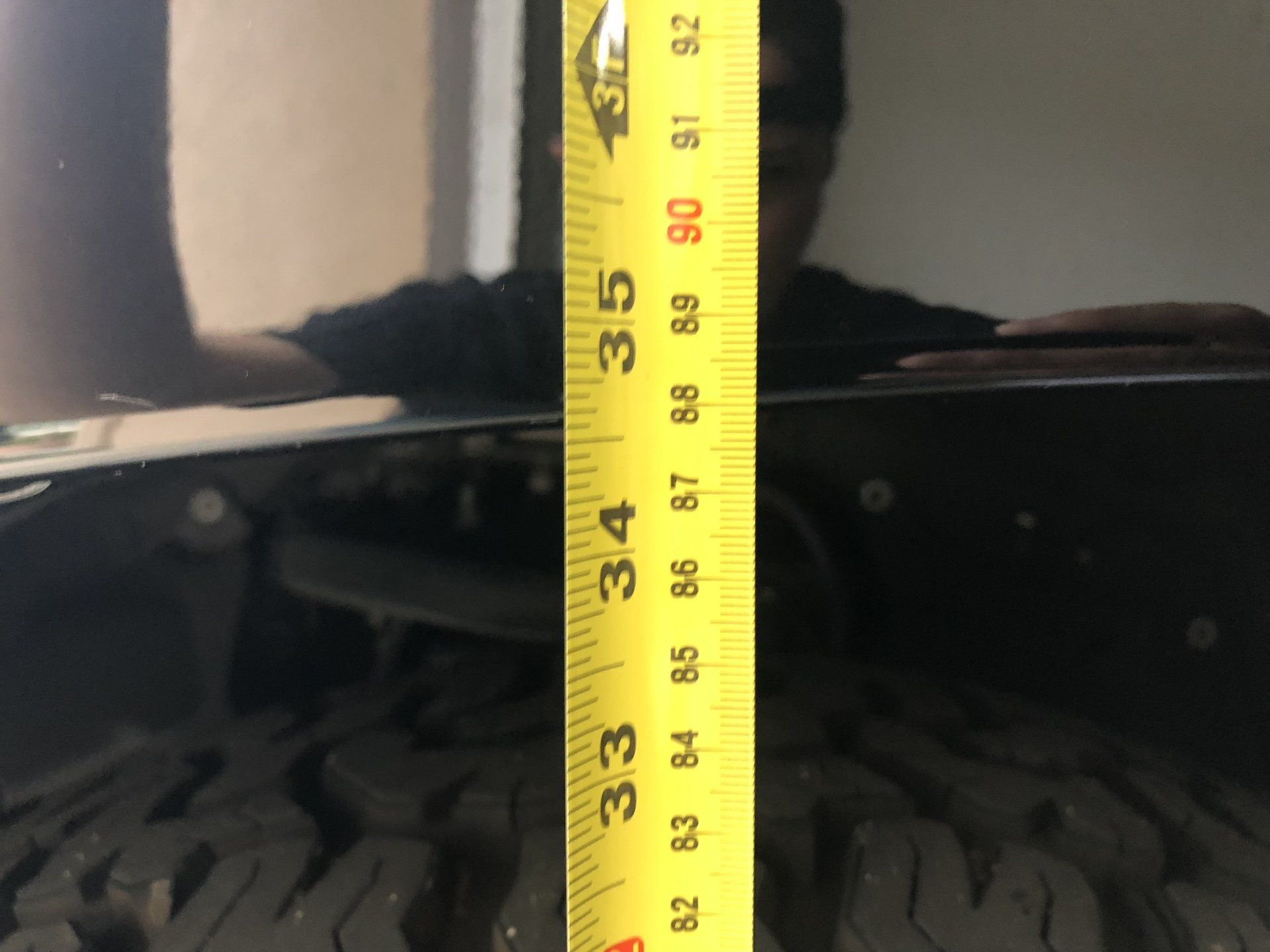

Here are the before and after measurements I took after install. I will update the values once I've driven more and allowed all the systems to settle. I also plan on opening the KDSS values again to help even things out.
There is a slight lean 0.75 cm between the LR and RR heights. I'm hoping that things will settle, the alternative is to use the 10mm ARB spacer.
All measurements in CM
Left Front​
Right Front​
Before
88.20​
88.70​
After
97.50​
97.50​
Gain
9.30​
8.80​
Left Rear​
Right Rear​
Before
91.50​
91.90​
After
99.25​
98.50​
Gain
7.75​
6.60​
Overall I gained about 9.05 cm (3.56 in) in the front and 7.18 cm (2.82 in) in the rear. The Front-Rear difference went from 3.25 cm (1.28 in) to a near-level 1.38 cm (0.54 in) difference.

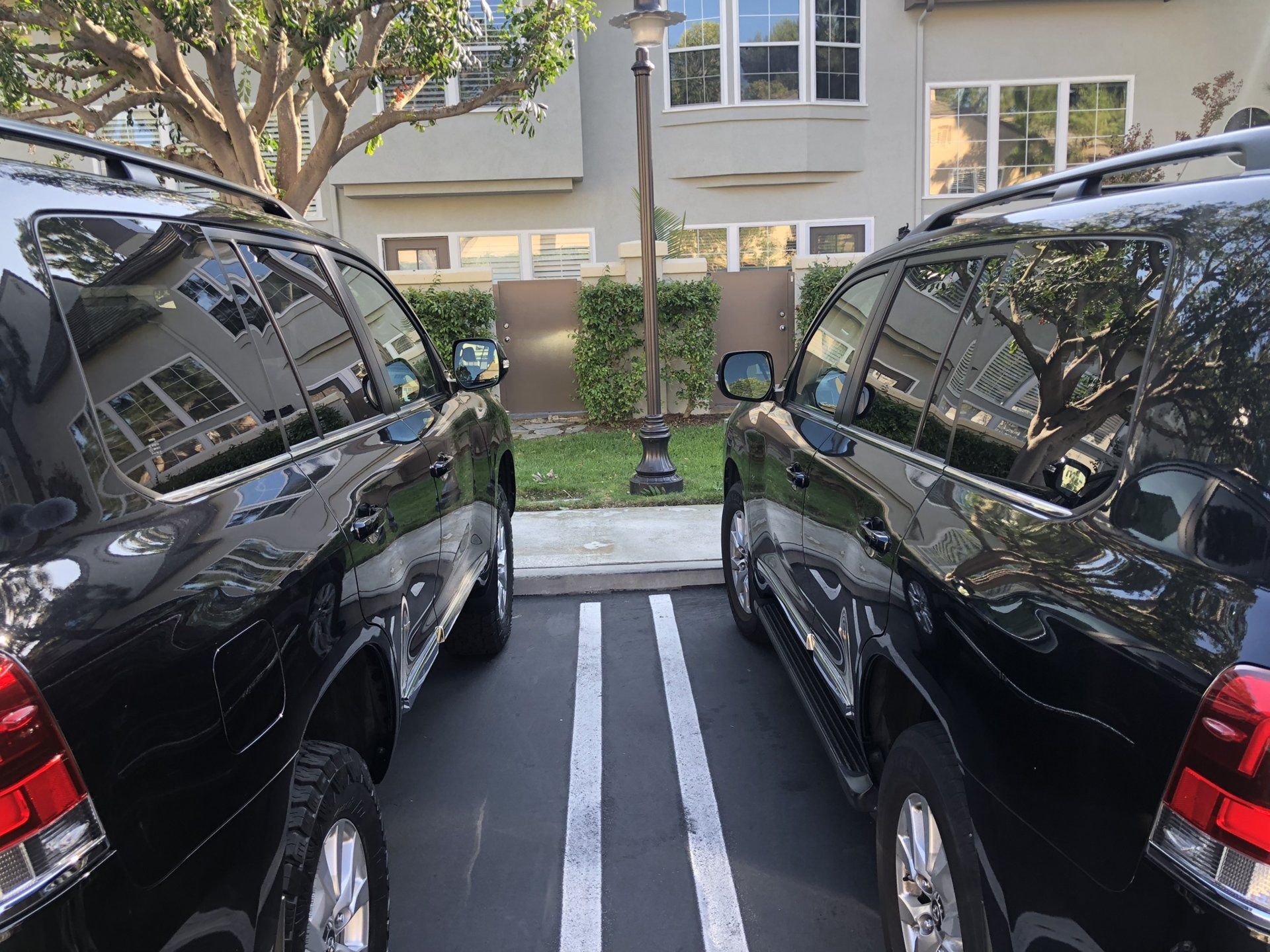

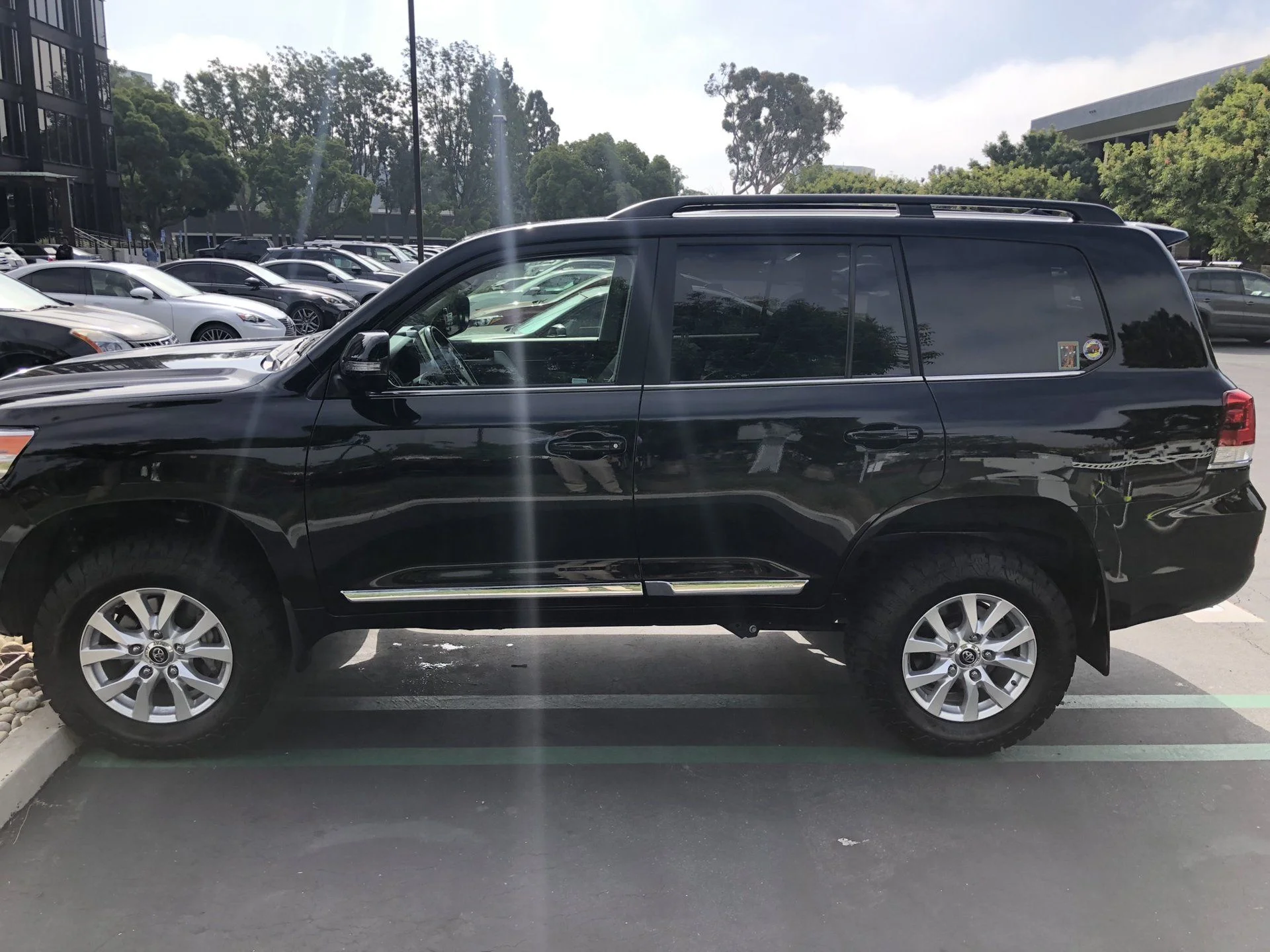

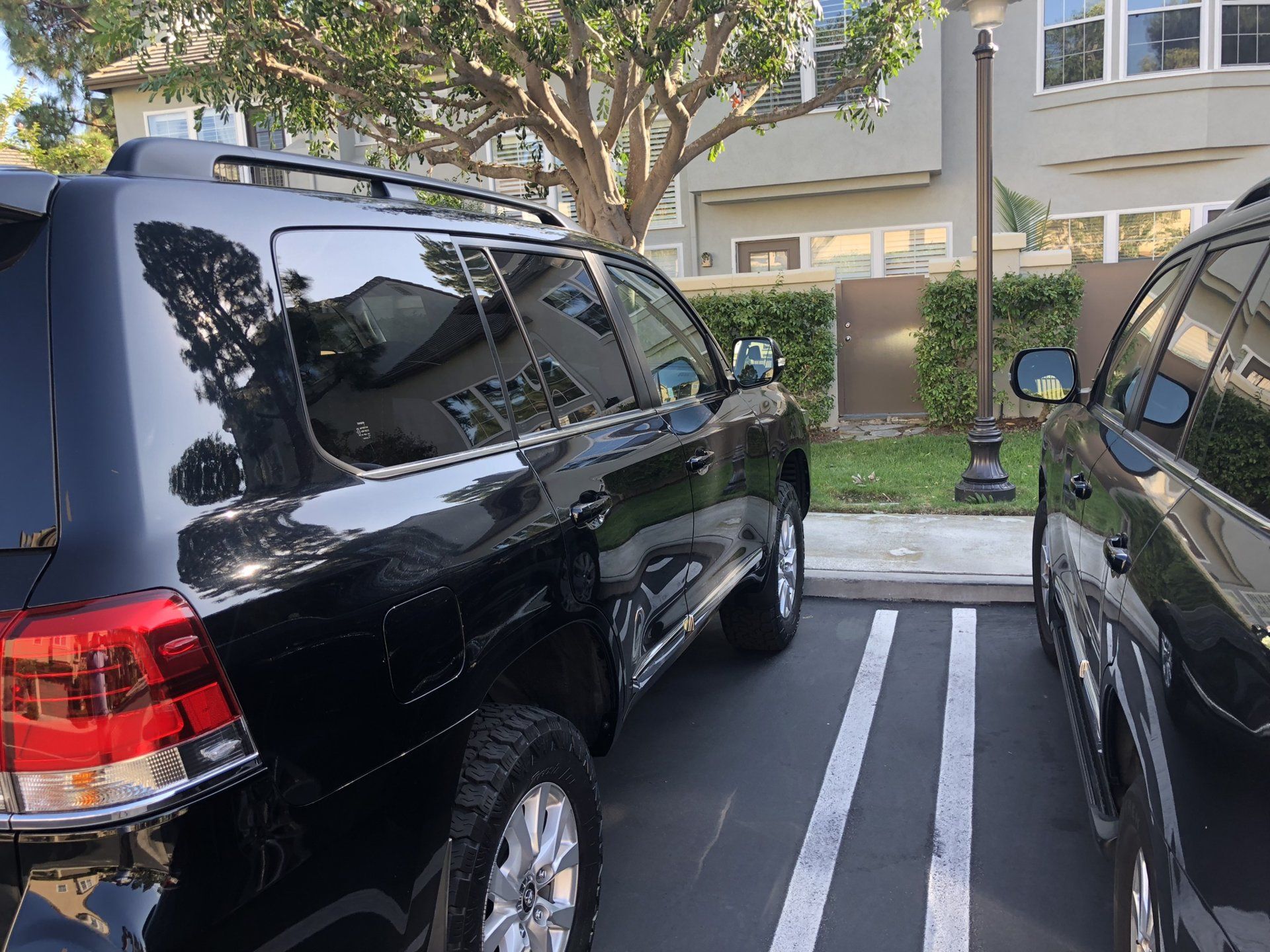

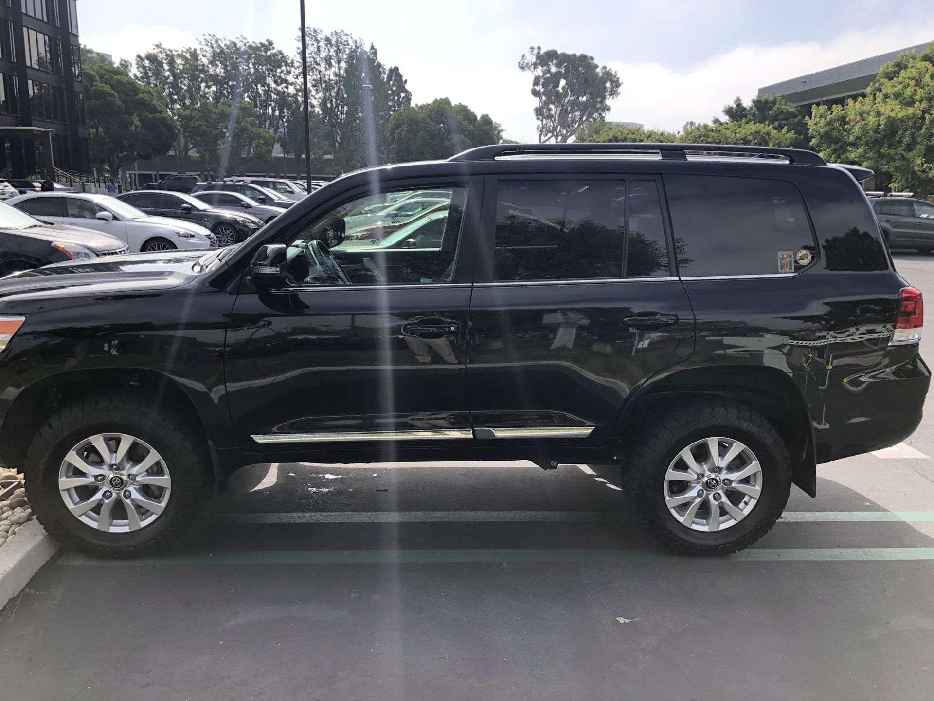

Here is my "after" shot.
And some comparison shots next to a neighbors 2017.
Nice work - I know that takes a lot of time and patience. What are you measuring in your before and after? If you got over 3.5" of lift up front, that would be very unusual (unless you're counting height gained by tires as well which isn't the "right" way to check lift height", and it doesn't look like 3"+ in the photos. See this post here with how I measured and a table to show before/after with mine vs a stock truck sitting on a Toyota lot. If you truly got that much lift, I'd look into a diff drop because your CVs will be at too steep of an angle and will eventually cause issues like torque steer in the short term and leaky CVs in the longer term.
I didn't measure the "proper" way, just ground to bottom of the fender. The tires and wheels were the same in both measurements.
The next time my neighbor leaves his stock LC out, I'll measure his for comparison.
Interesting. Hopefully they settle after you drive a bit. I guess now that I think about it mine had been on for a couple months and wheeled by the time I measured, so mine were definitely settled in (still didn't have a front bumper at the time however).
Goal is to remeasure once I put some more miles on. I'm expecting about a 0.5-0.75 in drop in lift once things settle.
I took some measurements from center of hub to bottom of the fender as well as some ground to body points on my neighbor's stock 2017. Compared to my tire/suspension upgrades I'm running about +/- 8 cm (3 5/32") higher. I'll monitor the CVs but I'm hoping the SPC UCAs do their job and I don't need a diff drop. I haven't read that anyone doing this OME setup needed a drop.
