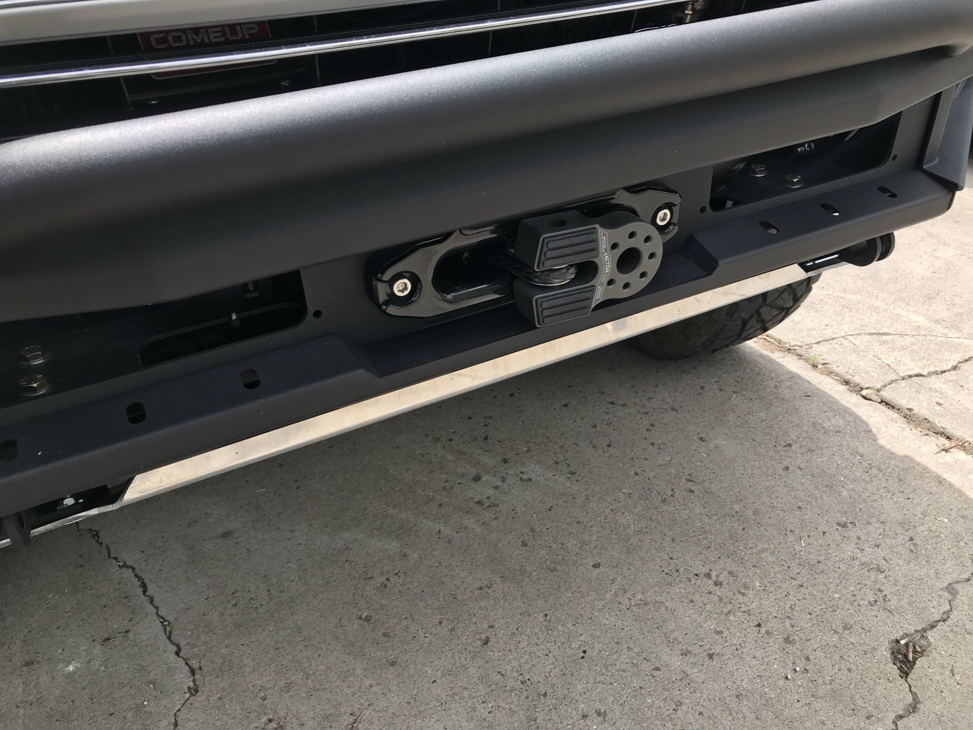

Added a Factor 55 Flatlink to the winch today. The front bumper came with a pivoting license plate bracket for the front plate, but I can’t seem to figure out where I put it. Once I find and install it, the Flatlink won’t interfere with it unlike the Prolink I tried first.

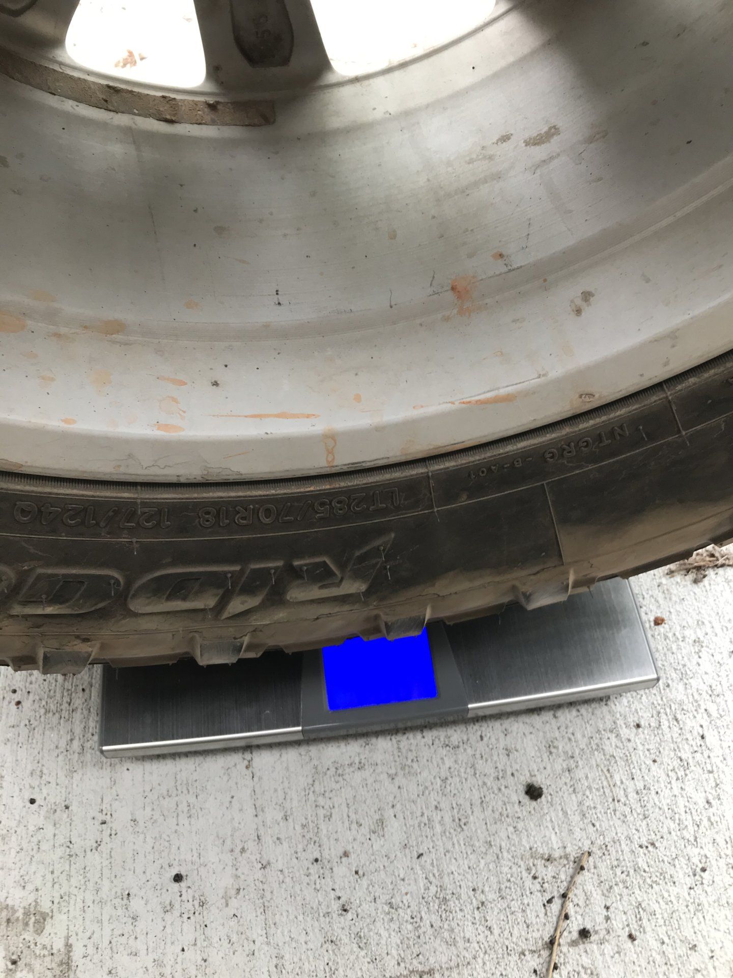

Dropping off Tuesday morning for the new meats! Just for kicks I weighed one my current wheels and tire for a baseline, and my current setup is 100 pounds per corner (weighed 4x and 2x it was 98 and 2x it was 100). I’ll be curious to see if the 35s are really only a 10 pound per corner increase. Bathroom scale apparently has the LED flicker going on so I snapped 2 pics:

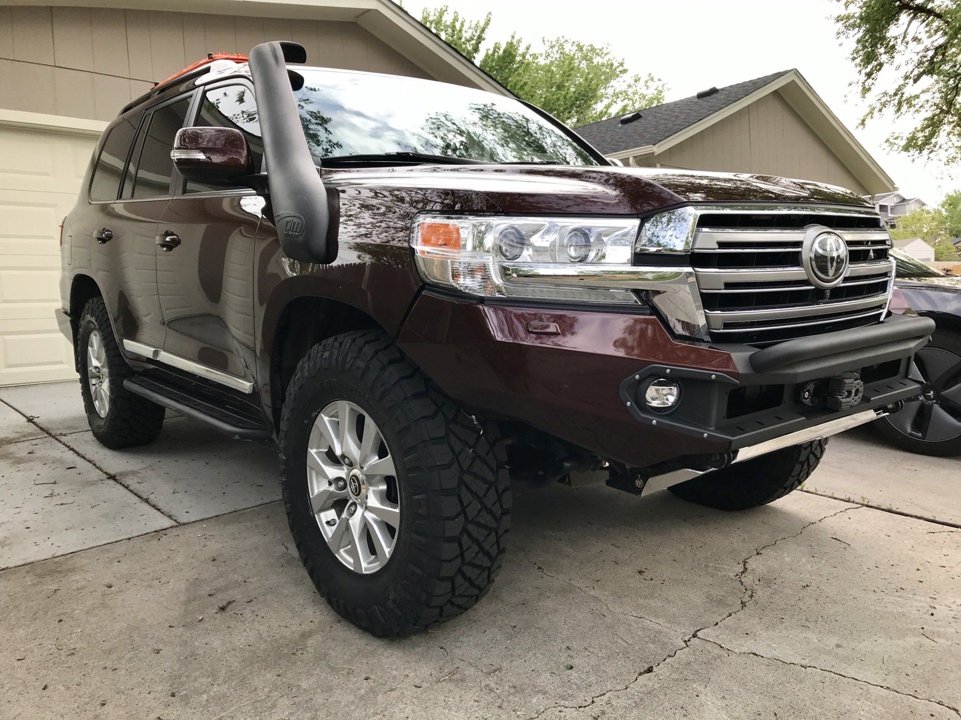

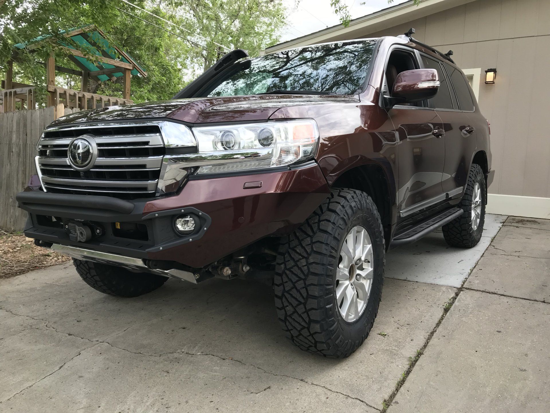

Added the 35s today. They rub a little on the plastic at the rear which is expected and pretty easily fixed, and they rub a little on the KDSS which is annoying since I JUST remedied that with the BORA spacers. My biggest concern is ensuring the tires don’t hit the front bumper under extreme cycling causing damage, so I’ll play around with it this weekend to ensure all is good. I haven’t been on the highway yet, but around town I can barely feel any difference over the 34s.

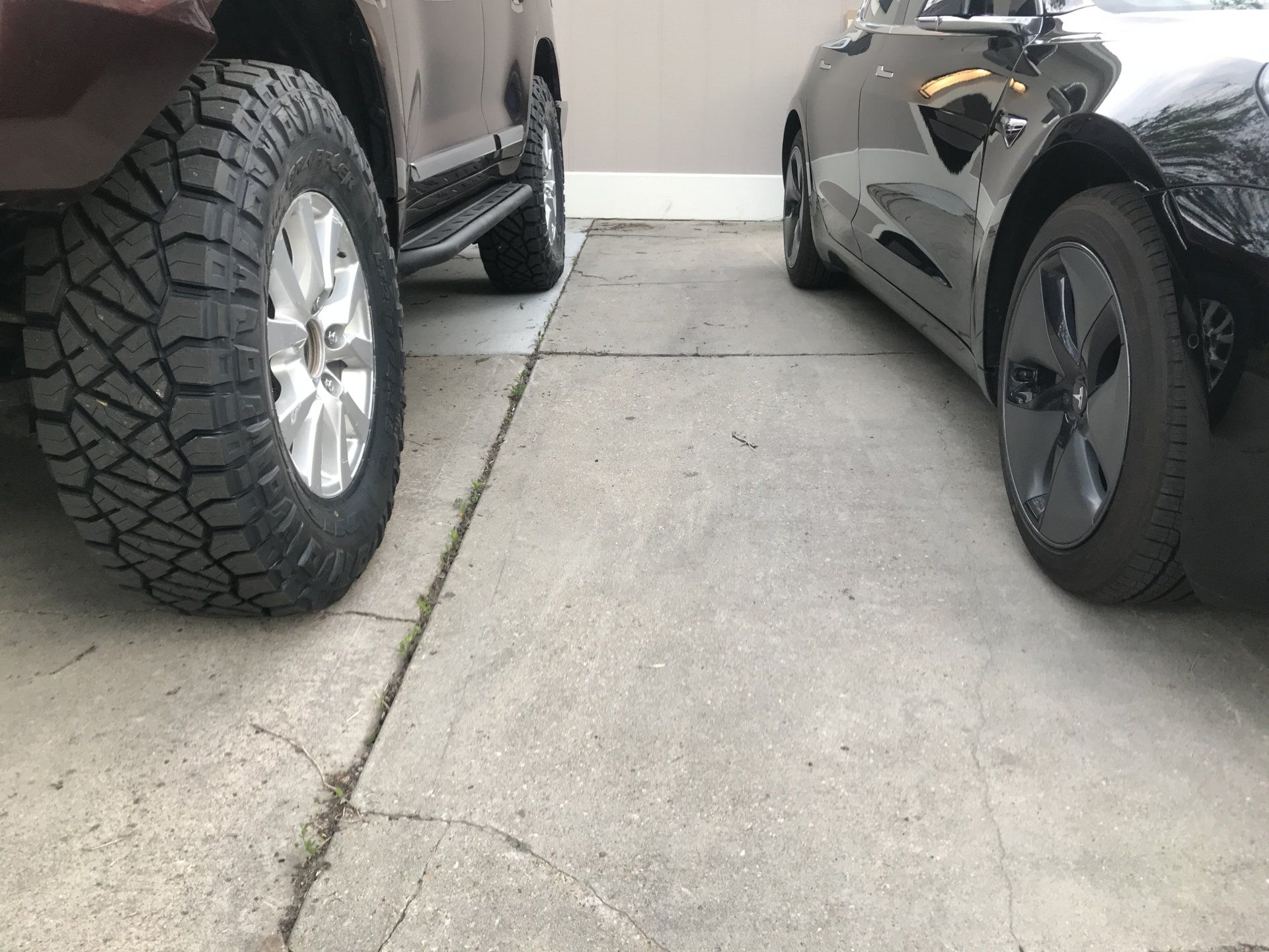

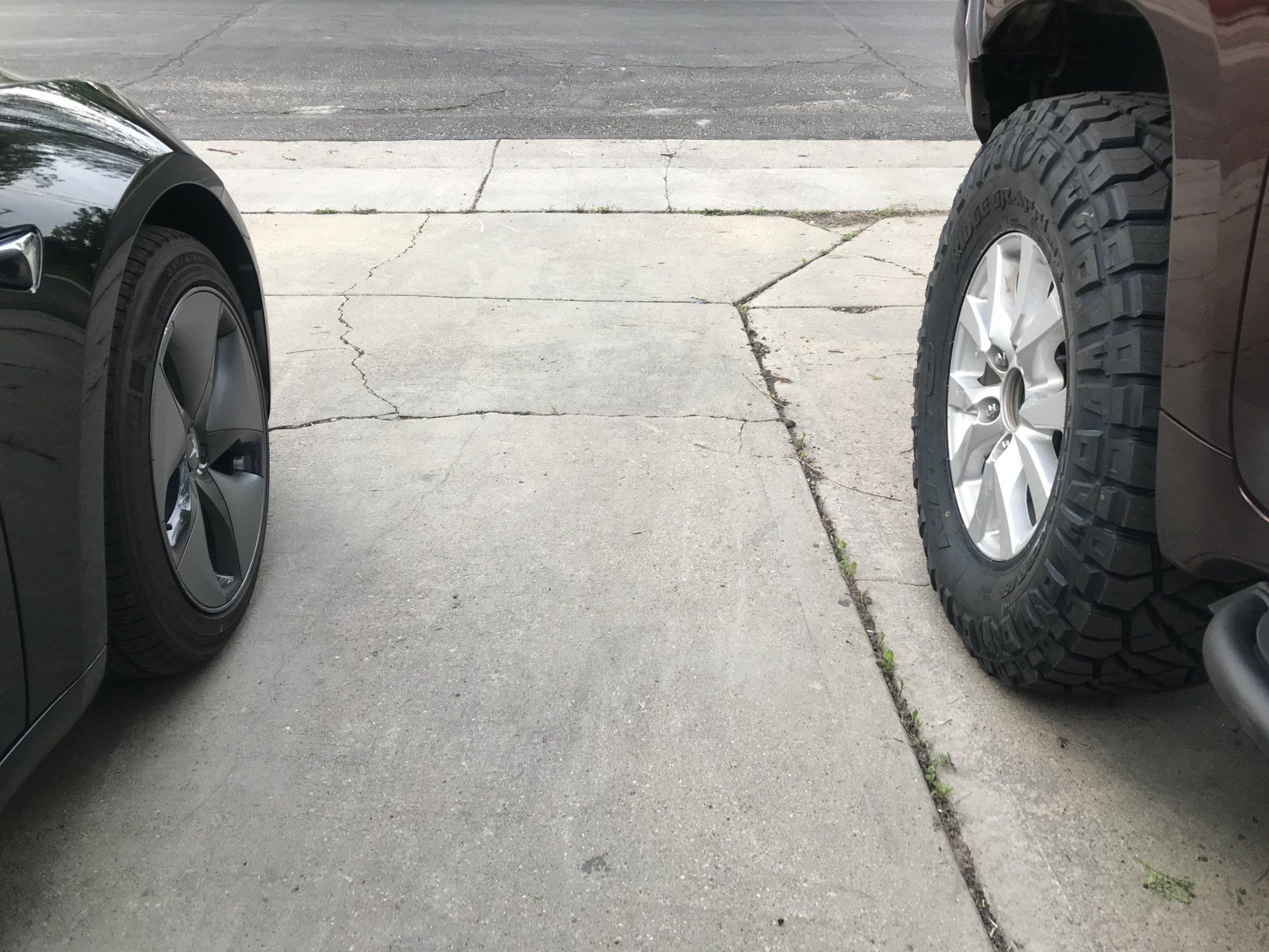

Also it’s funny to see the difference rubber makes. These are both 18” wheels:
Dang it, Matt!
Just when I downsize from 35’s....and adjust my eyesight to 34’s...you had to go and remind me that 34’s just plain can’t visually compare with 35s!
:doh:!
:hillbilly: :cheers:
View attachment 1990576View attachment 1990577
Damn that big girl looks good with them new shoes!
You just like the challenge Matt. As soon as you get the rubbing on the 35s worked out it'll be time to try 37s... :)
You're gonna put that one missing center cap on right?
Good eye! Yes I popped it off to experiment this weekend with potentially painting or dipping the wheels, and I'll start with that one. I am thinking a very dark grey with some gloss, but I haven't decided yet. I'd also like to do something unique with the center caps too just not sure what yet!

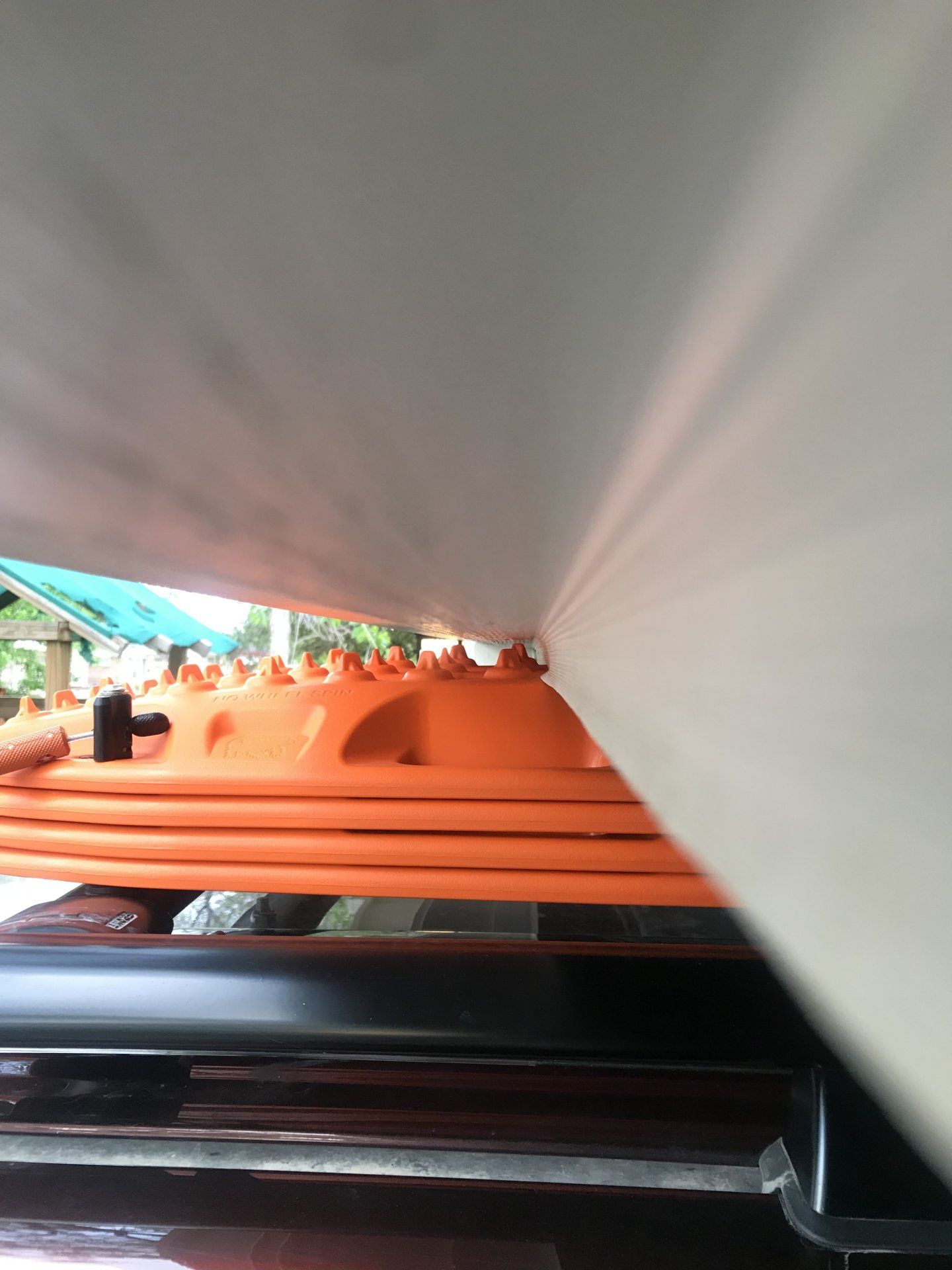

Here are some pics of the clearance if anyone is considering running this tire. I'm sure it's doable, but there will be compromises made in order to get it to work at its full potential. I stand by my original decision that the 285/70/18 is the best size tire for this platform, and fortunately I was able to correct my mistake before going down the rabbit hole :p I will admit the 35s look incredible, but people like @Willy beamin were correct in calling me out for going against the original ethos of my build.
A couple of big pieces of wood and 4 Maxtrax stacked to see how the front passenger tire would clear (~13" off the ground). Doesn't appear that it would have any issues, but trimming the plastic the rear would likely be necessary for real world wheeling situations.
