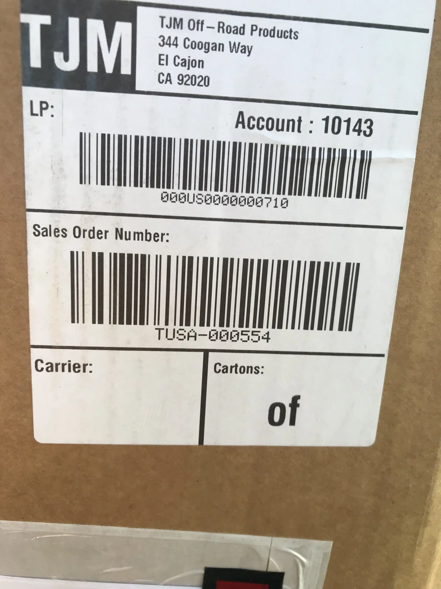

It’s been a while since I’ve updated this thread, but Ruby is going to get a couple of upgrades in the near future...
Is that a bumper?
Not a bumper...I actually have a special one coming from Australia that is not sold in the US, but more on that later.
The TJM box contains an Airtech snorkel, and I have a couple of other things I need to find time to install soon!
If I had to guess on the bumper, Rhino 4x4?
Are you tackling the snorkel yourself?
Exactly right on the bumper. My buddy just installed this snorkel himself on his 200, and he said it wasn't difficult. I may see if doesn't mind giving me a hand installing it since he really knows what he's doing, but I'm certainly not above taking it to Slee to install :D
