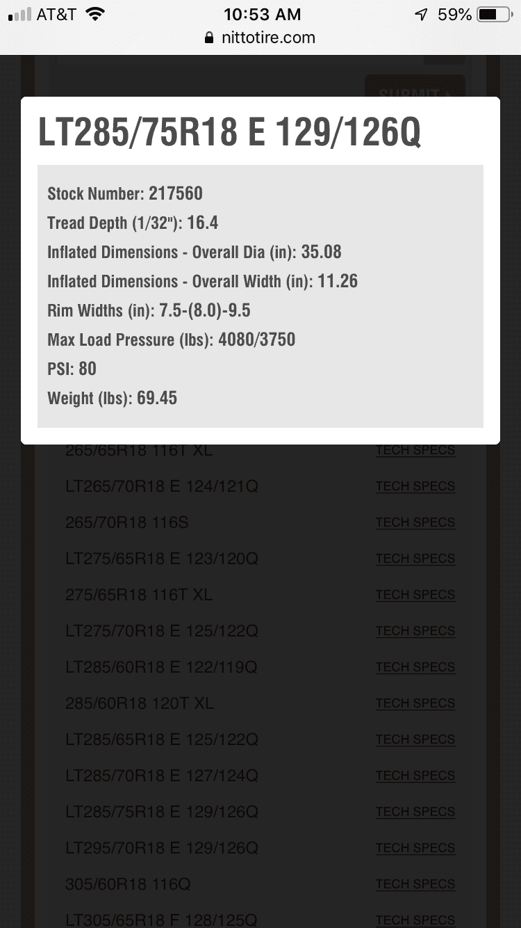

Looking for a tire expert to help with something I find a bit confusing. I have 285/70/18 Ridge Grapplers now and the only thing I’d change about them is a little more sidewall height. Fortunately they are available one size up at 285/75/18, but the specs show they’re actually narrower in the larger size. @gaijin any thoughts as to why this might be?
View attachment 1977903View attachment 1977904
Couple things.
Note that this is the "overall width" dimension. It doesn't speak to tread width, which is very likely within spitting distance between the "285" tires. Overall width is the widest point at the bulge of the sidewall. It may be that the profile of the tire is somewhat more square.
More likely however. Note the "rim width". The number in parenthesis, is the rim width that was used to measure the dimensions.
On the 285/70R18, it was measured on a 8.5" wheel.
On the 285/75R18, it was measured on a narrower 8.0" wheel.
That likely is what's accounting for the majority of the .24" width difference. Very possible with the same wheel, the 285/75R18 is actually a tad wider.

I like the ST Maxx a lot, but the only size I see that would get me the diameter I want is a touch too wide. I like the stock 18" wheels, and it looks like I'd have to go to a 12.5" width to get a 35" diameter which I think would cause rubbing. Tried a 35x12.50x17 on my 2014 with spacers, KDSS relocation, etc. and just ended up going to a narrower tire which solved all the problems. I like the fact it appears a 35" Nitto will only be around 11-11.5" wide, but reality may be different.

Good eye. I didn't even notice they posted the measurements on differing rim widths, so I think you are right the 75 spec tire should be the same width if not a little wider on the same rim.
