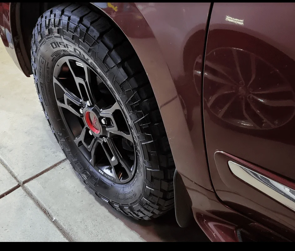

Speaking of aesthetics, my first modification was to swap the Tundra TRD Pro BBS wheels and 285/65/18 (32.56"x11.50") Cooper AT3s for the new Icon Vector 5 in titanium and go up to a 285/75/17 (33.86"x11.26") Nitto Ridge Grapplers.
I'm now the proud owner of the TRD Pro BBS Wheels and 285/65/18 Cooper AT3's, thanks again @mcgaskins, glad we were able to work out a deal. The Palladium Build looks great, very interesting reading
Looks awesome and love that color!
