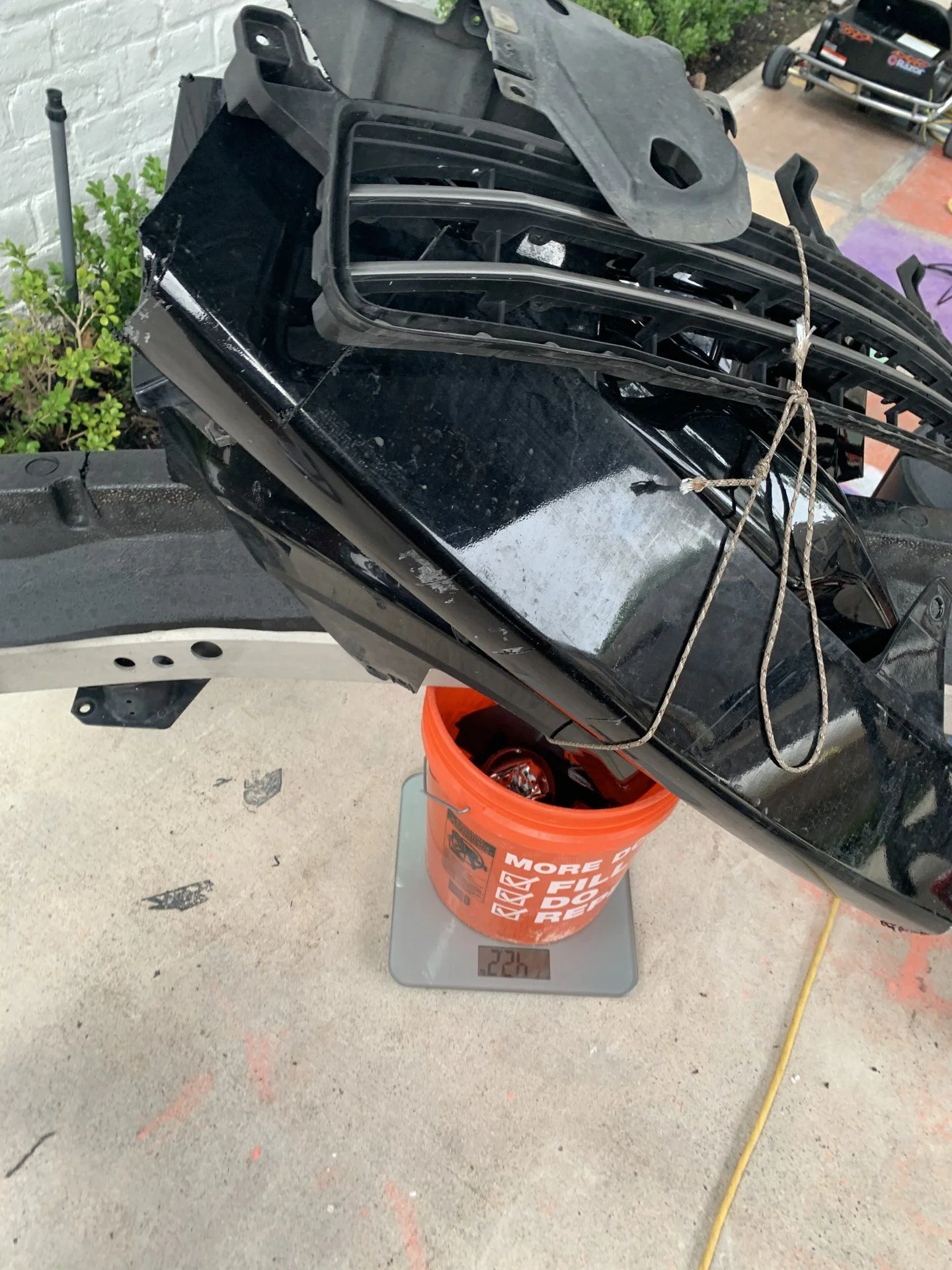

Any idea how much net weight this bumper adds after taking off the stock pieces?

Removing the stock bumper, the aluminum crash bar and related hardware is probably about 25-30 pounds

Thanks @radman I always try to be a bit conservative estimating what I've removed and liberal on what I've added, so that makes sense to me. It is an inexact science, but weight added to the very front of the vehicle affects handling dynamics so much it's worth paying attention to what you're going. Do you happen to know how much the Dissent front weighs? Your LX looks awesome, and I'm impressed with all your install work. What you did is honestly a lot more work than I would be willing to attempt with my limited skills and work space.
