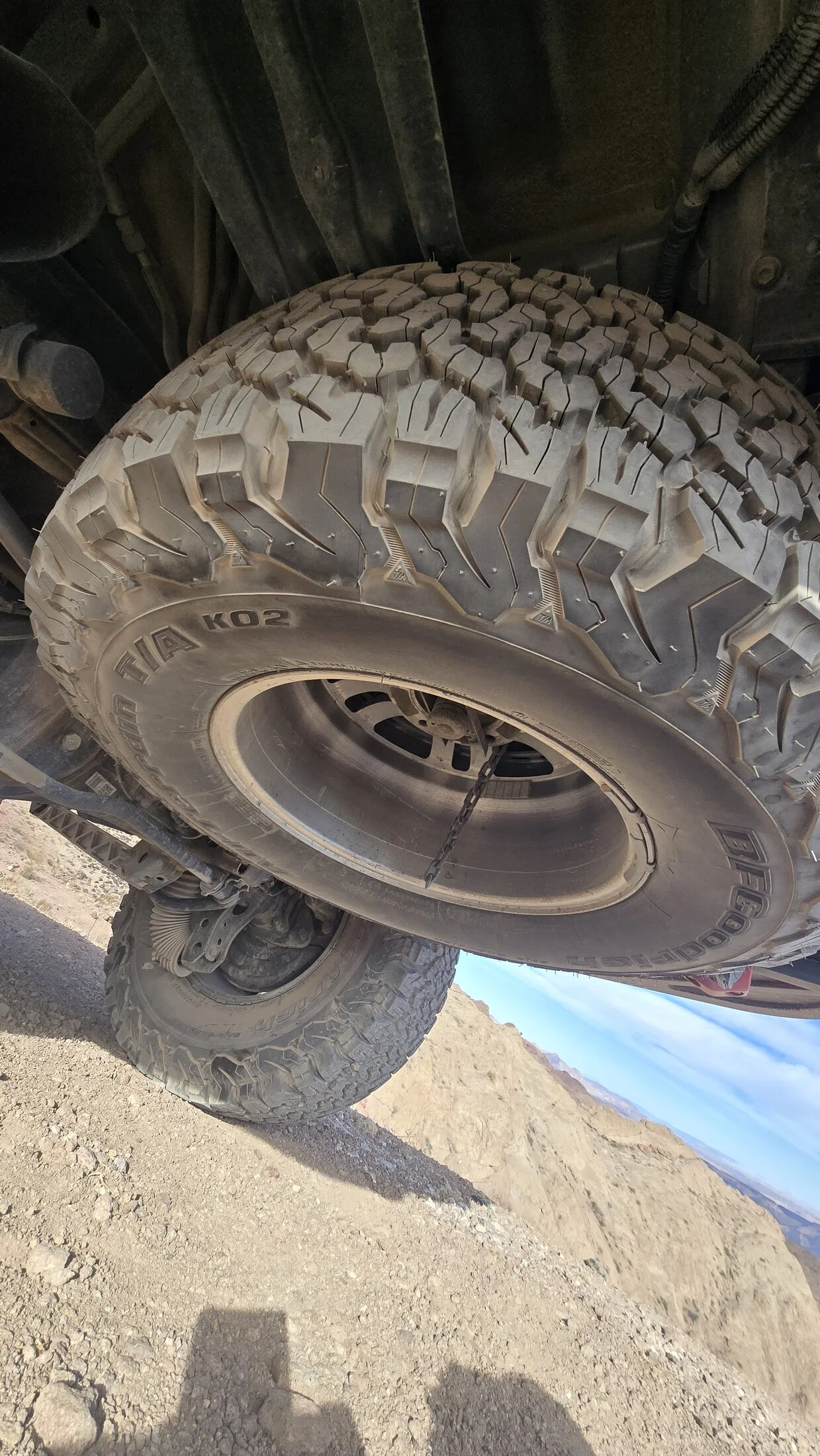

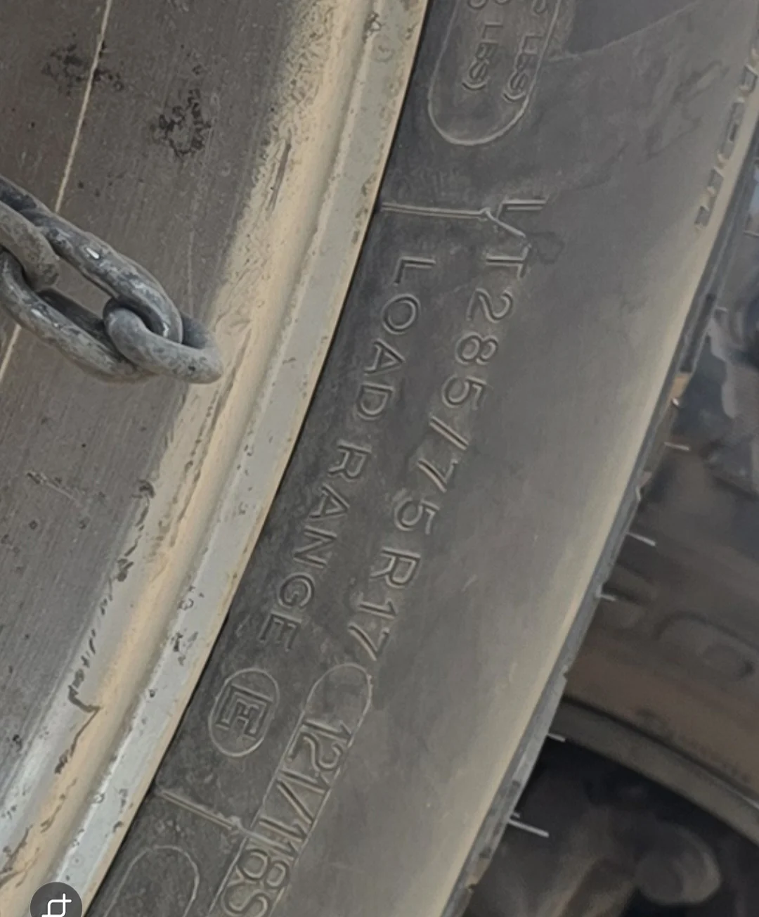

I have a question about the 285/75r17 fit - does it fit in the spare tire well under the truck?
Yes, it fits. One of the largest tires you can fit there.
