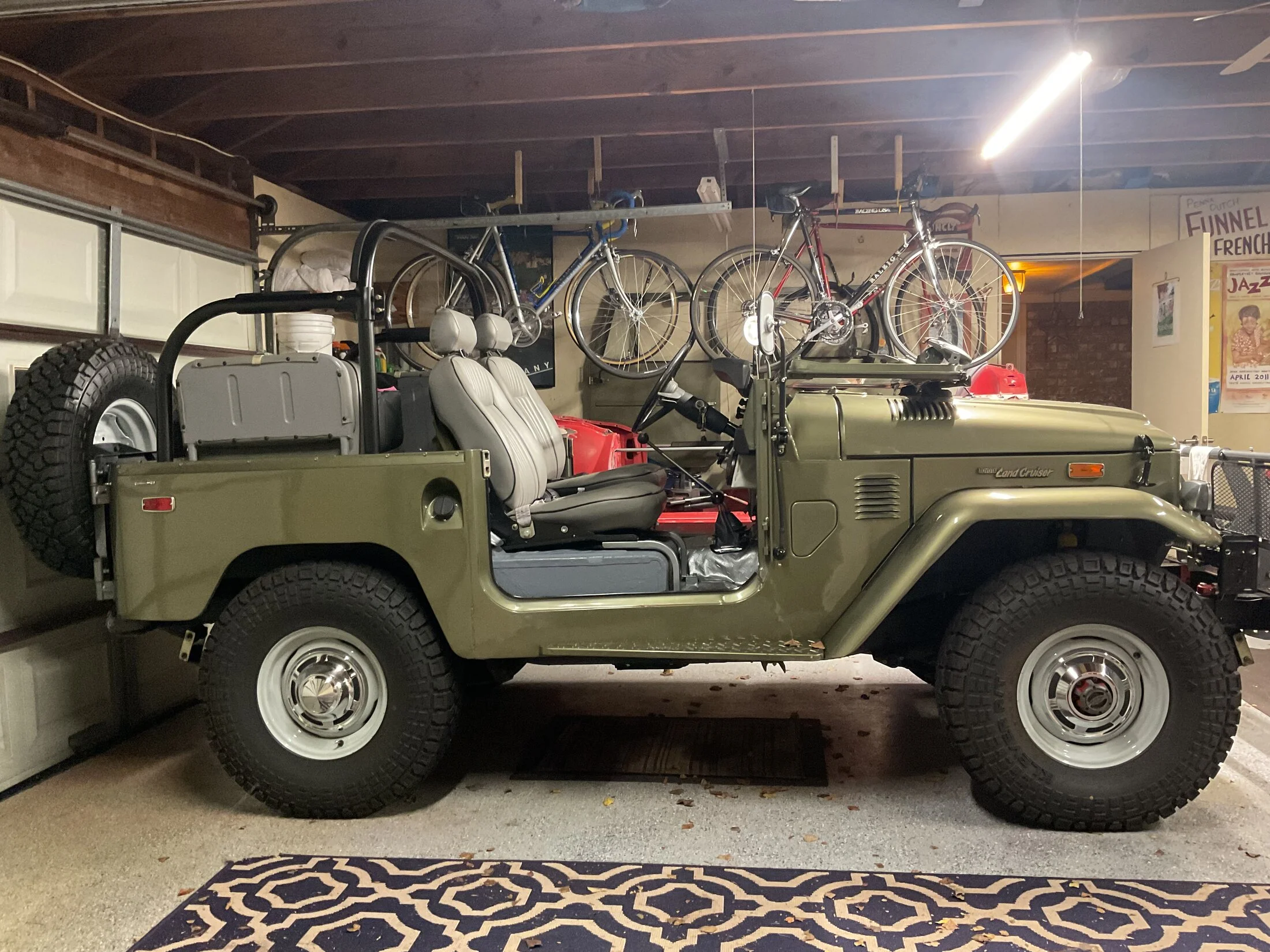

How wide are the rims that you have now? I have 33 x 9.5 Kenda Klever tires on factory wheels 5.5” wide with no lift, and no clearance problems. Wider rims might cause rubbing.
What color is that!? Reminds me of one of the olives but looks like it has some pearl to it. Looks sharp!!
The color is a factory General Motors color- 2004 Olive Metallic. Not pearl though. I picked it out of a catalog at MAACO in 2006. Base coat/clear coat.
